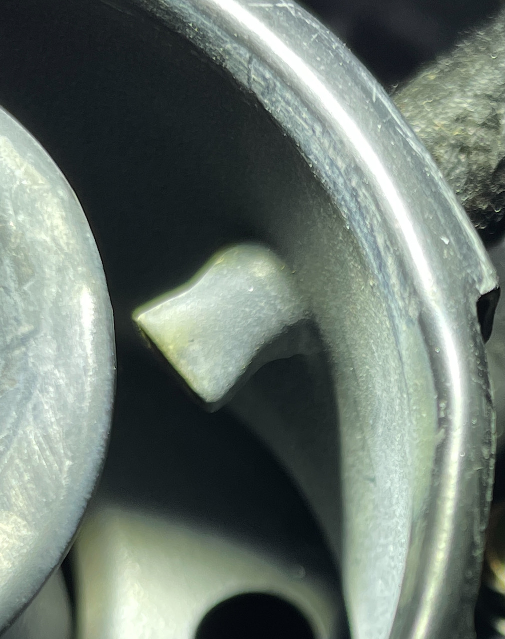

1. Got the old incorrect hose dyed and inserted through the grommet, so it looks ok. But…
2. Looking under the gas cap, the line is crimped, see pic, so no vapor flow (tried…).
Question: is this normal? Part of a recall notice done ages ago by dealer or by a mechanic somewhere along the time path? I’m sure I didn’t do it.

I wonder then if it’s crimped then should the hose be connected to the nipple on the expansion tank? Could it create a vacuum as the gas is used, leading to a very bad gas tank inversion? Maybe leave the hose off that nipple to prevent vacuum in the tank? (IMG:style_emoticons/default/confused24.gif)

QUOTE(76-914 @ Jul 17 2026, 09:46 AM) *
Probably just to keep a large amount of gas from entering the system if overfilled or when sloshed from spirited driving. (IMG:style_emoticons/default/confused24.gif)
But if crimped closed it can’t serve any function. Weird…..

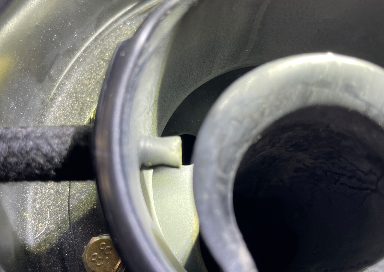

I happened to be in the garage working on my car so I snapped a couple pictures of that pipe in the filler neck. Mine looks unmolested and is kind of flattened down too. (IMG:style_emoticons/default/beerchug.gif)

QUOTE(Cairo94507 @ Jul 18 2026, 02:55 PM) *
Thanks! Hose nice and tight, too.

Checked mine (‘73 2.0) and it looks crimped as well. Did not do a blow test yet tho.
post Jul 18 2026, 08:25 PM
Posts: 5,656
yeah mine's crimped.
its not there for fluid to pass through.
its for air mixed with vapors. fuel expands with heat.
and - as you also note its to provide pressure equalisation as the tank draws down,
air is drawn in via the charcoal can route, through the expansion tank and through that little crimped tube.
probably a good thing you cleaned it. sounded like it was clogged.
