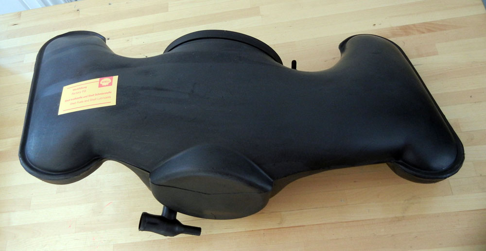

Anybody know where I can lay hands on an air filter box for the 914-6?
I see it has a PN 91110800102 - is it identical to the 911 air filter?
Thanks to all.

QUOTE(altitude411 @ Apr 12 2019, 10:05 PM) *
early 911 and the six are plastic but the snorkels are different and the oil breather (plastic on the six) points to the oil tank. Hard to find a six that is not melted/compromised. Carb fires... (IMG:style_emoticons/default/huh.gif)
The one pictured is not for a 914 6......might be for a 911 with mechanical
injection.
The Shell sticker is not faced correctly for a 911 or a 914 6
A correct unit was listed on Ebay recently, $500. with some carb fire damage.

The actual plastic boxes are identical. There are a variety of vent fittings and I can not claim to know exactly what is correct for each application, but I am pretty certain the 914 vent was a yellow plated metal one. The one pictured above is the black plastic vent fitting.
As stated above the correct snorkel is unique to the six. It points to the passenger side and has no other fittings or attachments.
There is a 911 version that points to the same side (I think it came on an E version) but it has a “Y” fitting pointing down near the end. I suspect that the Y could be removed and look very much like a six snorkel. I only mention that because the 911 one is much easier to find than the six one.
Good luck hunting.

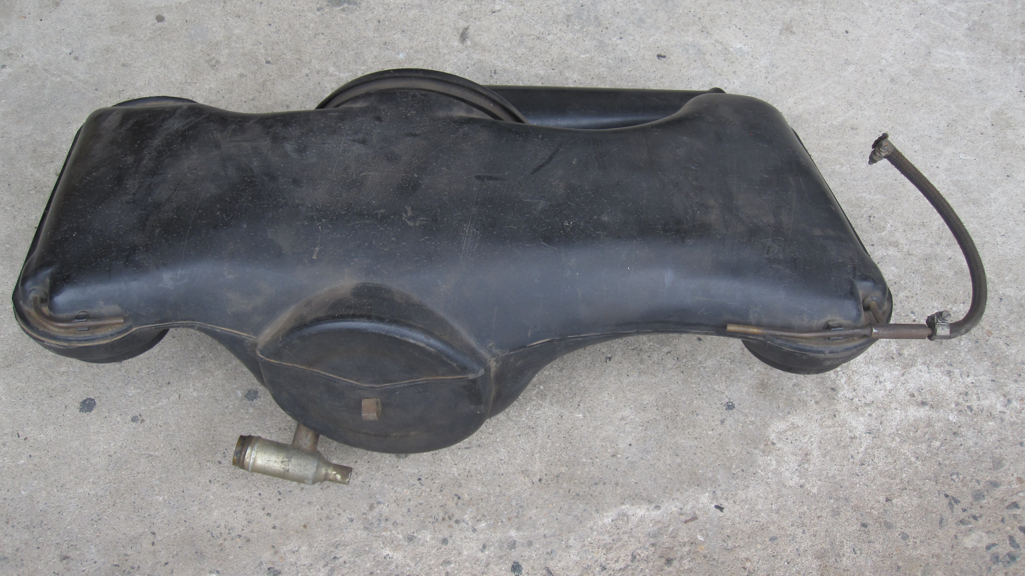

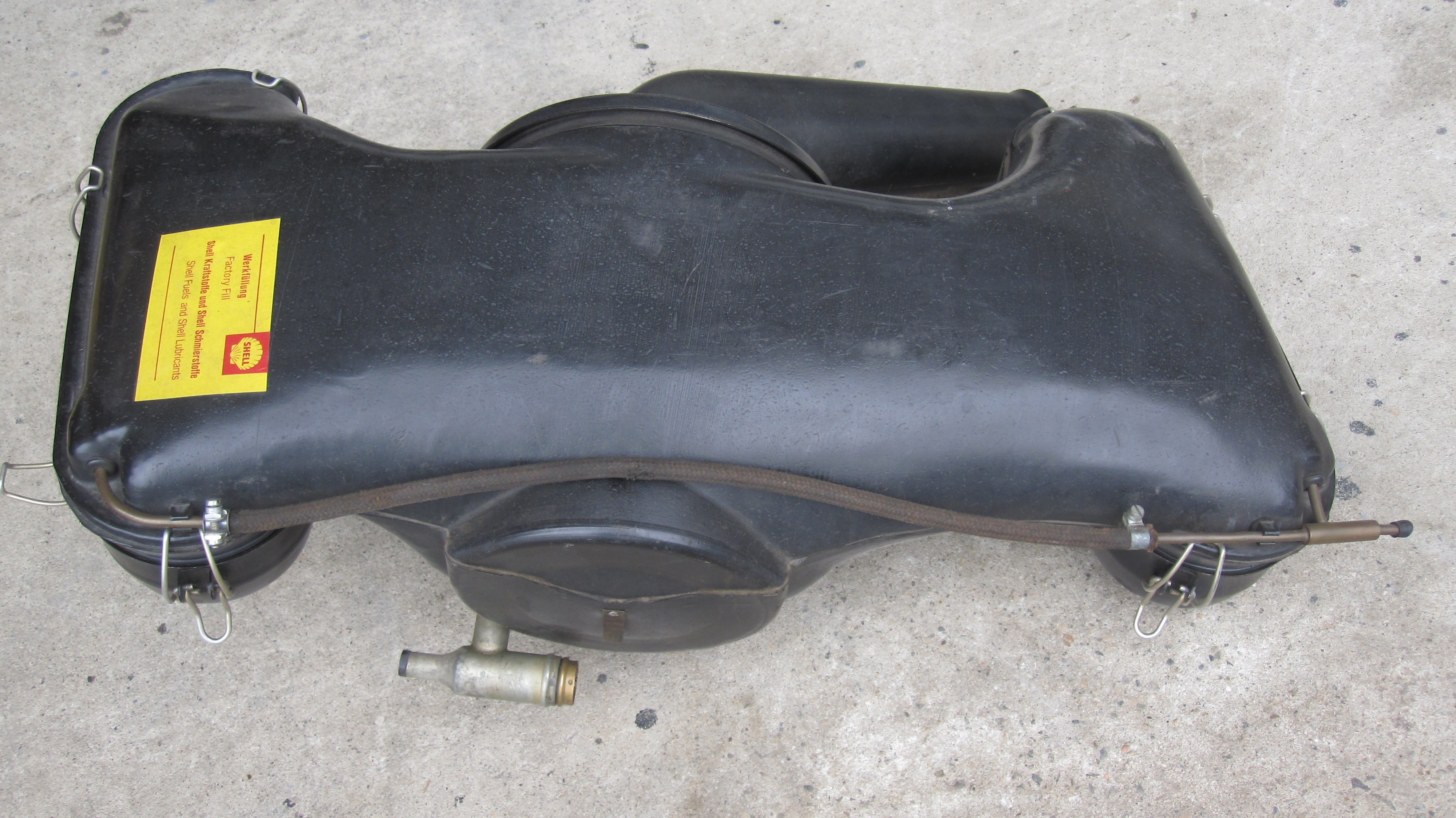

Two original pieces.
There are different plastic housings among 911s.
Not sure about the Shell sticker, might have been added, might be a European
version.
AFAIK the enrichment squirters were on all sixes. No chokes !
How original do you want your car ?
Happy Hunting

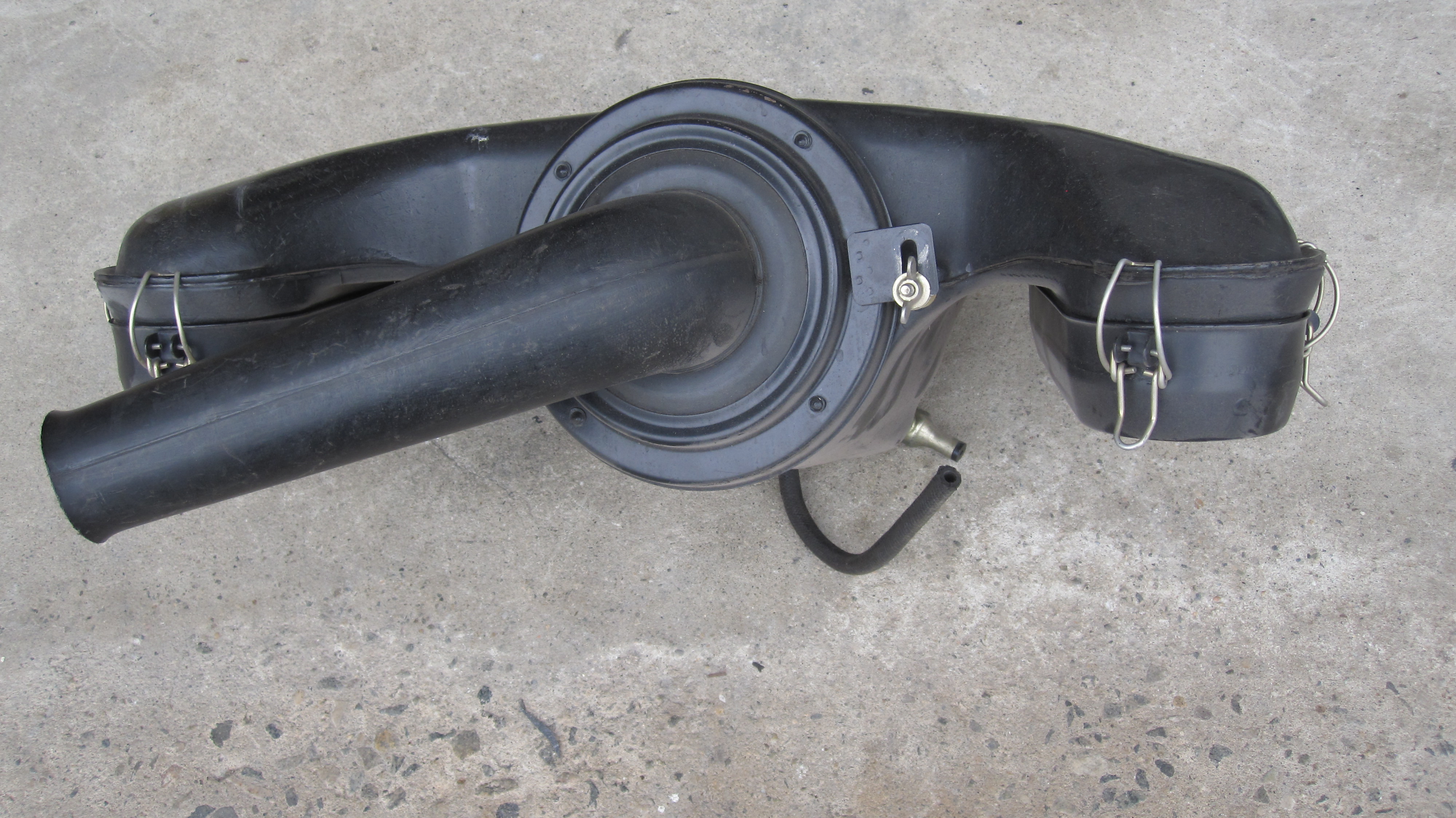

rgalla9146
post Apr 13 2019, 08:36 AM
Posts: 5,019
Joined: 23-November 05
From: Paramus NJ
Member No.: 5,176
other
