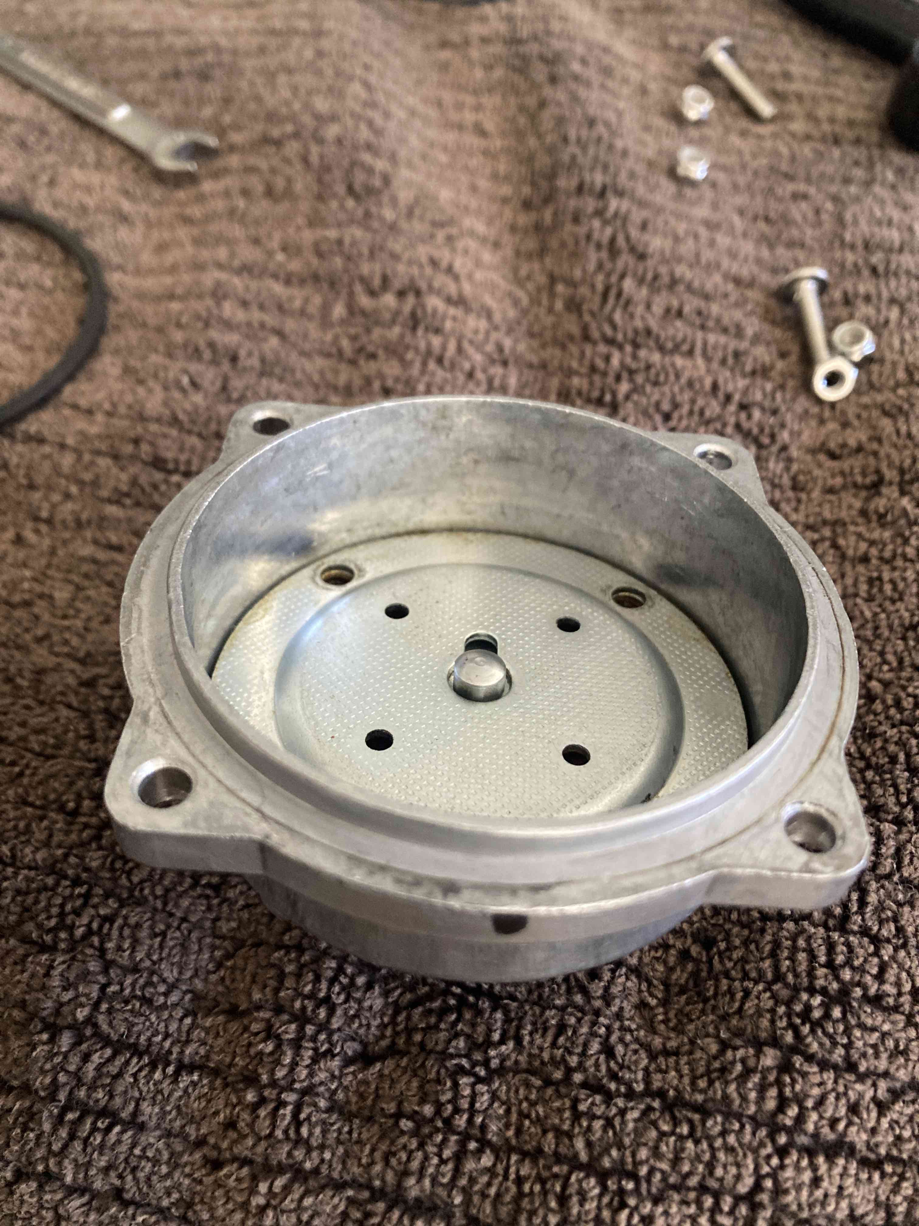

First when I opened up the unit I found the most difficult job was removing the rivets holding the two halves together.

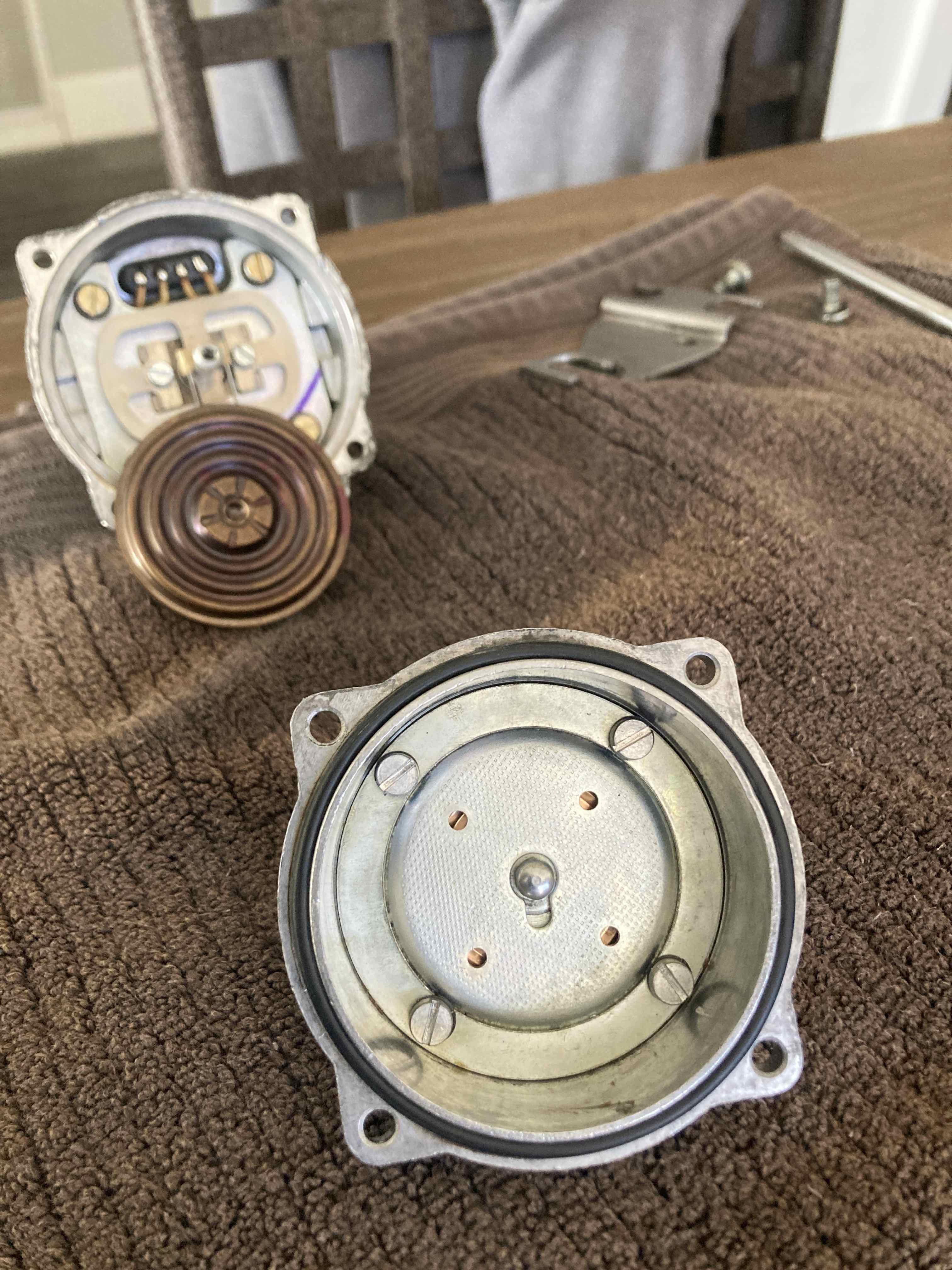

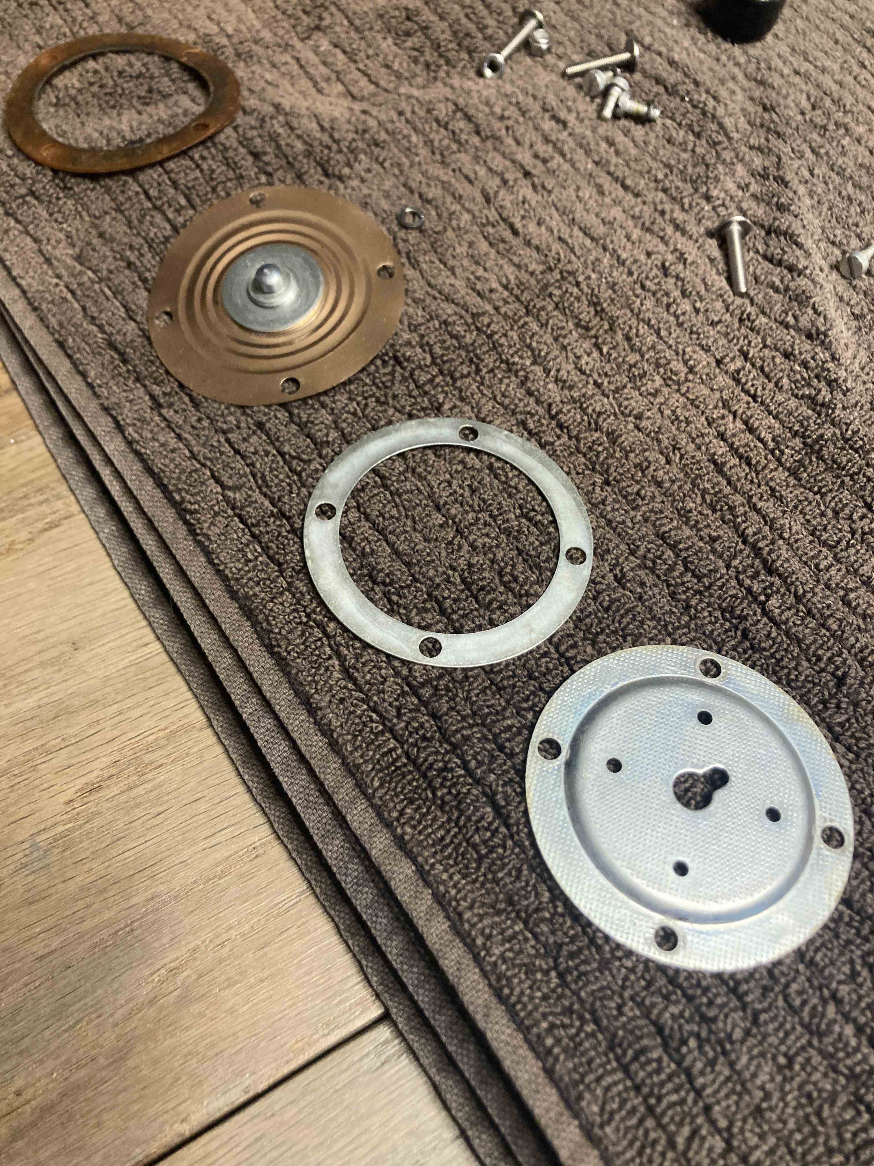

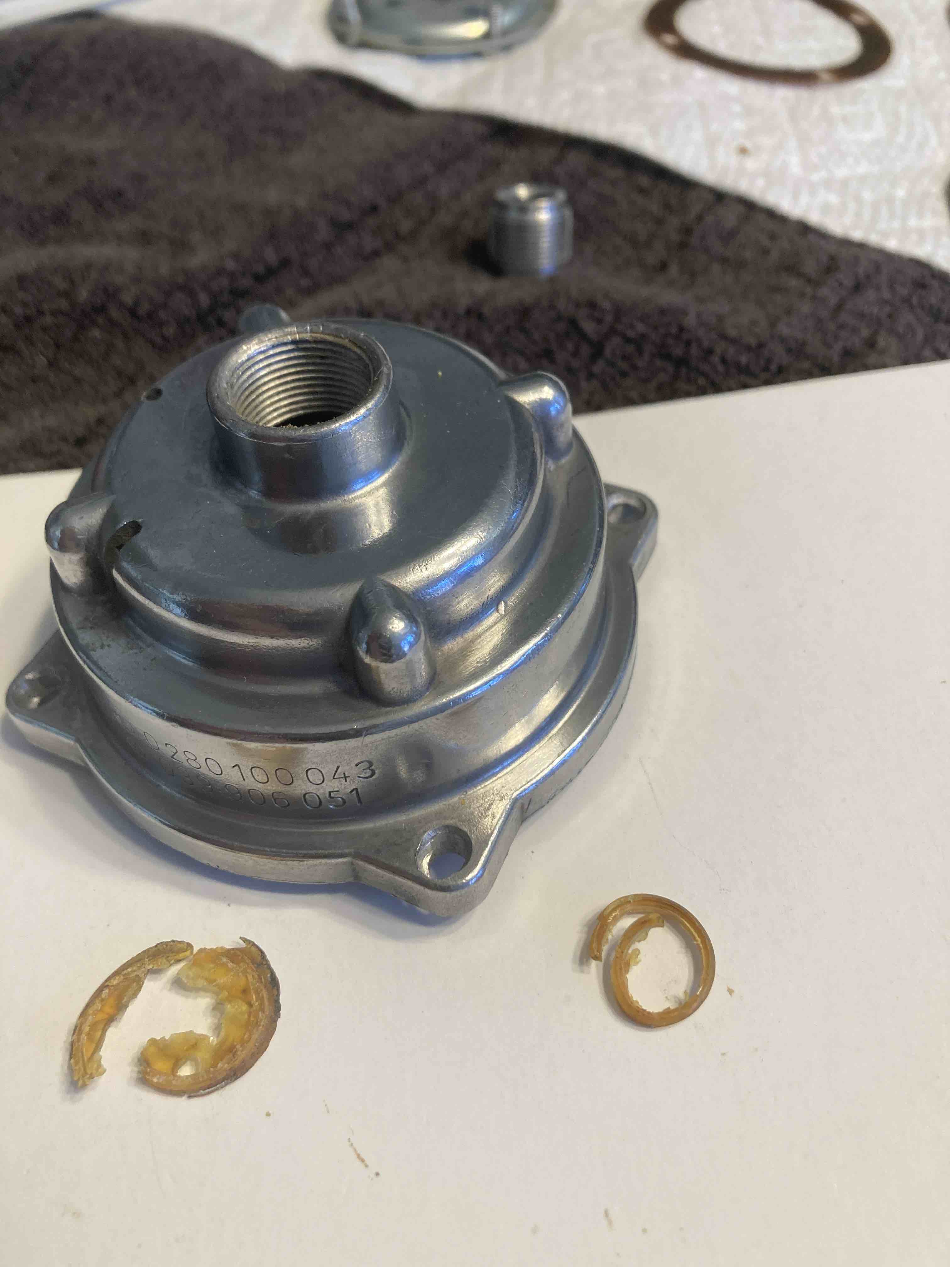

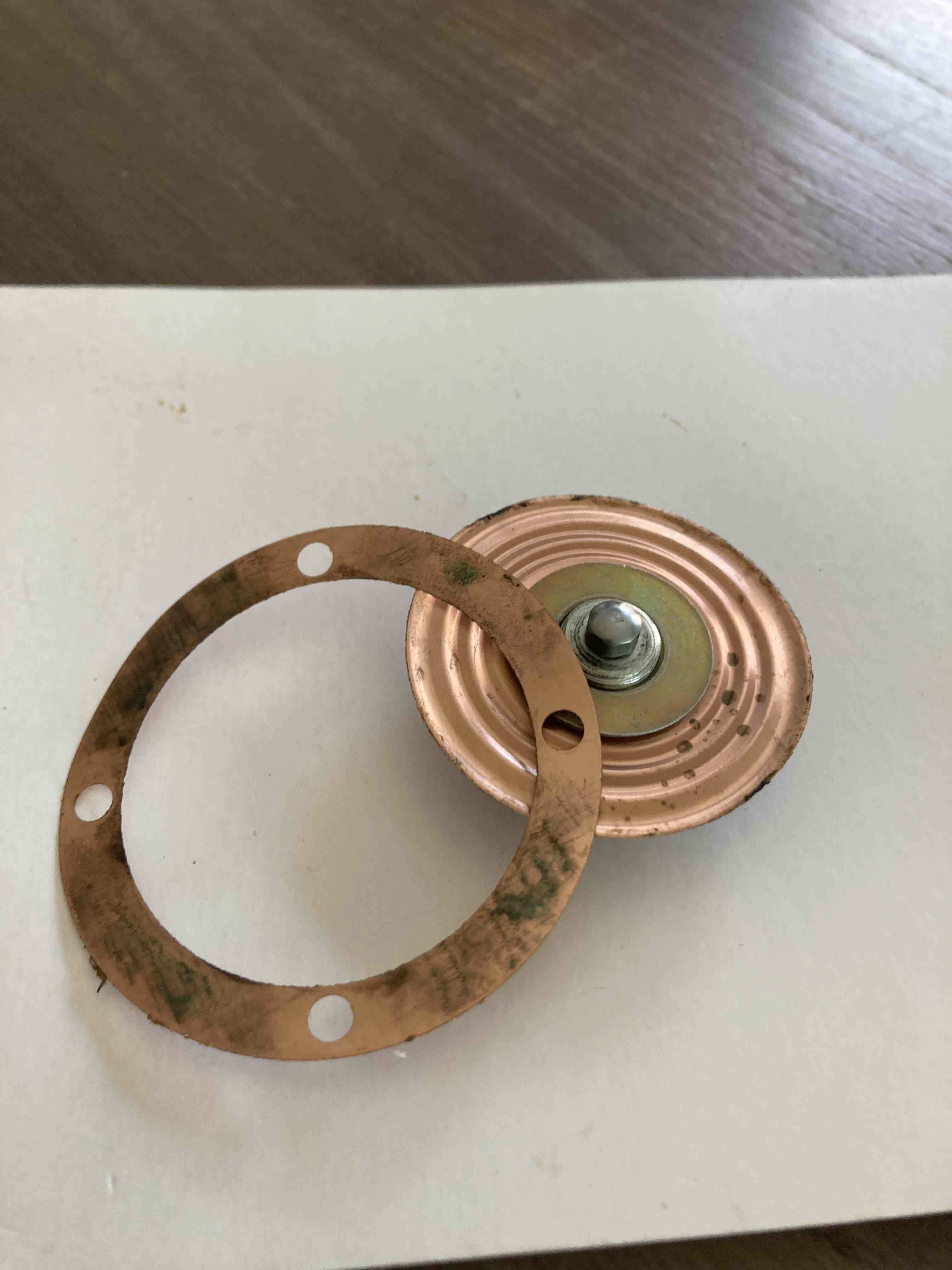

When I removed the retainer plate to take out the old diaphragm it was in two pieces .
Click to view attachment

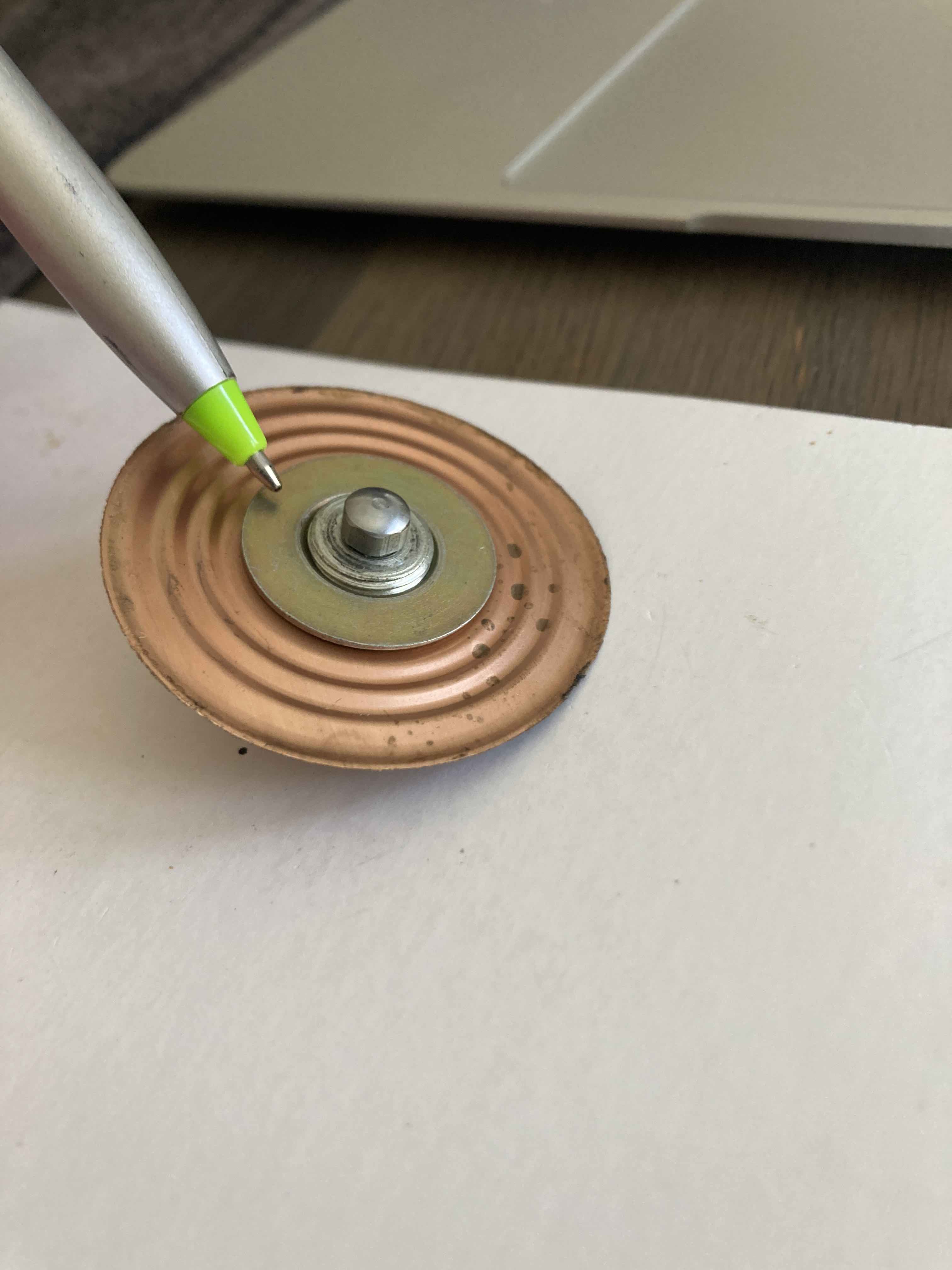

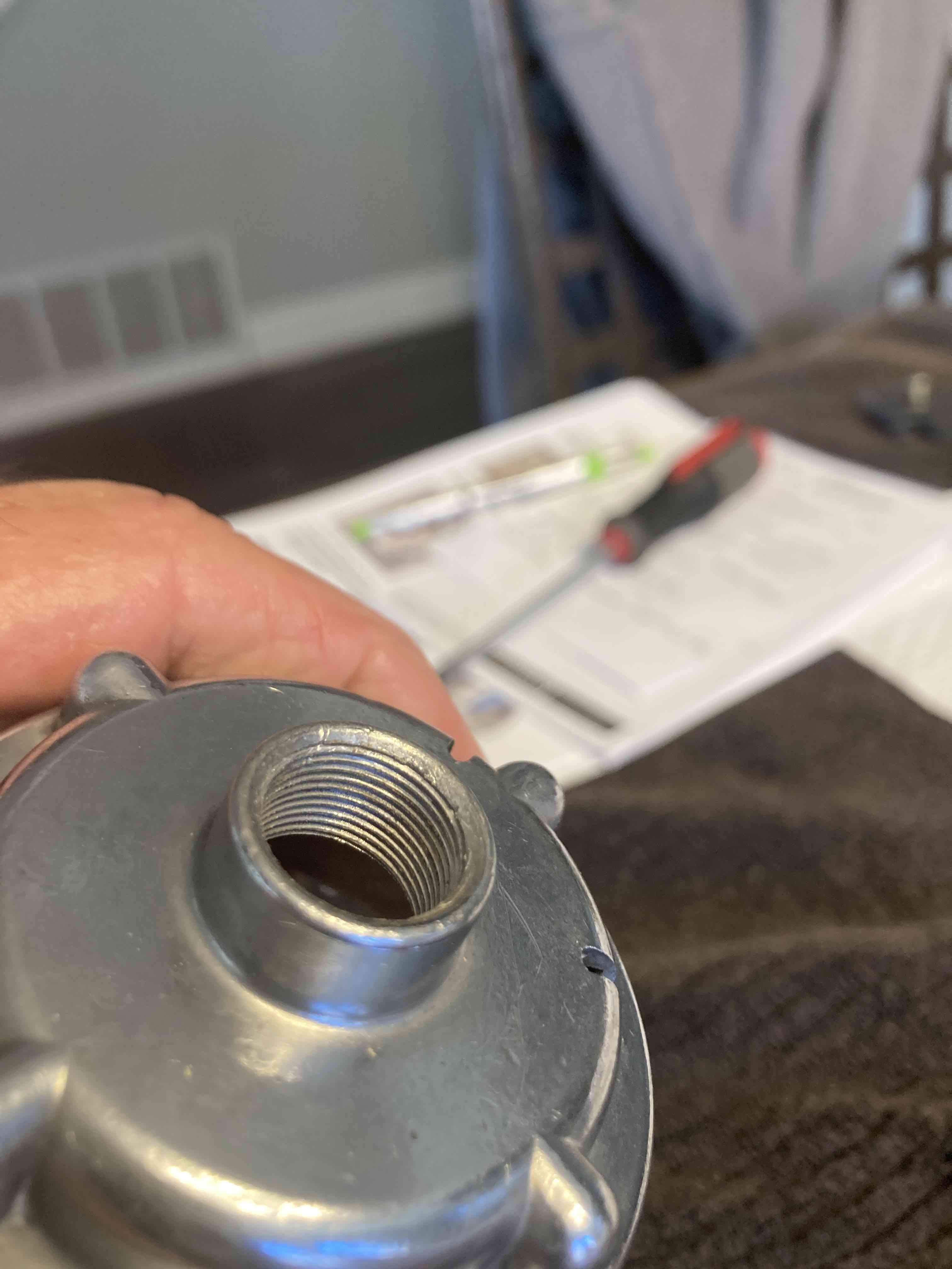

I needed to take two measurements since I was replacing the stop screw , I needed to measure the the stop screw protrusion into the housing . The instruction sheet sent to me by a member had the measurements he must have made when rebuilding his MPS . His stop screw protrusion was 1.97mm and mine only measured 1.72mm.
His inner/outer screw assembly depth in the old diaphragm measured 6.51mm .
Here's one of my questions ?
when I measured mine I got two measurements depth to inner/outer screw assembly was 4.03
and depth to the washer outside the inner/outer screw assembly was 5.46mm.
Again there is a difference and since mine was never accessed before (epoxy over screw was not disturbed) is the difference in measurements ok and which measurement should I use I will try to attach a photo or two to help with my question.
this one .

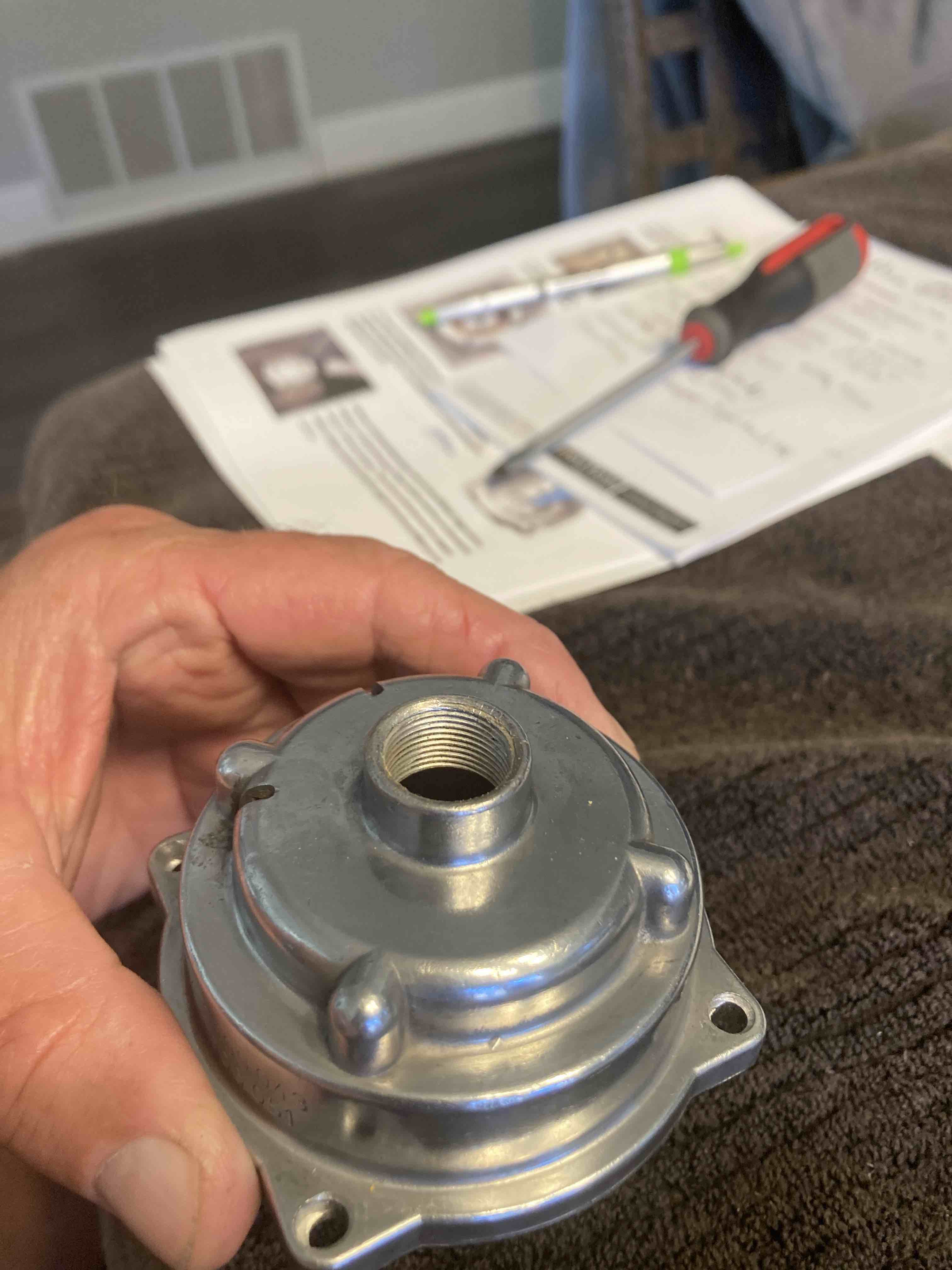

I have not touched either of these measurements yet and awaiting any help/comments.

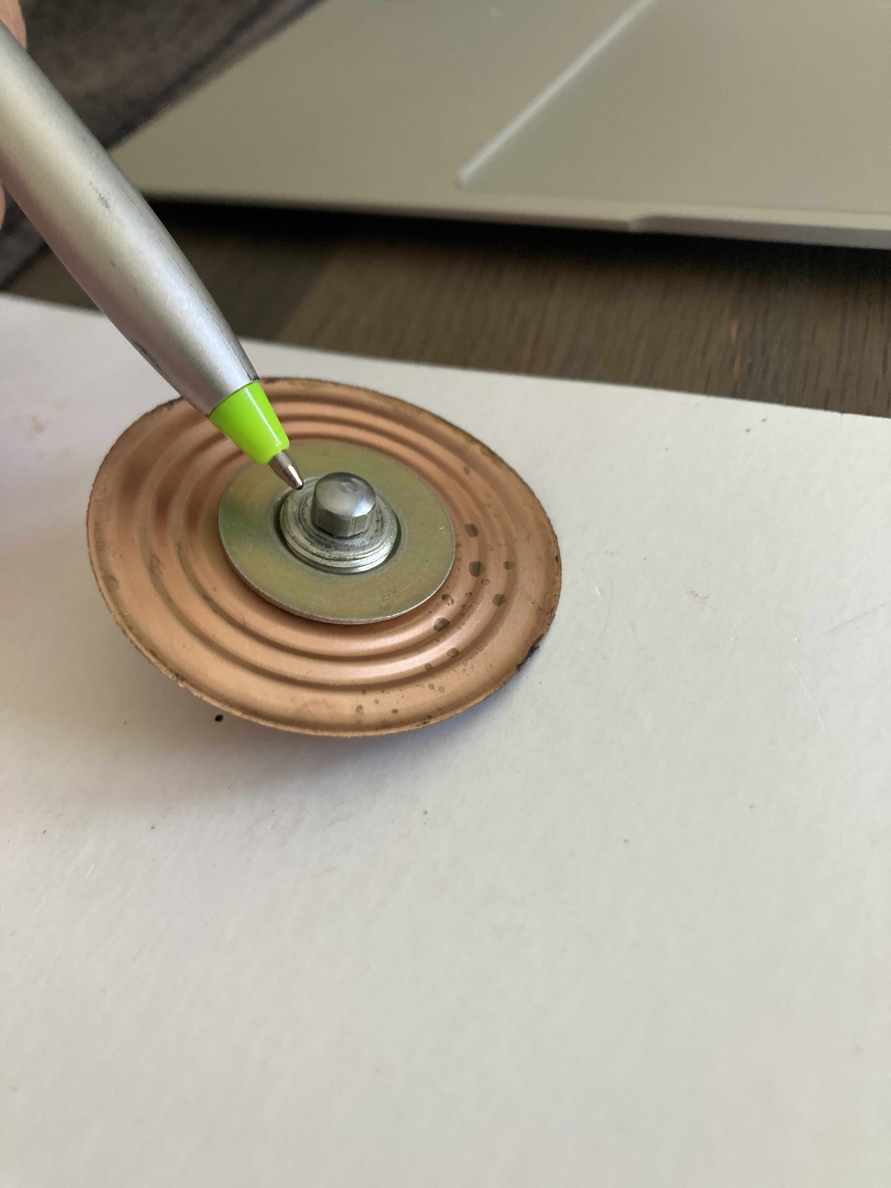

I think it's this one to the washer on diaphragm .
There you have it, now you know why it was a leaker. Good job! smilie_pokal.gif The last unit I did had a diaphragm do exactly the same thing upon disassembly.
The measurements are just to get you close . . . In the ballpark . . . Instead of being way out just randomly assembling. It will ultimately still need tuning which is why you have the tuning tools too.
Pay attention to reassembly directions - gasket placement matters. Chris’ instructions will get you there.

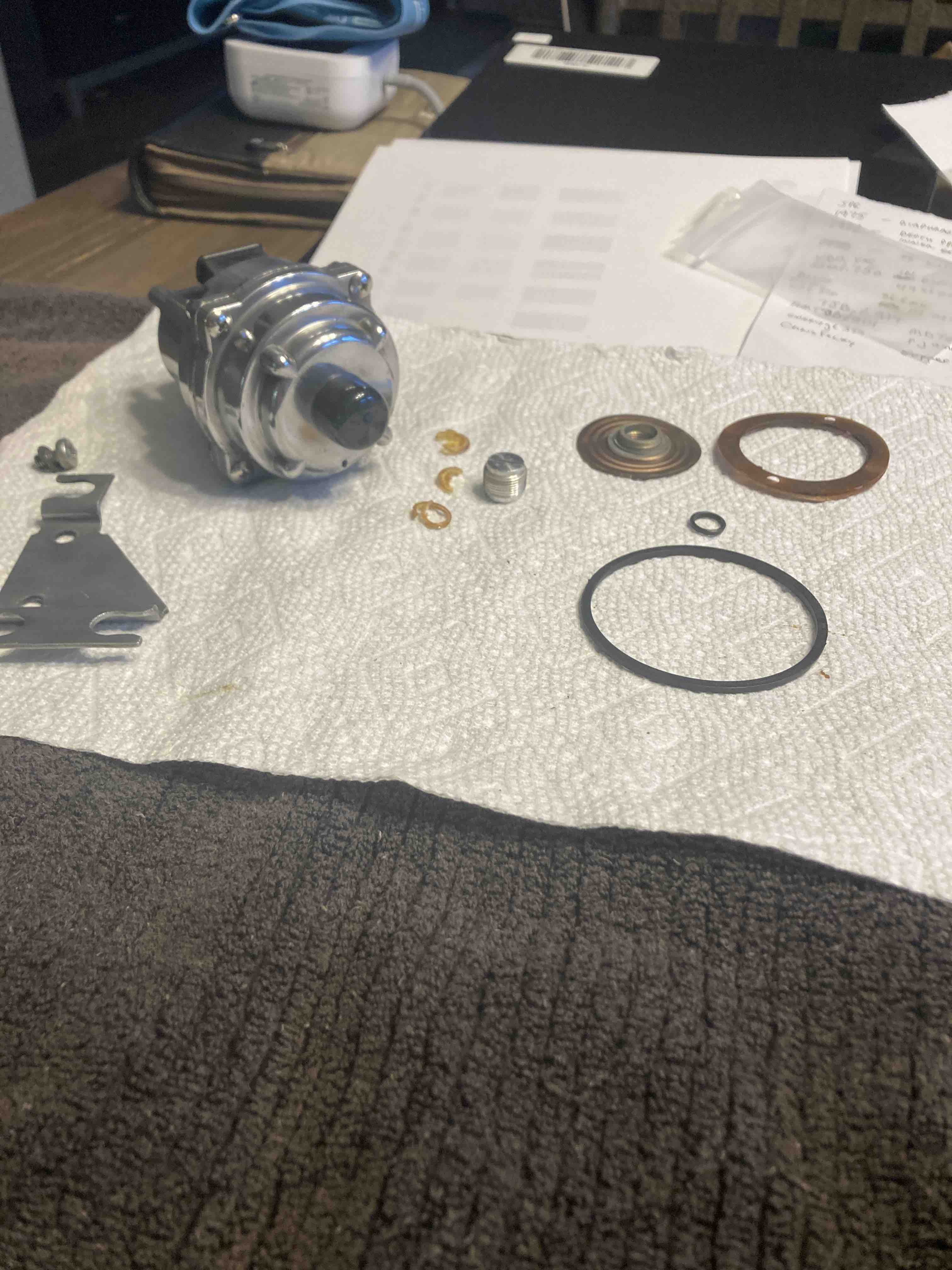

Well all done . I must say it was easier than I thought I was just making a bigger deal of it since this rebuild was my first . I actually found by using a heat gun to soften the epoxy it came out very easy . Even the threads cleaned up nicely with a little heat and a pick , no need for a tap to chase the threads came out nice and clean the screw removed easily . Here's a few more photos . Now for the fun part ,tuning my car to run better for my 2056 motor . More things to learn for me

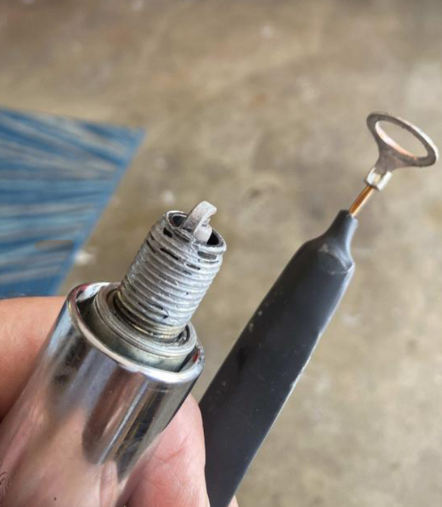

This is another change you’re completely neglecting.

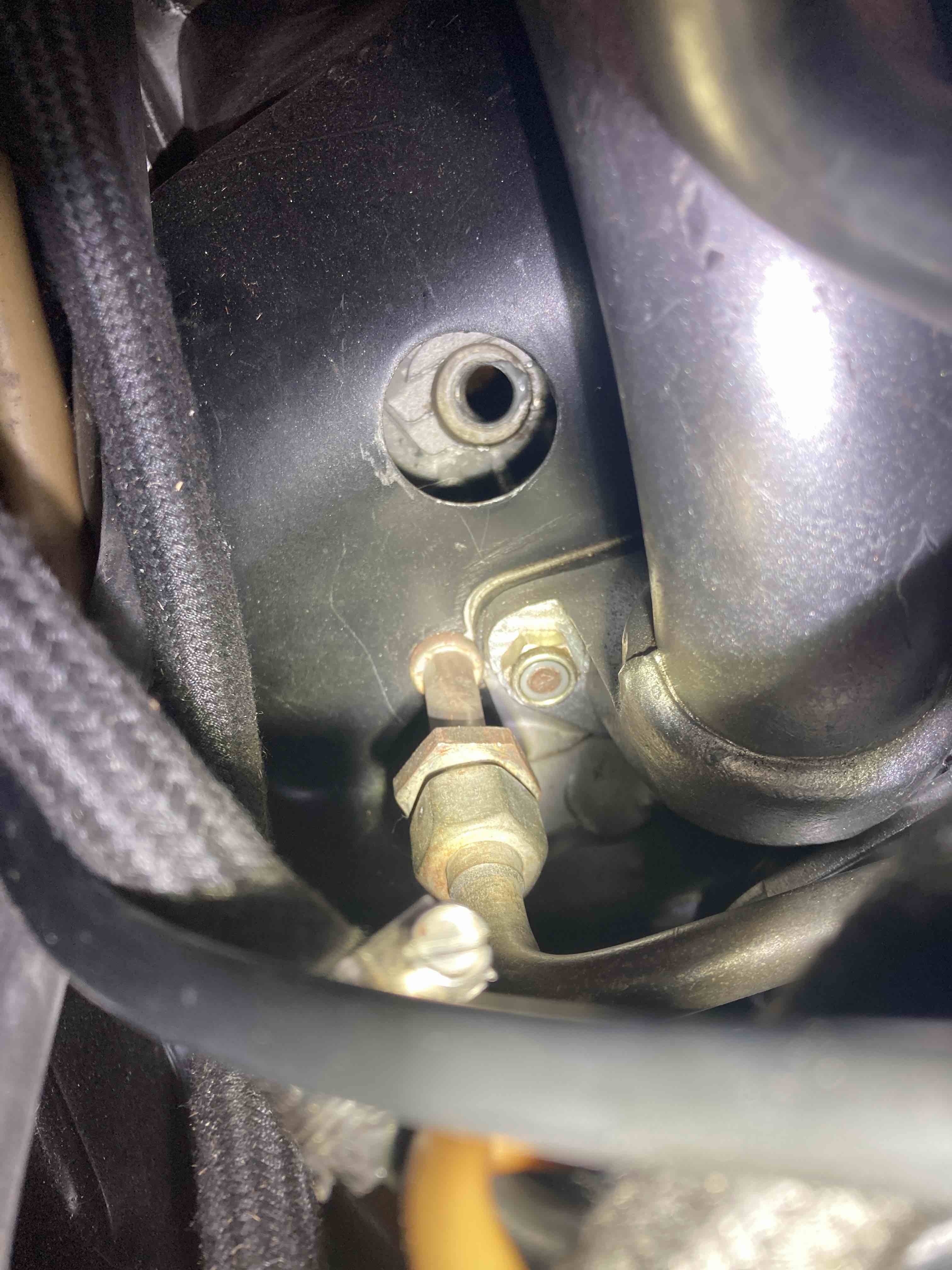

Generally speaking - you’ll find NGK and other spark plug makers recommend against anti-seize. This is because the plug needs a good ground path to the head to spark.
Anti-seize also modifies the torque spec - so the spec they give you is for no anti-seize. Torquing to their spec with lube can lead to stripping threads.
Now for reality. I use copper based anti-seize but very sparingly (not like this photo). You should get a good enough ground from contact between the plug shoulder and the head. But - - you’ve also added the CHT sender in the mix and ground path. If the CHT sender isn’t allowing a solid connection between the plug and head - ground path could be compromised.
I’m not posting this to shame you but rather to get you thinking about how many changes were introduced since it ran last and that things as simple as too much goop and/or a improperly seated CHT sensor could be causing your misfire / engine rocking that you initially described.
Note: if you don’t have a slot cut into the head to allow that CHT to seat properly, it often takes some creative bending to get that CHT down into the spark plug pocket correctly.

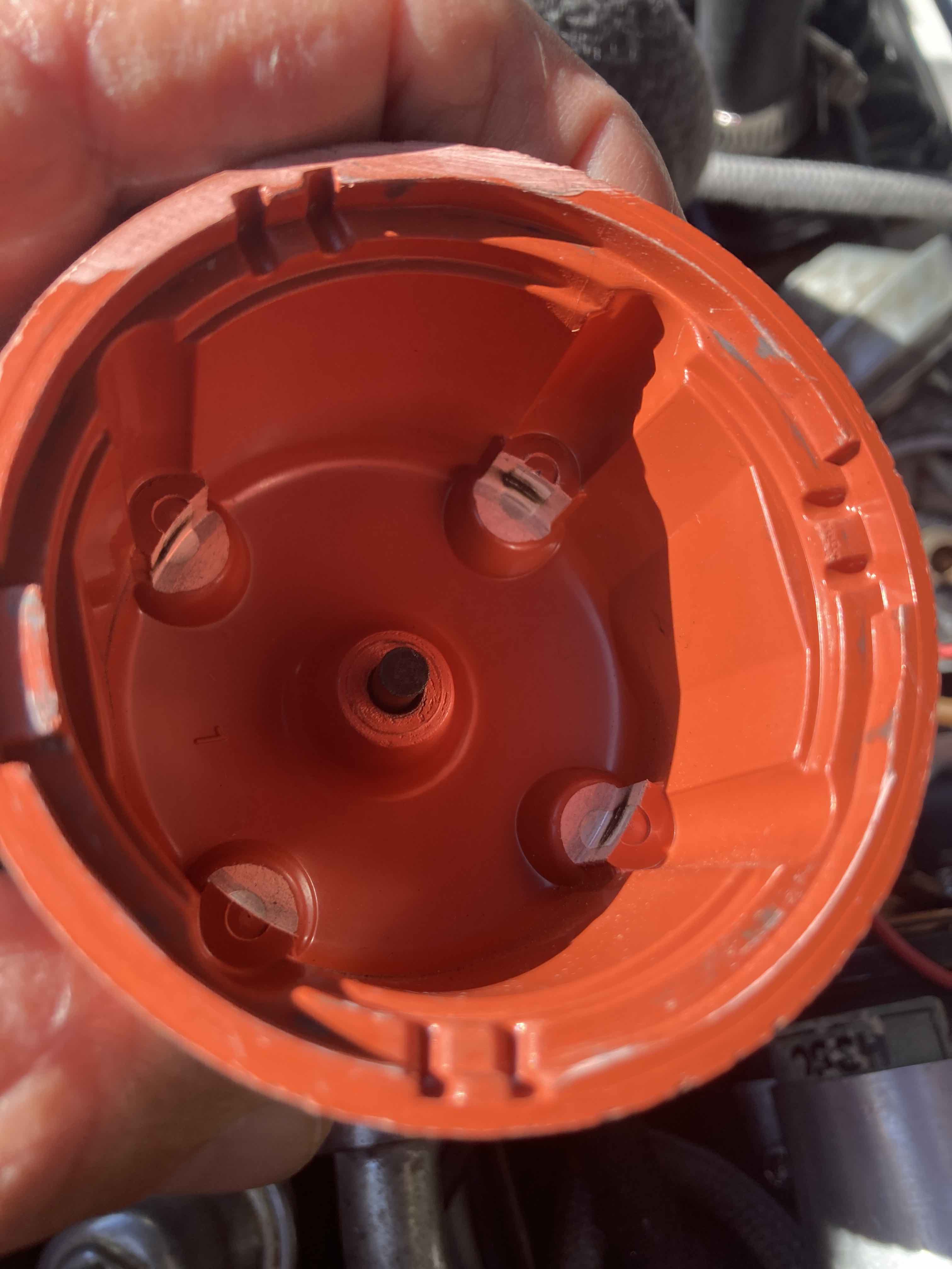

1) Spark - I checked all plug wire connections and then (not sure if this was correct) used the timing light on each plug 1-4 and checked for a pulse ( Had a pulse on all four).

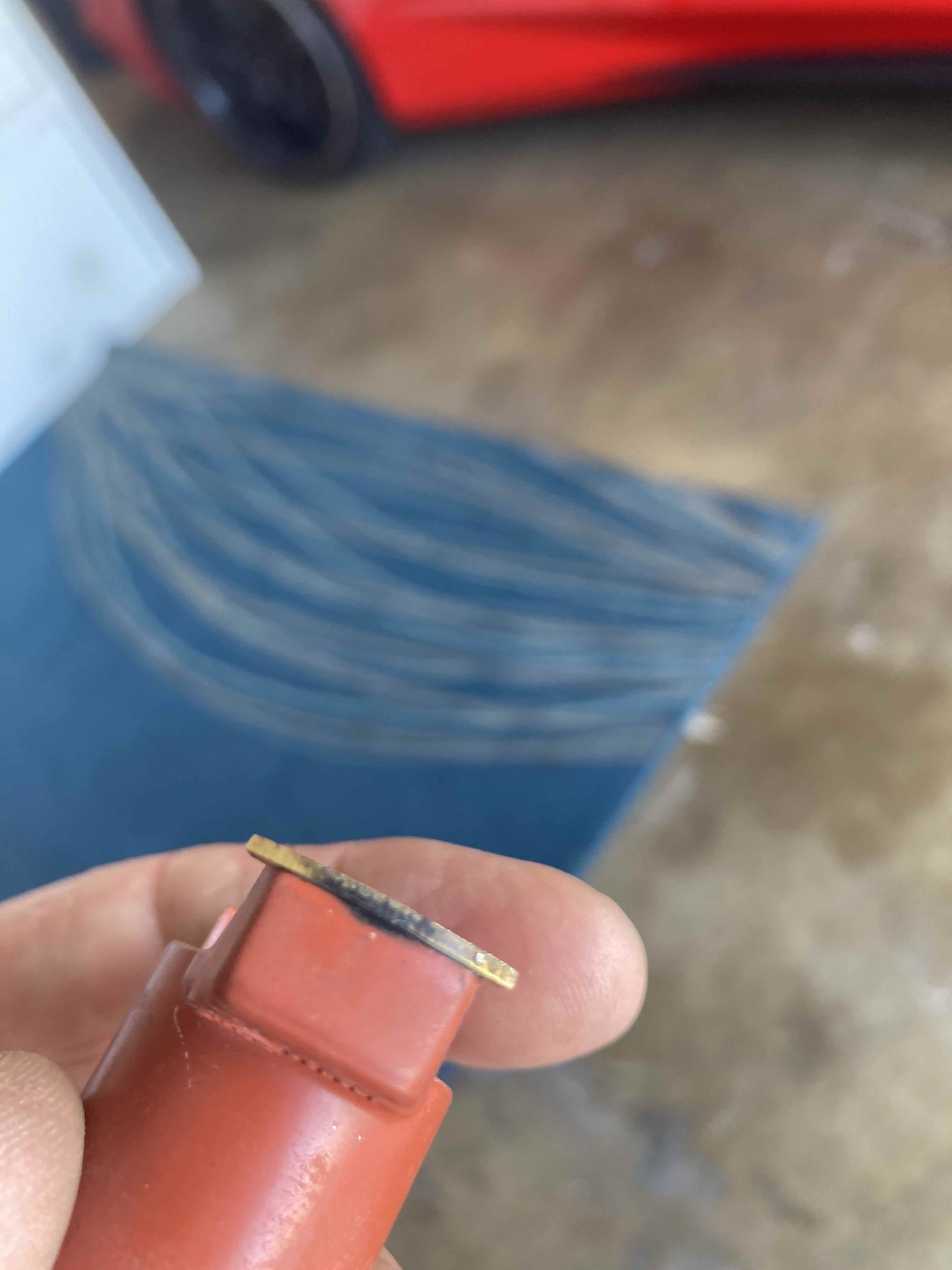

Pulled cap/rotor ( it was not disturbed ) and checked ,that's when I noticed the black arcing marks on the four plug connections and on the rotor I cleaned the contact points and reinstalled the cap/rotor but I still had rough/shaky idling.
Here's where I squirreled and decided to change the Pertronix unit for points/condenser (new point and condenser set gap to .016), this made no difference.

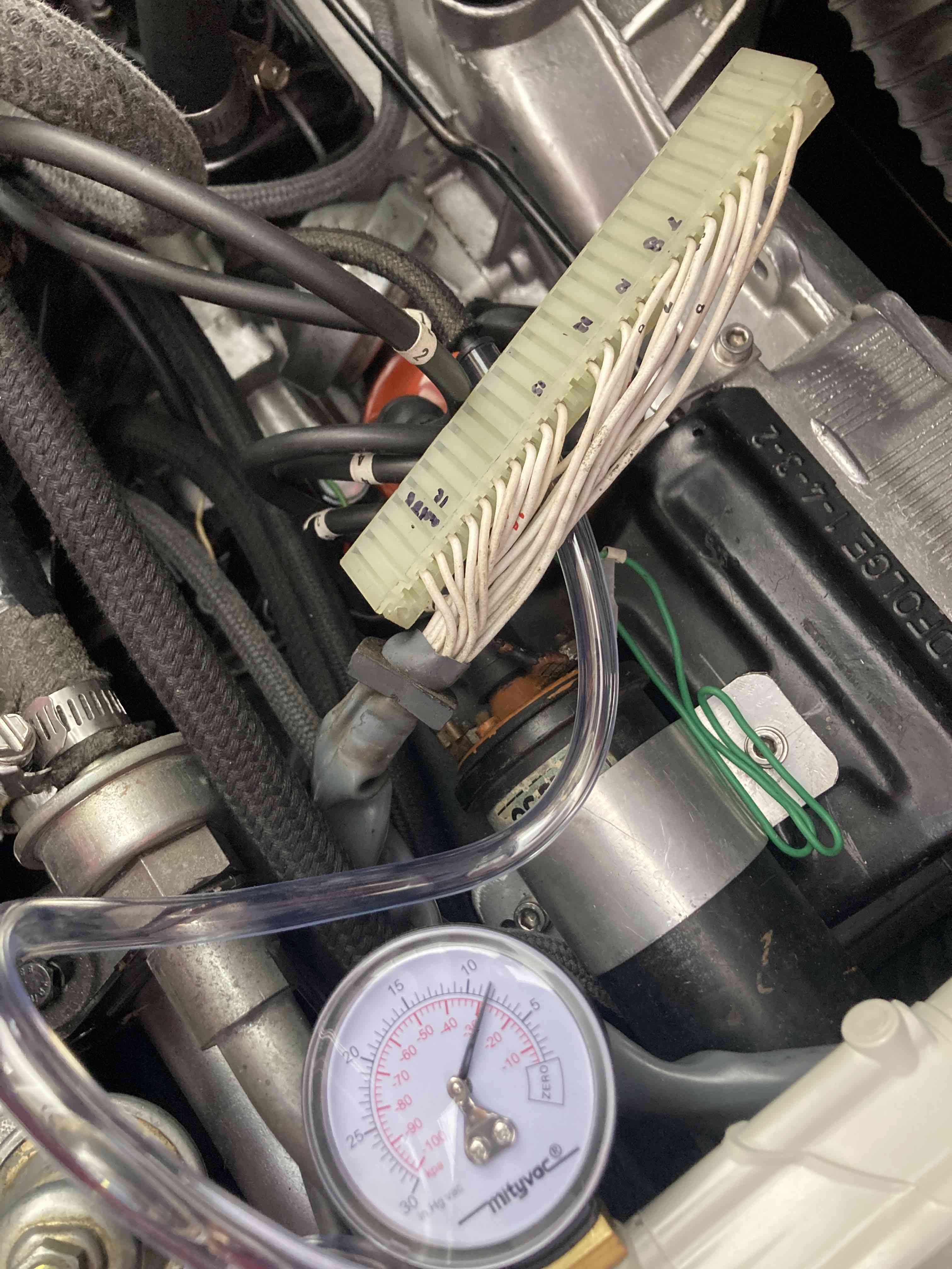

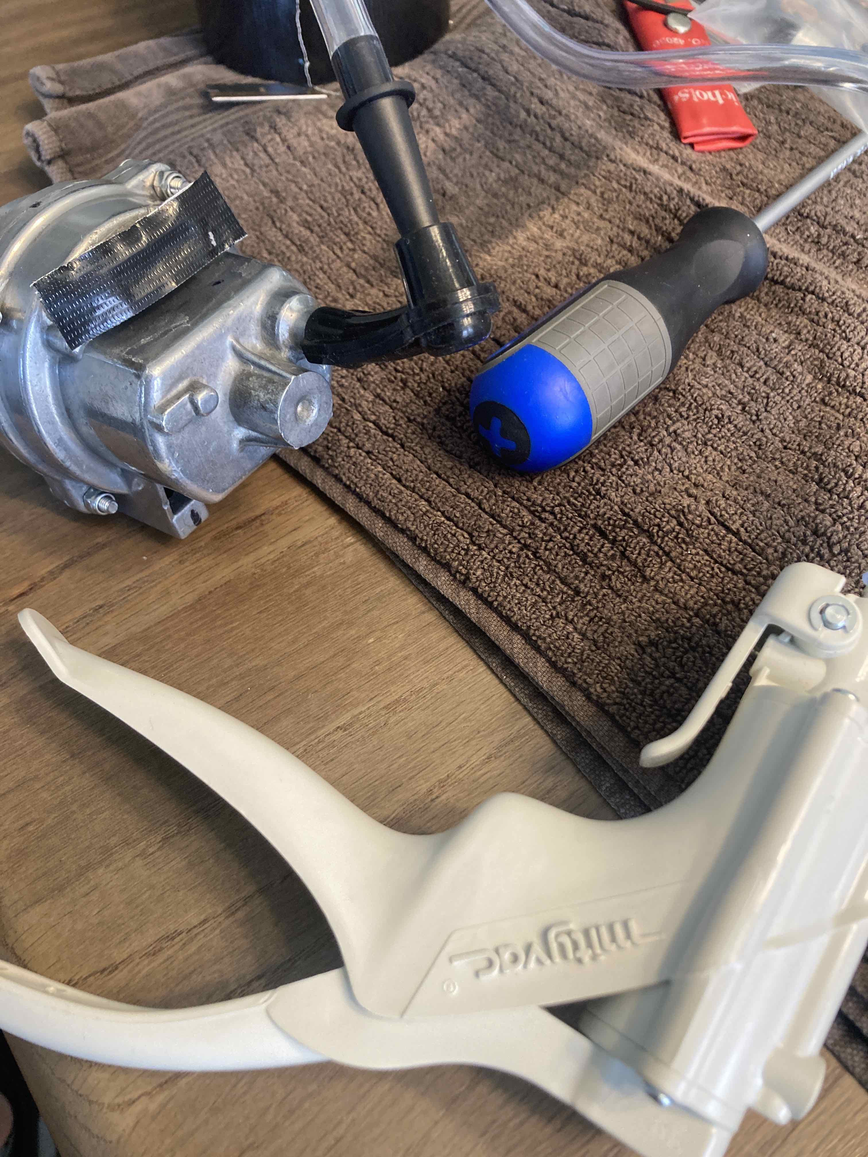

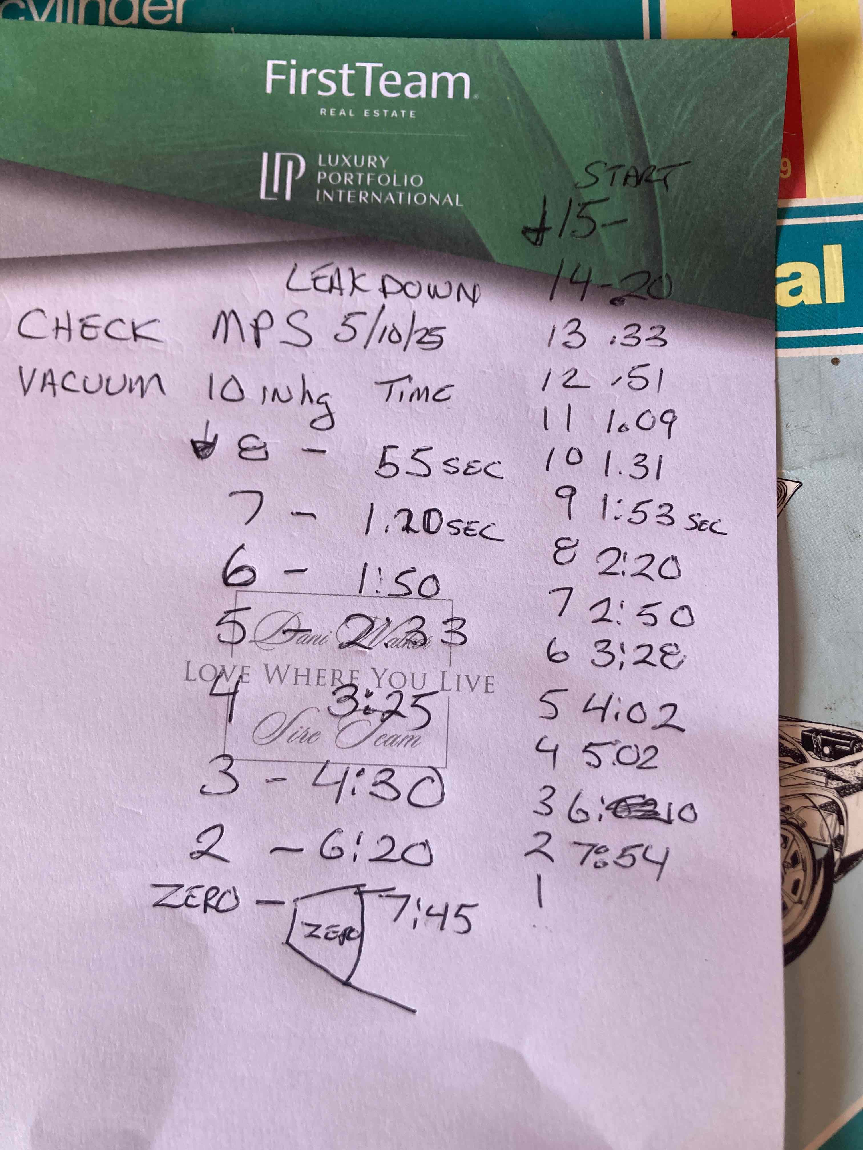

I did a leak down test @ 10 & 15 inHg start points ,see photo for results

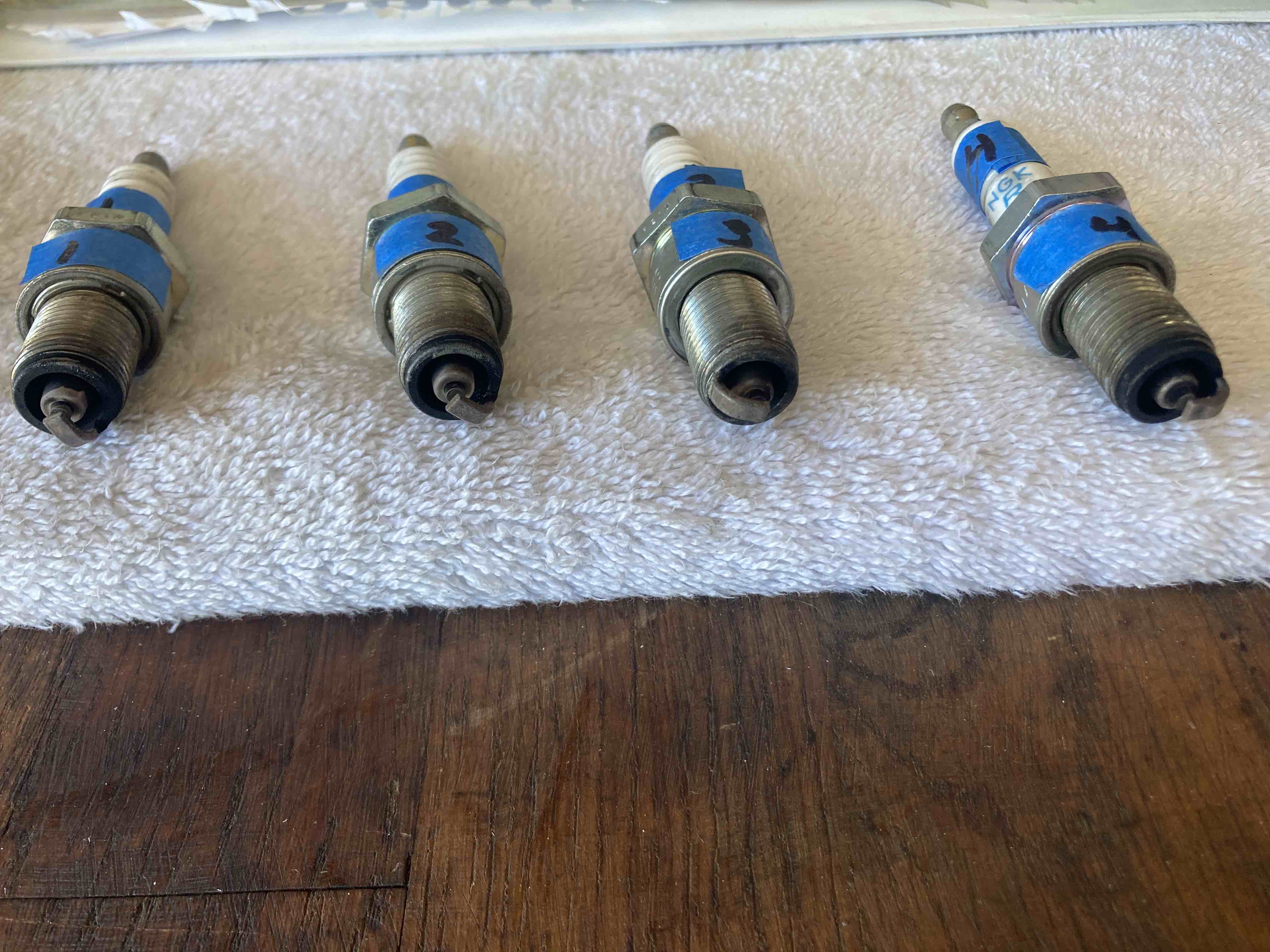

I also pulled my plugs and verified if I had a groove cut in my cylinder heads for proper seating of the CHT sensor and removed the anti-seize .
here's a photo of the plugs and groove which I have #3 .

MPS is leaking down too fast. Something not right. Did you use a light coat of grease on the gasket. Did you assemble the gasket / diaphragm in the order indicated? 1st time i did one it didn’t seal properly - didn’t grease the gasket to see what happens - it leaked.
It should be holding vacuum much longer than it is.

I greased the paper gasket and installed it first then the diaphragm ,and next the retainer ring I did not gob a lot of grease on the gasket but covered both sides well and used wheel bearing grease as was suggested in lieu Haylomar .I removed the original rubber gasket ( it was more square than the supplied round one) that was on the electronic side and replaced it with the one supplied .
I can always open it back up and check if that does not sound correct just to double check .
I also can change the plugs with a new set I have .

How do I test the plugs properly ( I am new to this stuff so walk me through what I should do ) .

The cap is brand new that wear was on the cap when I took it out of the box ,I assumed it was cleaned up during assembly that way . It was securely snapped into place .
I would open the MPS back up. I can post time lapse video of my MPS if necessary. It doesn’t leak down. I may have reused the OEM rubber seal - can’t remember for sure. I know from experience experience they leak if not assembled properly.
I wouldn’t worry about changing the plugs yet. Get it running better 1st. I’m old school - the way to test plugs is remove them, hook to spark plug wire, use insulated gloves or tools, hold metal part of the plug to the engine / ground, cranks the engine and watch for a bright, hot blue/white spark. Intermittent, weak yellow spark is bad news. Spark not jumping cleanly from the center electrode to the ground electrode is bad news. Seeing the spark as it jumps the gap gives you a lot of information. SAFETY NOTE: don’t do this right in the vicinity of the cylinder bore where fuel vapor may be. Fan housing is a good ground and a safe distance from cylinder opening. Better yet - disable fuel pump while doing this by pulling the pump relay.

Well I opened my MPS and found that the order in which I assembled was wrong . I installed the spacer ring over the part load stop which was wrong .I corrected this installing 1st the paper gasket(regreased) then the diaphragm followed by the spacer ring and the part load stop plate. Put it back to gather and tested and it still has a slow leak. I followed Jeff's advice and sealed the plug connection and then the area around the diaphragm center ring . I will put it back together later and test again and update .
ChrisFoley
I switched from a round o-ring to square in my kits a long time ago. Use grease on the round one, for sure.

Hi Chris,
I am still having leak down issues .It's a lot better but not ideal . How about if I put the old square gasket back in ? What's your opinion on that ?
I did all the things Jeff recommended but still had significant leaking .
I figured if the connection plug could be leaking at the base why not through the pins so I covered the plug with Gorilla duct tape .Here are my results after that last fix .
Next I am going to go around the case halves with electrical tape and put the square ring back in . I will update soon .

Although no leak is best. That leak is pretty slow so if it can't get any better I bet you will be fine.
Get rid of the adapters
Go straight from vacuum pump to MPS
Heat / stretch tubing as necessary to avoid the adapters which are all possible leak paths then retest

@Superhawk996 I removed the connectors and my leak down numbers are still about the same . I am at a loss . All this for nothing . I am thinking I should just by a new MPS . I know where might be able to get one but its going to be expensive .
