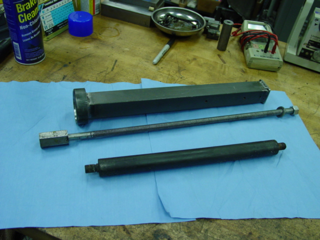

We all do it. We sometimes need a tool for a special use. It sometimes makes the difference in how well a job comes out Earlier this year, just for the heck of it, I removed the shaft from the bushings in an old trailing arm. I ended up using heat. I did get it out but what a an awful stinky mess! Yesterday Glenn (gms) stopped by with 2 trailing arms he was cleaning up. He wanted to know if I had a press for the job. With a little scrap metal some machining and welding we came up with a simple tool to remove the shaft. Here are a couple pictures of what we came up with. The tool worked really nice. I think if wanted, this would also work with the trailing arm in the car.
So how about posting some of the special tools you have made. Attached image(s)

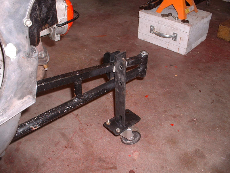

I kinda like by engine crossbar wheels. It's not something you use everyday but they sure are easy to use. No trying to balance the engine on a jack or dolly.

I kinda like by engine crossbar wheels. It's not something you use everyday but they sure are easy to use. No trying to balance the engine on a jack or dolly. Hi Ury That looks good. I did something similar once. I used only 1 wheel on each side. On mine the bar folded over while I was moving the motor and I broke a motor mount (or maybe it folded over because the mount was broken) . On the next one, I will use 2 wheels per side in an effort to keep the bar from folding over. |

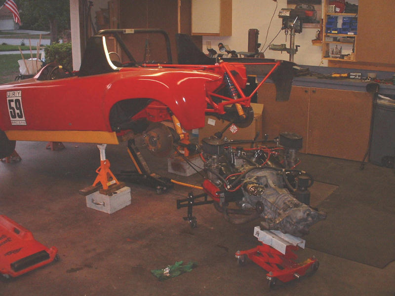

Here is my version of the engine installation tool. Jack up the car and slide it in! Well woth the hour of "fab" work
Mark (IMG:http://inlinethumb21.webshots.com/4756/2172091620057582025S600x600Q85.jpg) |

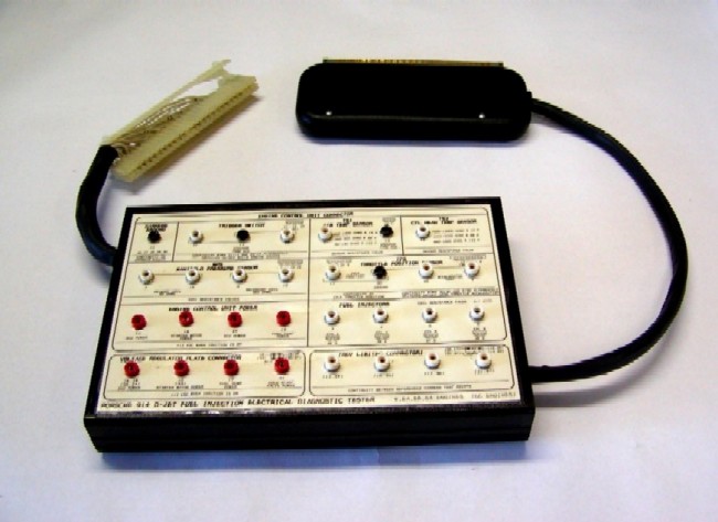

My D-Jet break-out box:

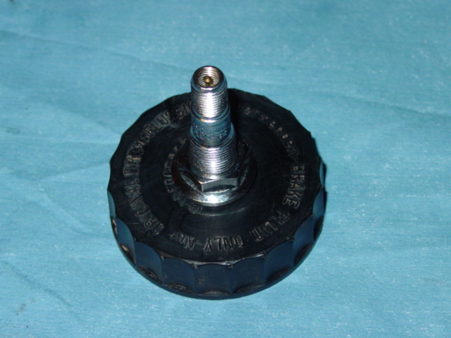

My Brake bleeder. Probably the simplest of tools but a great help. I use a bicycle pump to add pressure so I do not accidentally add too much pressure. Makes bleeding the brakes a snap.

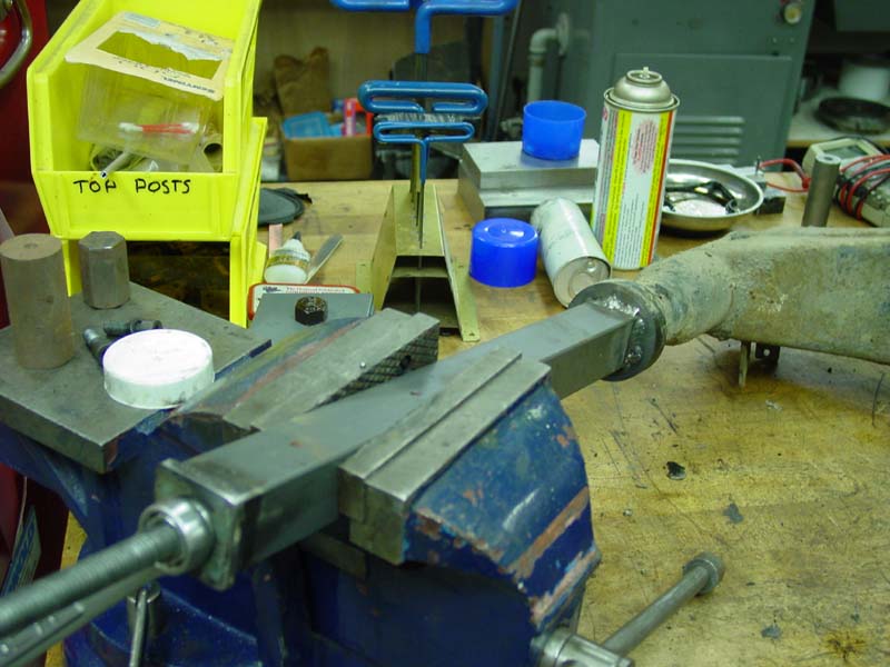

Those are some neat tools! I really like the arm shaft puller. I've been using heat and yes it does make a stinky mess!

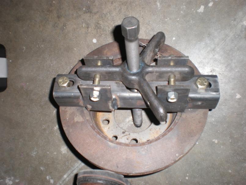

I came up with this cobbled together piece for pressing out stub axles while the arm is still in the car. Had to beat one out at the track last year and it made me want to throwup. Fortunately all of the beating didn't hurt anything or change my toe, but I decided that was the last time a hammer would be involved in that operation! It works great! An old brake disc, a few minutes on the mill (could have been done without the mill) and a few welds. The giant three jaw puller was given to me years ago so the whole apparatus was damn near free. I lke this thread. Hope more homemade tools follow. Attached thumbnail(s) |

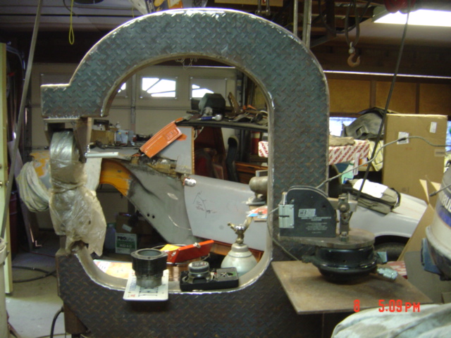

My English wheel and my shrinker / stretcher I converted to be pneumatic

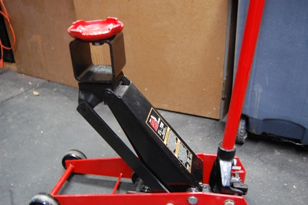

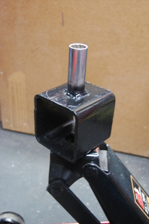

I made an extension for my floor jack. When I jack up my car I get it up high and adding wooden blocks under the car would get scary after awhile.
| URY914 |
Jan 8 2009, 07:10 PM
Post
#15
I built the lightest 914 in the history of mankind. ![]() ![]() ![]() ![]() ![]() ![]() ![]() ![]() ![]() ![]() ![]() ![]() ![]() ![]() ![]() ![]() ![]() ![]() ![]() ![]() ![]() ![]() ![]() ![]() ![]() ![]() ![]() ![]() ![]() ![]() ![]() ![]() ![]() ![]() ![]() ![]() ![]() ![]() ![]() ![]() ![]() ![]() ![]() ![]() ![]() ![]() ![]() ![]() ![]() ![]() ![]() ![]() ![]() ![]() ![]() ![]() ![]() ![]() ![]() ![]() ![]() ![]() ![]() ![]() ![]() ![]() ![]() ![]() ![]() ![]() ![]() ![]() ![]() ![]() ![]() ![]() ![]() ![]() ![]() ![]() ![]() ![]() ![]() ![]() ![]() ![]() ![]() ![]() ![]() ![]() ![]() ![]() ![]() ![]() ![]() ![]() ![]() ![]() ![]() ![]() Group: Members Posts: 135,080 Joined: 3-February 03 From: Jacksonville, FL Member No.: 222 Region Association: None |
I welded a old socket on the bottom of it to go in the hole in the jack.

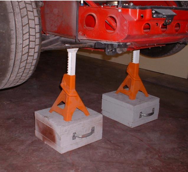

I also get comments on the jack stand blocks. Who would have thought you could improve on a jackstand. (IMG:style_emoticons/default/biggrin.gif)

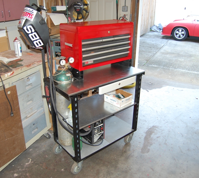

I build this tool box/welding cart too...

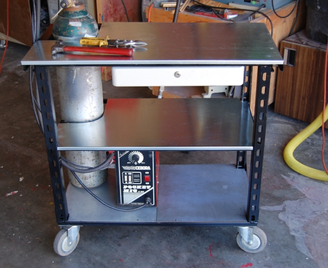

The frame in made of scrap Unistrut steel from a job site. I bought the tool box at a garage for $50 full of tools...
