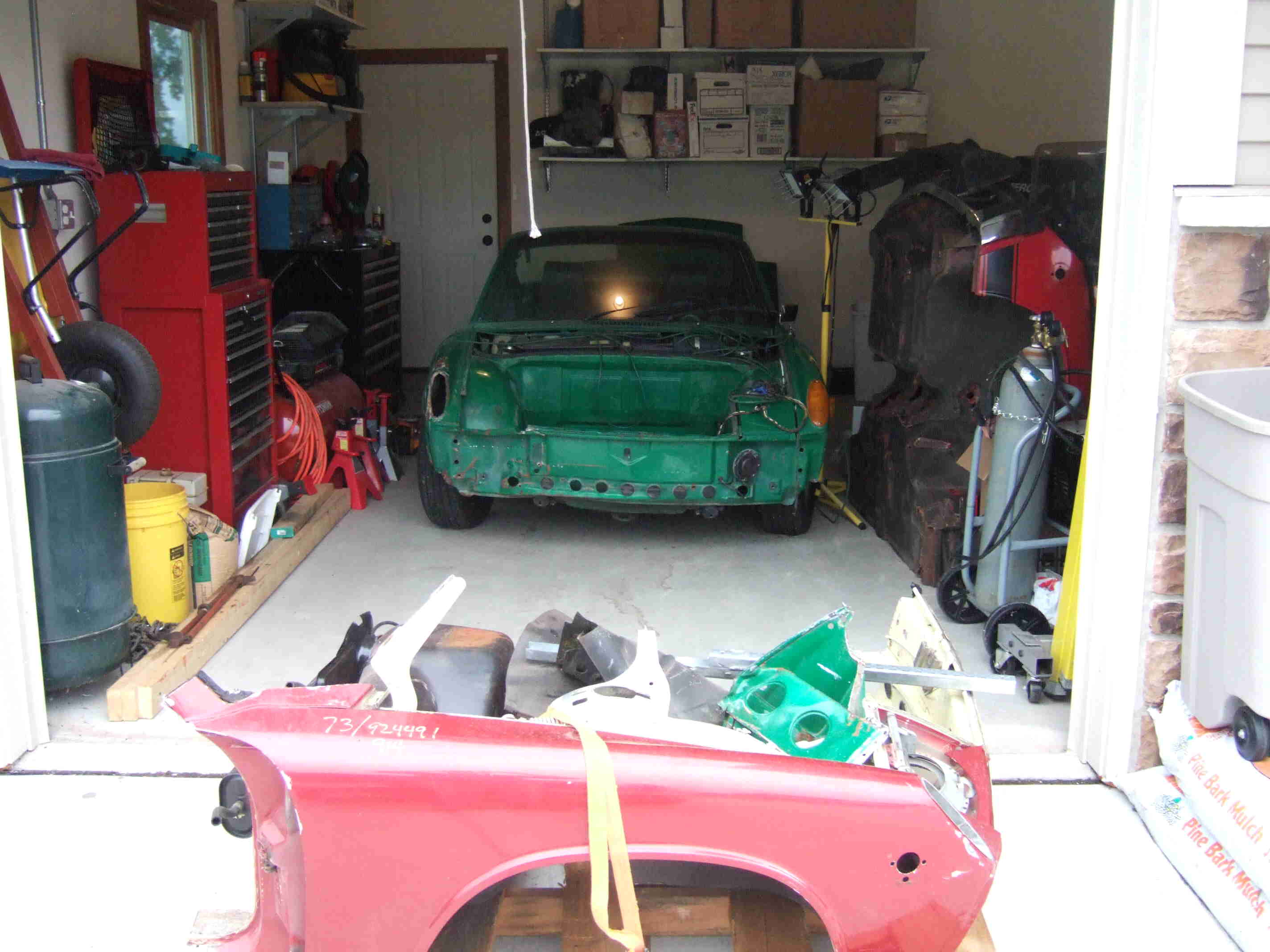

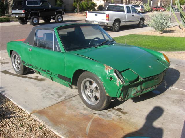

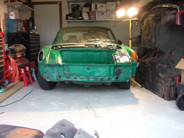

This is my new pride and joy. Well, it's not very new but I had to have it once I saw it. I first saw it on Craigs List down in Az. It was sold before I could even reach for the phone. I figured it was long gone. As luck would have it Budman decided to flip it and this baby now sits in my garage. It needs some serious love, but what 914 doesn't.

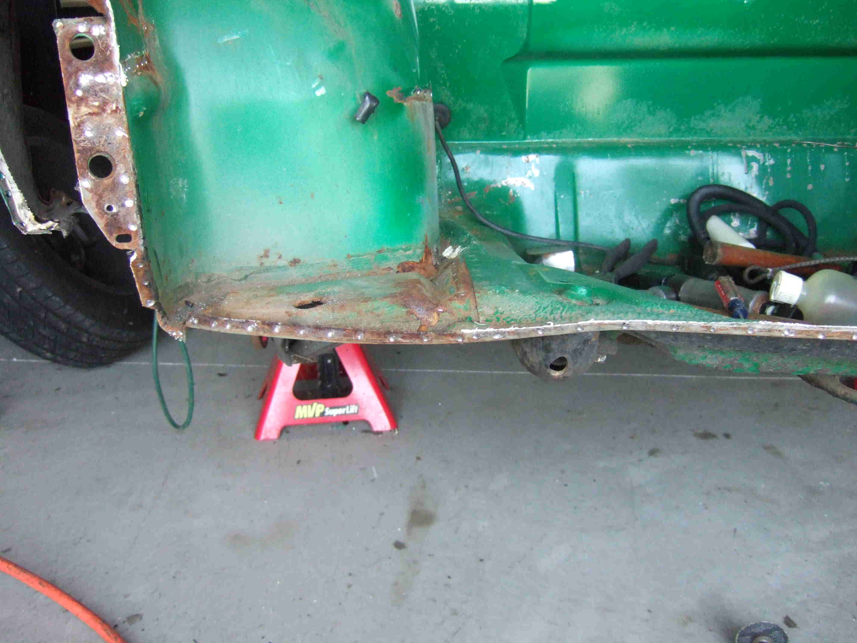

I'm pealing apart that bent passenger front corner. It's tweaked pretty good but the damage doesn't go that far back.

As you can see from the picture above the front A arm mount is bent up about 1 1/2". Here's what it looks like from the inside after I pealed some stuff apart.

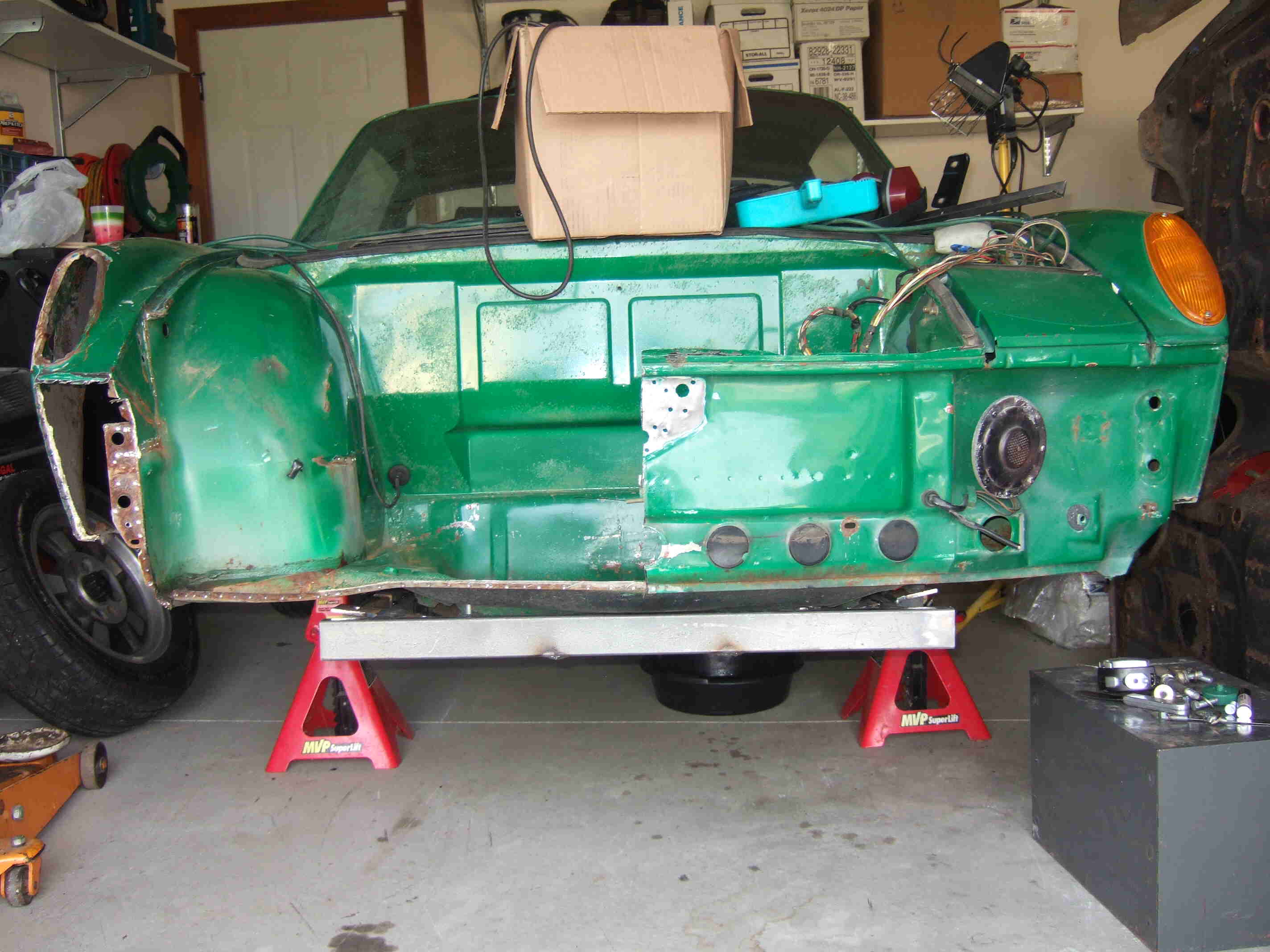

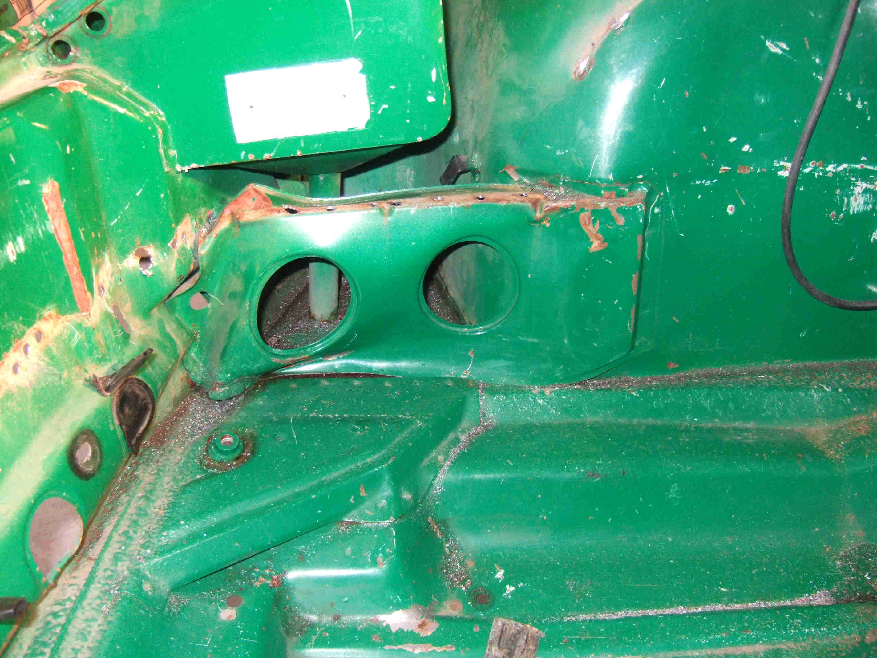

Now it looks much better with most of the bent stuff removed.

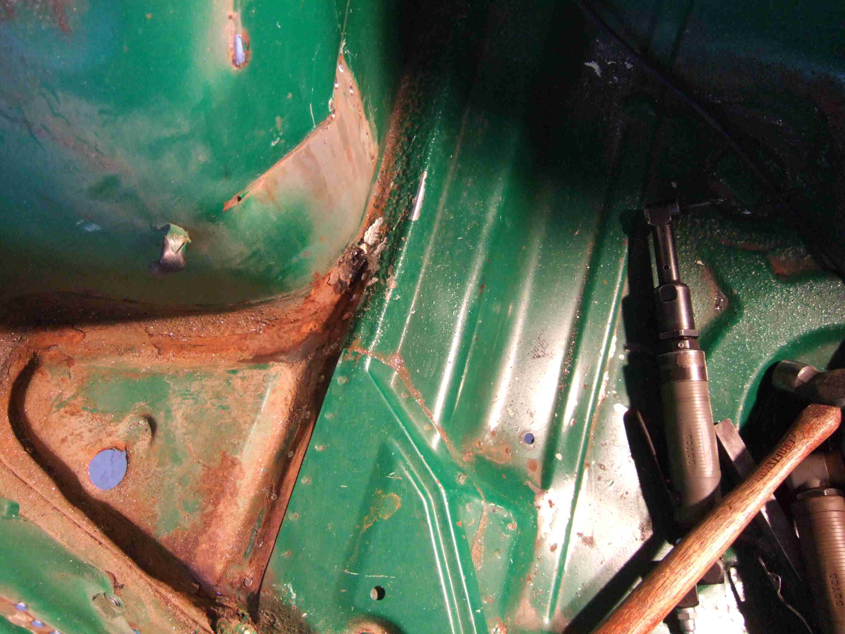

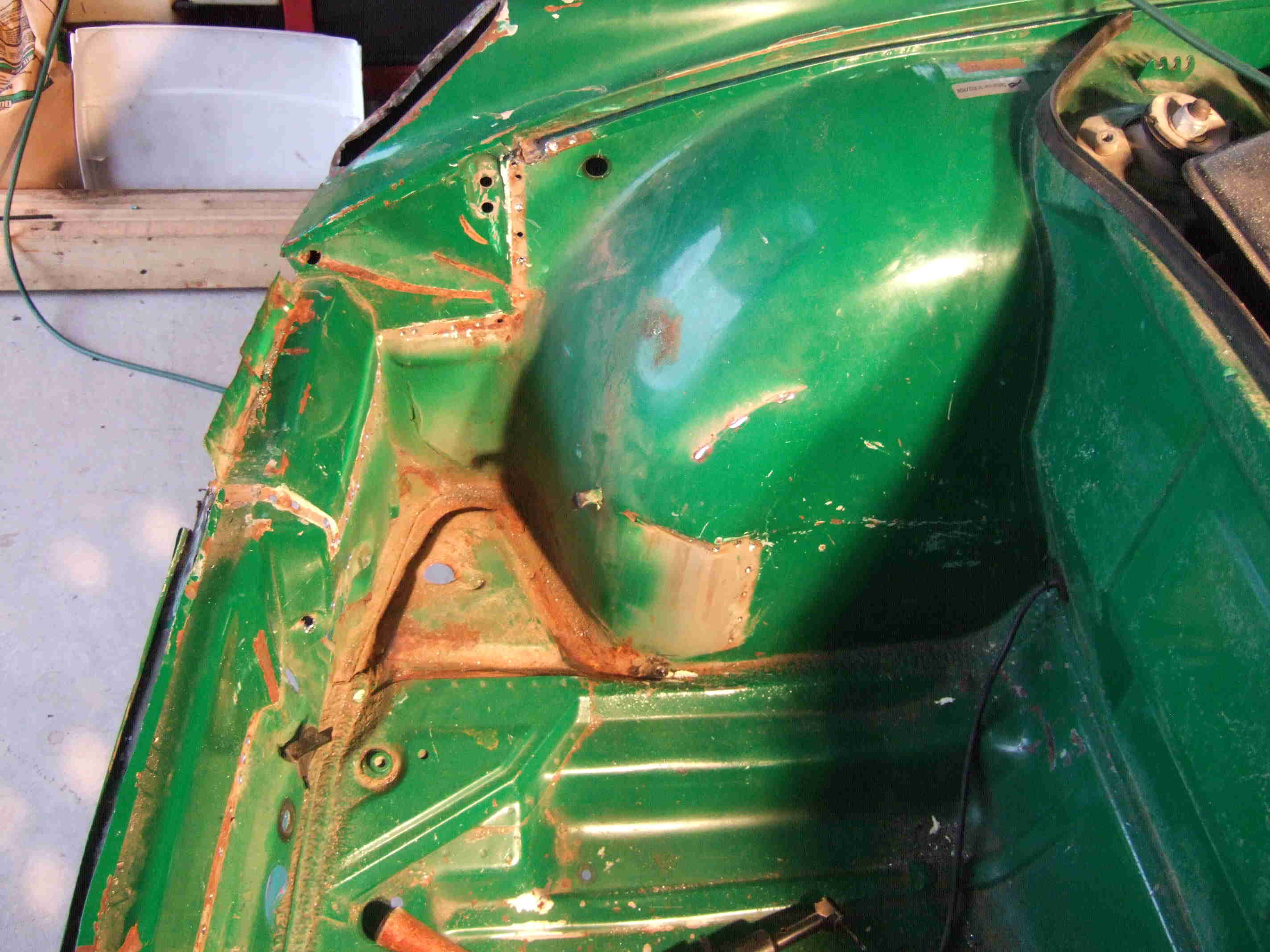

At first I figured I'd be cutting and pasting in a new inner fender. When it's all apart I can see there actually isn't any major damage to it. A dent here or there but all the damage was to the headlight bucket and the front A arm mount. You can see in the picture how it's tweaked up a bit.

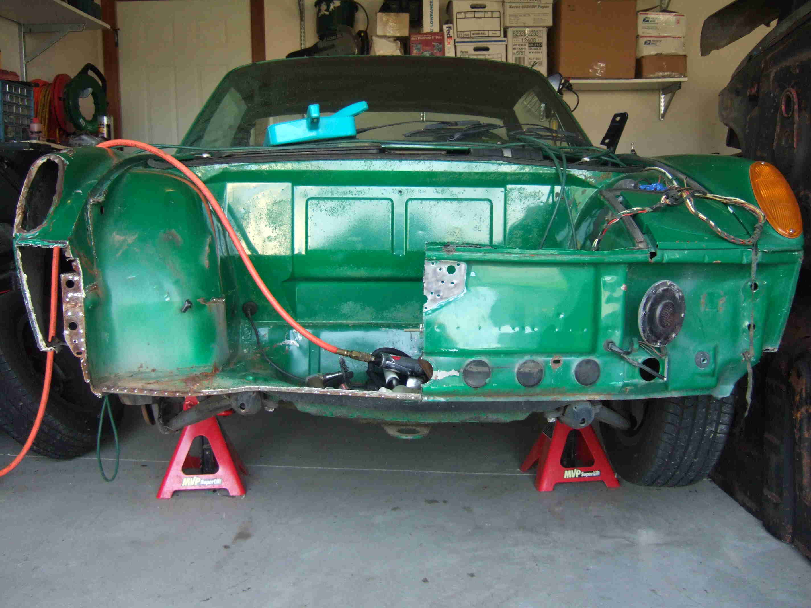

Here's a little better picture of the damaged area.

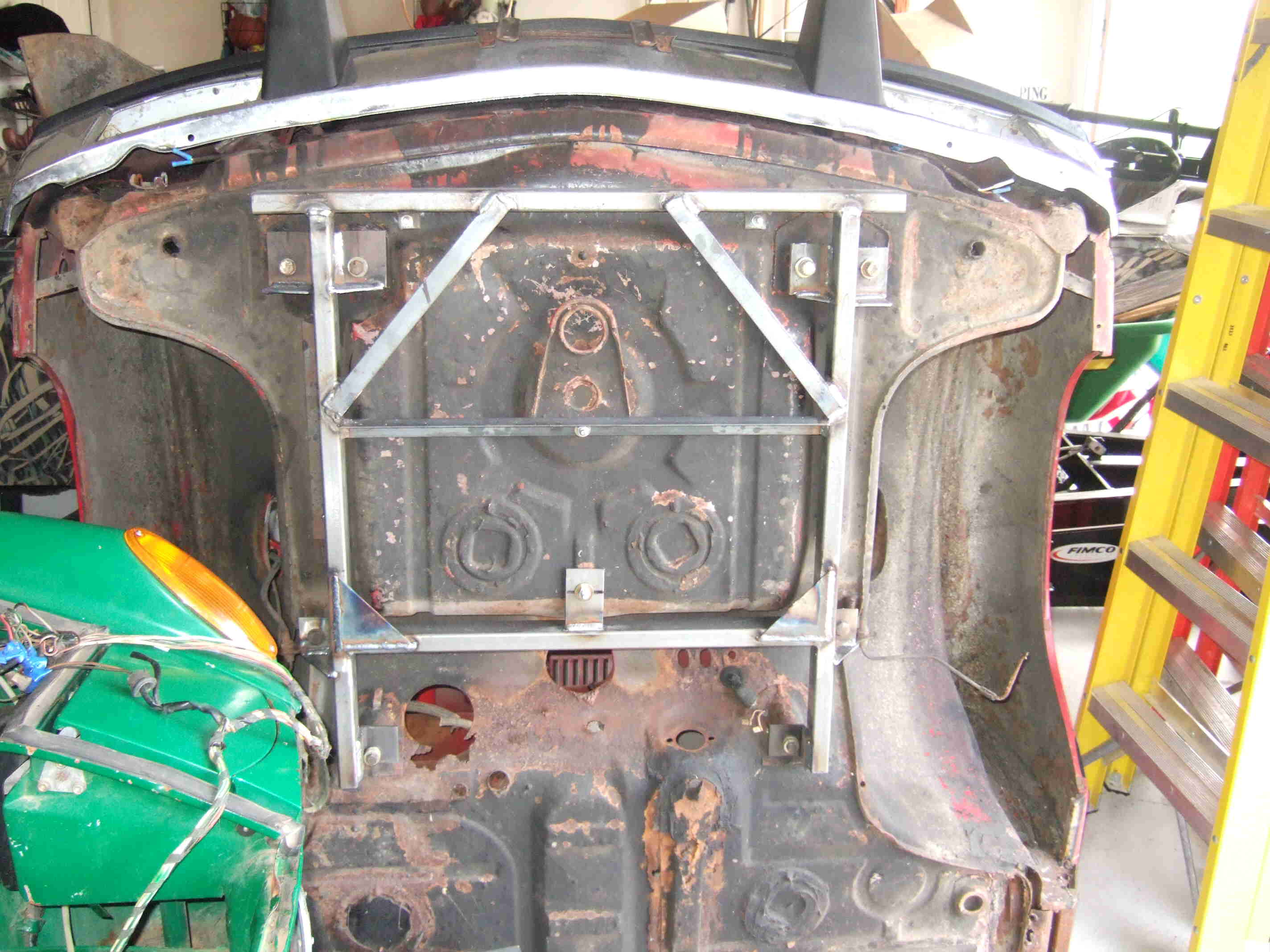

Once I get it up on the stands I can get a lot deeper into it. I plan to make a jig from the complete front clip I have. That way I can be sure I get it back together straight. I also have a fairly clean passenger front corner to get the needed parts.

Any of you 914 body repair experts feel free to pipe in with some advice. The plan right now is to fab up a long piece of steel with the passenger suspension mounting points incorporated. When I get everything loosened up I was going to tweak it back into place, bolt in the jig and then weld everything up. Any other ideas?

I was hoping an expert would step up. I'm still wondering if I should cut and paste or bend and massage. I suppose I'll bend and massage first. If that doesn't work out I can always cut and paste. I got a little more work done today. This weekend I'm hoping to have the jig fabbed up and I'll start to put it back together.

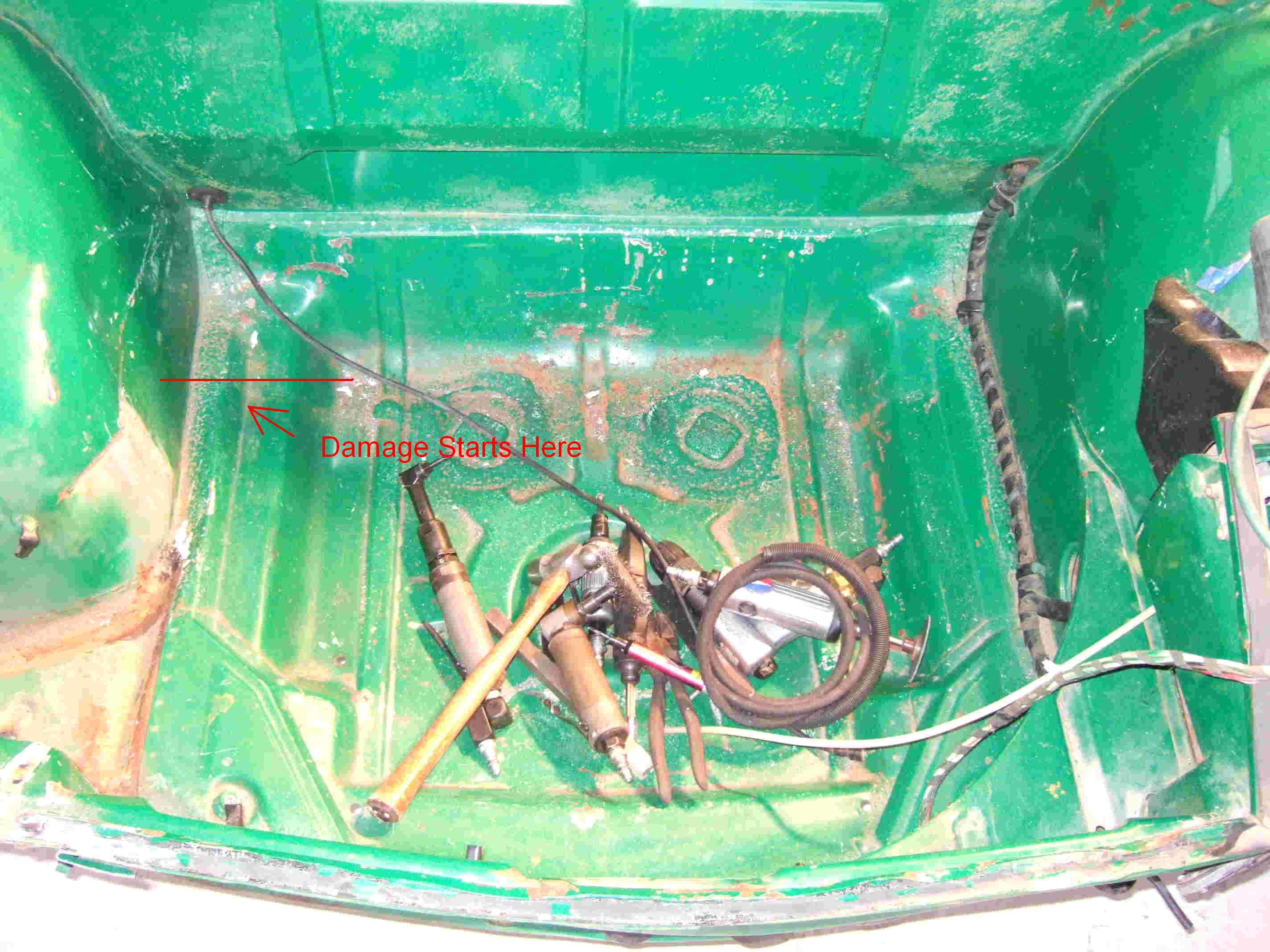

What the heck, another picture.

My advice, for the $.02 it is worth, would be to do a "cut-n-past" as you call it.
Recently, I had a similar issue, and rather than spend the time and agony trying
to straighen and pray that everything lined up, I just put a whole new front finder/front panel section on the car. I took the finder and finder well off the doner
car in one piece, with the cut along the floor section. This way, I was able to keep
the complete headlight bucket in place. Could not be more pleased with the end
result. Everything lined up perfect. Based on the front clips you have in the picture, if I were you, I would use as much of those in complete sections as possible. Just depends on how much time you have to put into getting it correct. Good luck.

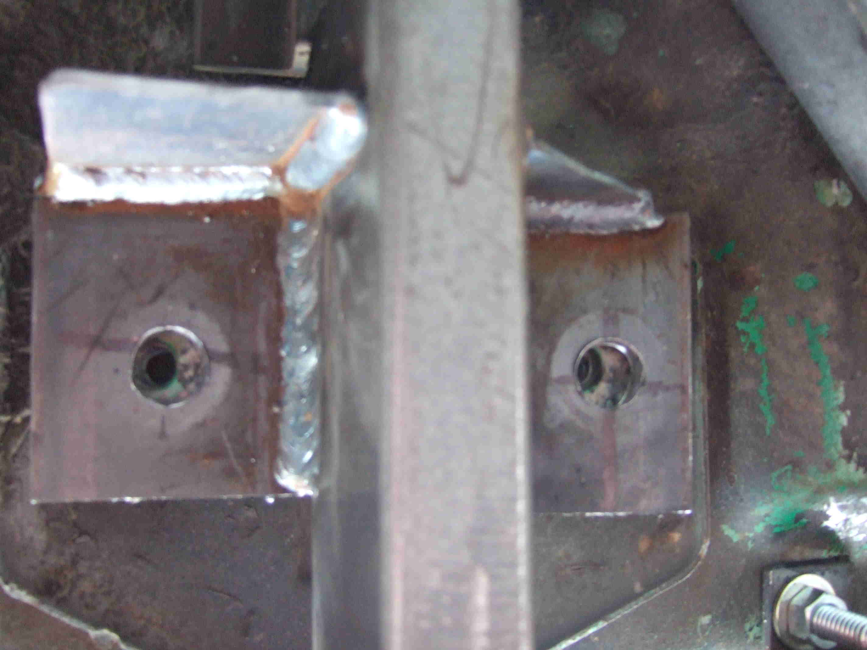

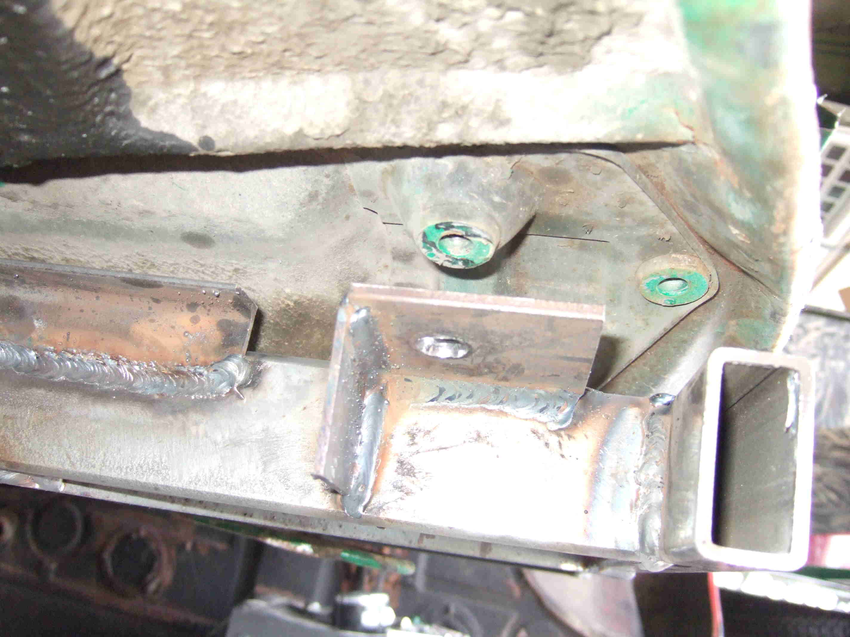

Finally got some time to work on it today. I finished up fabbing the jig and pulled the front suspension off the car.

Here's the jig bolted up to the green car. As you can see there is some major gappage on the passenger side.

I like the jig! Looks like you have plenty of donor parts to do things right.

Thanks for the offer John. My mounts are actually in great shape. Unfortunately, the front is about 3/16 too far to the left. It looks like when it was hit, the floor of the front trunk was moved over a bit. I'll have to drill out the spotwelds of the floor and then line it up to the jig. Then I'll weld it back up straight. I'm thankful that the rear mounts of the front suspension are straight. The jig lined up perfect to them. If they were jazzed up I'd be looking for a bench. Without 2 good reference points my jig is useless.
Thanks for the comments on the jig. I measured up all the mounting holes and they all line up square. I didn't spend much time making it fancy. It's kinda ugly looking but it works. It got me back into the swing of welding too. It's been awhile.

You should have done your pulls before removing the front panel. Even with the damage as it was, the connecting panels would help bring the remote damage that traveled around the box back in line. Think about the uni-body as a box shaped bird cage. If you pull on one corner the other corner move. If you cut the bird cage and repete the pull only the section your working moves. Not the worse think in your case as the damage looks minor. It just makes it a little harder to get both right and left pick up points to move as one and not spread apart from one an other. Make a cross bar to maintain the space between your front right and left suspension pick up points. Bolt it in when you pull the chassis.
You need a way to do a down pull. You could drill some holes in your concrete floor and install 1/2 anchor bolts. Then make a bolt on bracket for the pickup points. Then attach chains to the bolts and brackets in a circle shape. This is called a Vector pull. Build a spreader like a turn buckle (or if you have a port-o-power use that) and install it between the looped chain. Then use the turn buckle to take the slack out of the chain. you will likely need 4 bolts in your floor. This will hold the chassis to the floor. Use the same method on the high corner only use the turn buckle to spread the chain til the corner starts coming down. Use a wood block and a BFH to relieve the stress. You will probably notice you will need to add stands to stop the chassis from doing what you don't want it to do. You may also notice once the right corner starts coming down the left corn may start to move over.
Nice fixture BTW. Stay at it. You'll get it. I've done lots and lots of uni-body repairs. I even had a Cellette. You just have to think about how to reverse the impact. And don't go crazy with a BFH (IMG:style_emoticons/default/smash.gif) Light hits. use Wood blocking to span a larger area when using the BFH.

Thanks for the tips Rick. I was hoping an experienced body work type guy would pipe in. I don't have much unibody experience. I used to work on cars and trucks of the 40's and 50's. A big hammer and torch was about all I needed. I should have tried the jig before I pealed stuff apart. I think your right in thinking that the drivers side mount will slide into place when I pull down the passenger corner. I'll rig up a way to do the pull this weekend.
