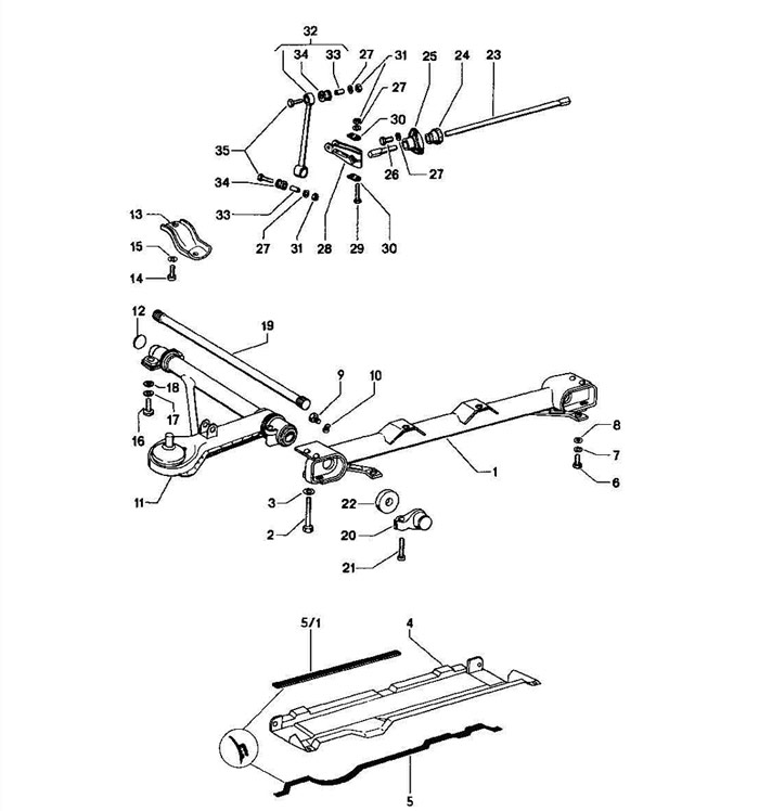

5. Removed two bolts that attach support bar to body (off the tabs that face the rear of the car (shown at item 6 in the diagram).

Question 1: How do I move the master cylinder out of the way? The short brake line that goes to the tunnel doesn't give the master cylinder a lot of distance to back off, and the support bar (item #1 in the diagram) is in the way when I pull the master cylinder back.
Question 2: How do I actually remove the rack? The steering shaft directly connected to the rack seems to require that I drop the rack directly down. But the bolt tabs on the support bar itself (Item #1 in the diagram), as well as the bolt tabs that run a few inches to the underside of the body (towards the rear or the body) (item # 6 in the diagram) all seem to be in the way? What am I missing???

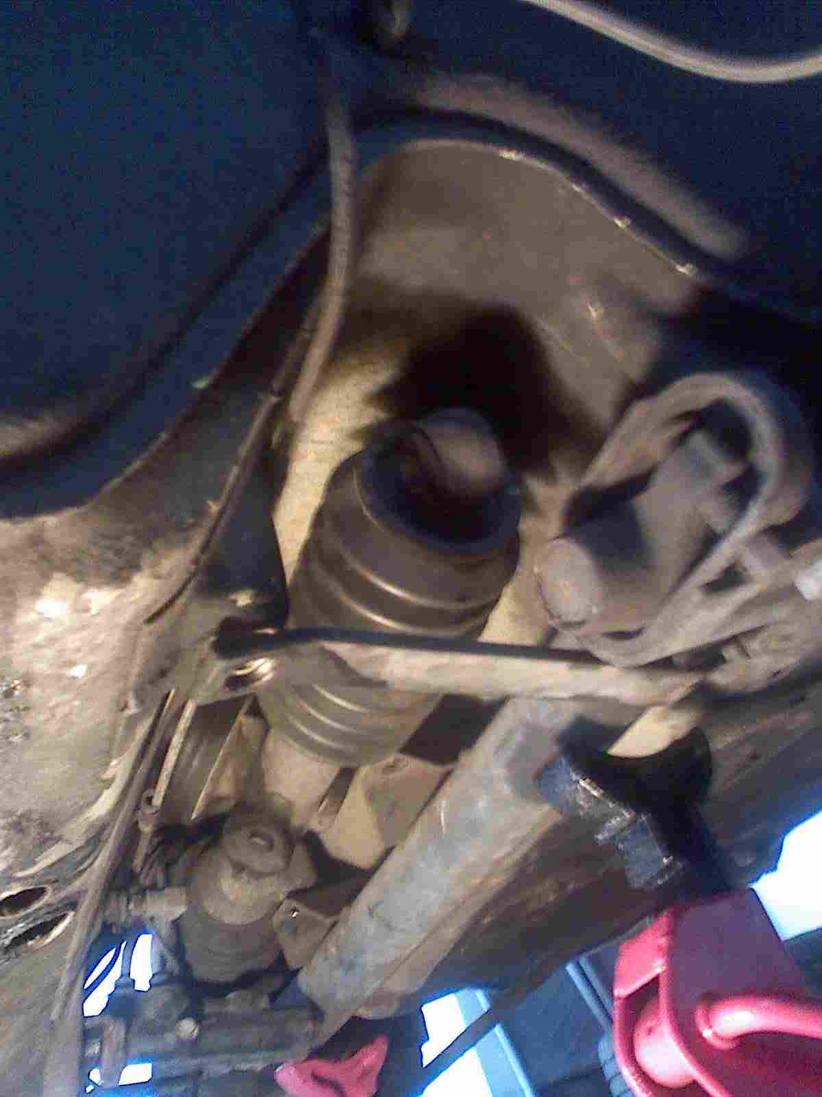

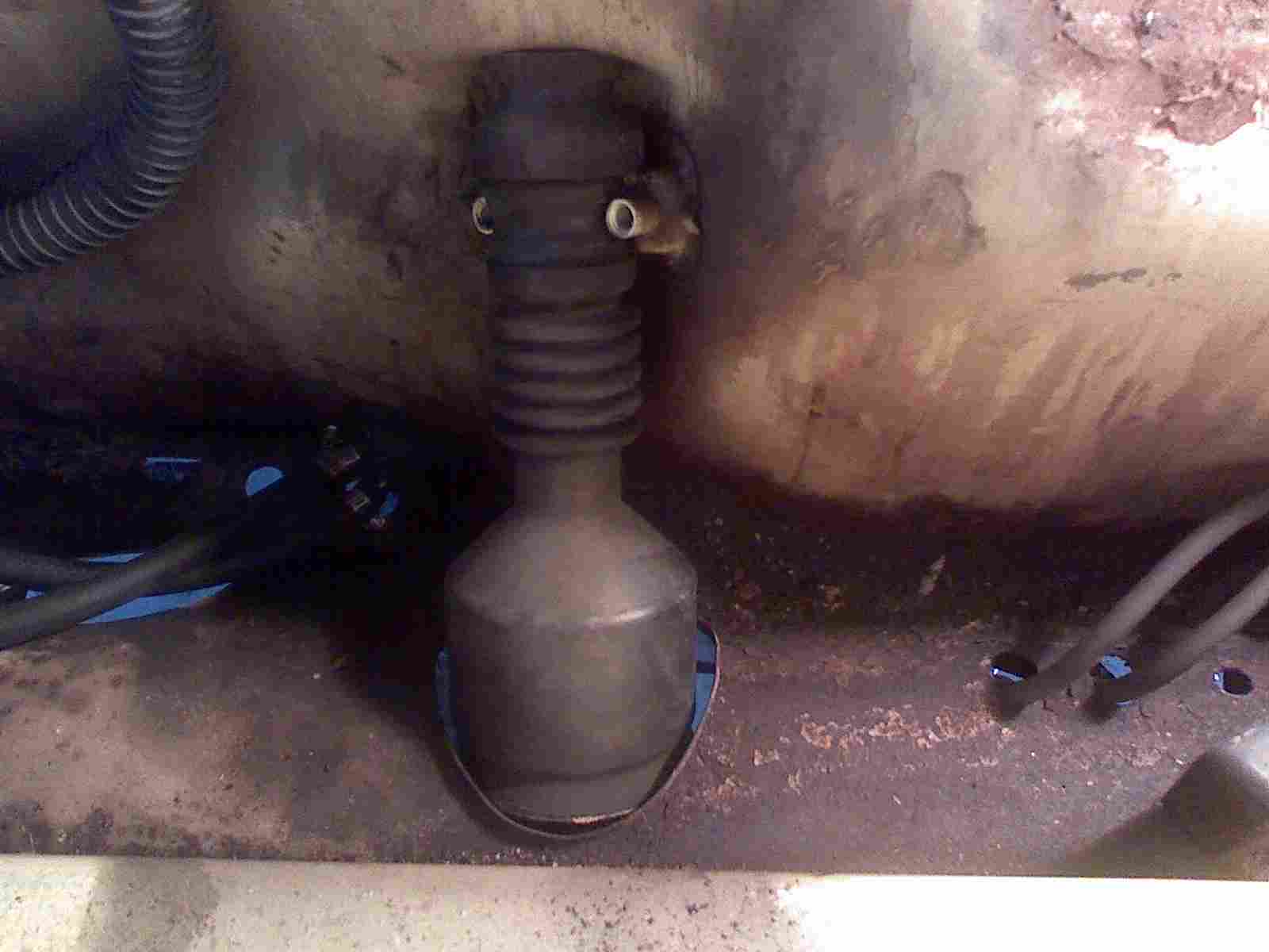

Here is a picture or the fuel tank area. As you can see, the steering shaft bellows is quite hard and takes up the entire area. Unless I cut the bellows (which I don't want to do), how can I push the bellows up? The bellows are already pretty well compressed, and do not seem to want to compress any further. Or am I just being a wimp, and the bellows is compressable, I'm just not trying hard enough?

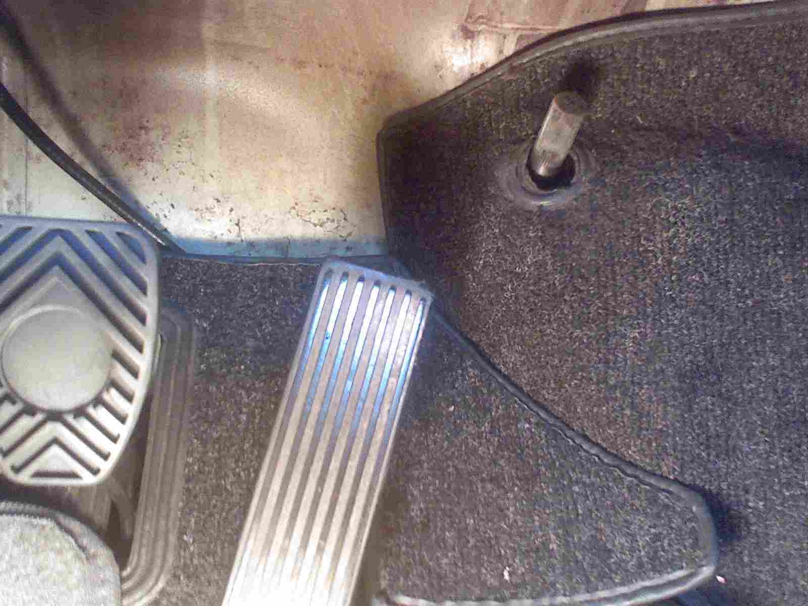

Here's the inside of the cockpit which shows the steering shaft.

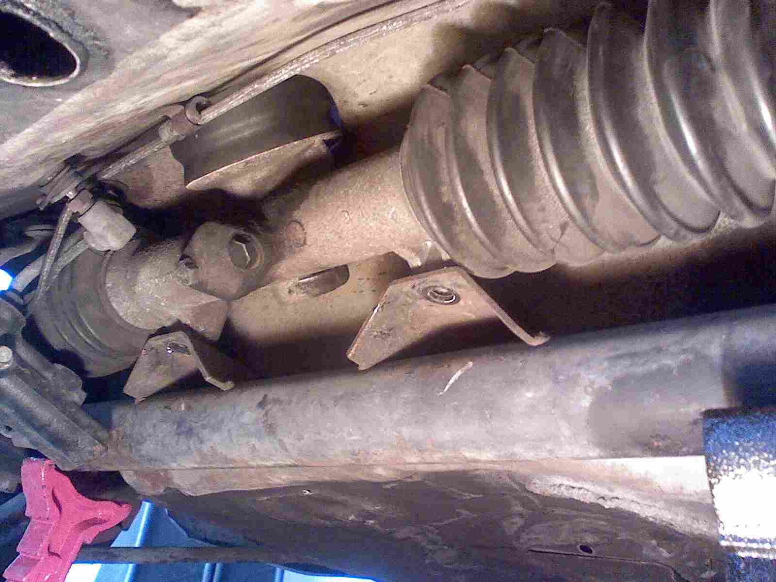

A picture from underneath the car showing the steering rack disconnected, but not yet removed. (IMG:style_emoticons/default/headbang.gif)
And a final picture from underneath, showing the support bar brackets.

Please explain... Lowering the cross-member requires only two additional bolts? Is the the bar shown in this picture?
It seems to me that the entire front suspension is attached to this bar? Is that the bar identified as #1 in the following diagram? Where exactly are the two bolts needed to lower this bar?

remove #2 and #6 and the crossmember #1 should start hanging down, giving you more room to remove the rack.
There isn't much holding the front suspension on the car. There's 2 bolts on the front of each A-Arm, bolts #2 and #6 on the crossmember, and the 2 bolts on top of the struts and the whole suspension comes off.
Removing #2 and #6 should allow the crossmember to droop enough to remove the rack.
The crossmember can be removed by removing the torsion bar adjusters (#20 and #21) and tapping the crossmember with a hammer towards the back of the car.

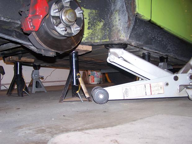

Just looked at your pics. Your jackstands are under the crossmember so you will have to reposition them behind the front wheel wells where are the little bumps. Use a piece of wood to distribute the weight and place near the edge of the wheel well so the weight isn't on an unsupported area of the floor pan.

Take a close look and you'll see the top of the jacks are actually several inches under the crossmember. My primary jackstands are under the lifting "bumps" you mention. These are secondary jackstands in case I experience a failure with a primary jackstand.
I will move them aside when I drop the crossmember.
