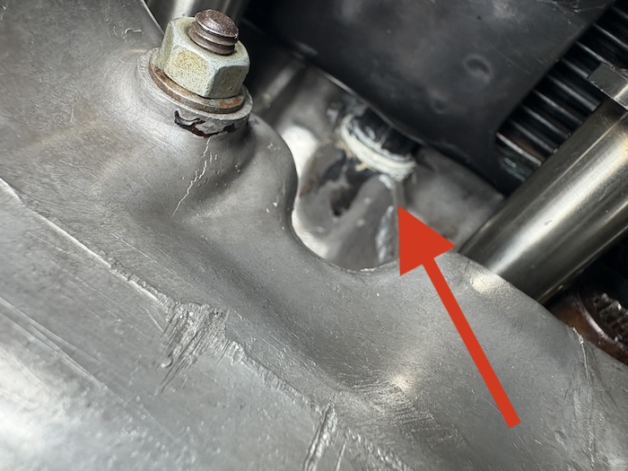

Found a new oil leak. It appears to be the case through bolt in between cyl. 1&2
Picture is a little rough....tough to get phone up in there.
How to fix?
Thanks for any insight.

Looks like the #1 or #2 intake push rod tube to me. Hard to tell.

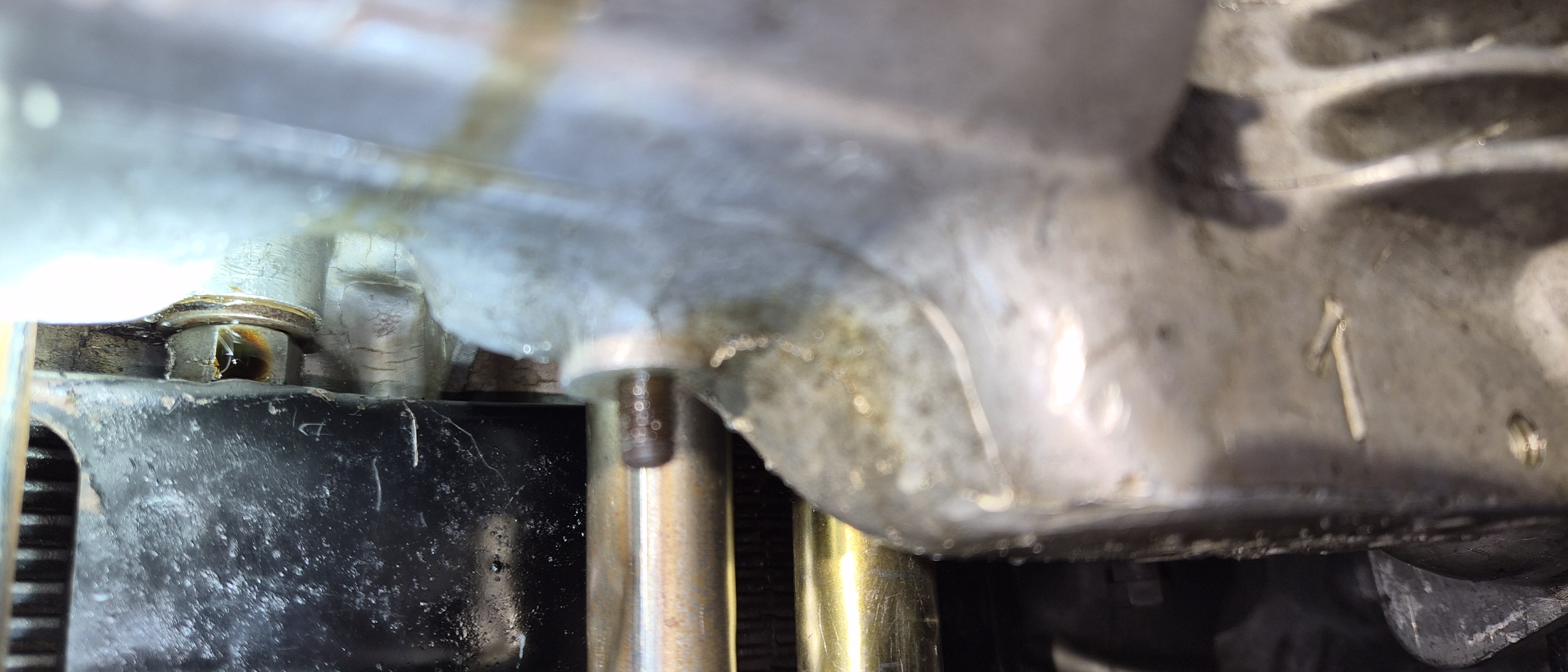

Confirmed Through-bolt. Here's mine.
You're probably not going to like the answer to this question. I think you're going to have to pull all the pull rod tubes/ push rods, remove the tin on both sides so you can get at the bolt. Loosen it, apply thread sealant and then re-torque. Somebody else might have a better trick.

First thing I would do is wipe off that oil and see if it comes back. Maybe I am losing it but I zoomed in and could not see oil on the washer or the sealant. It is just that is a lot of work and I do not see oil squeezing out from behind. Maybe look above first

Hey, thanks. You're right....I don't like it. But it needs to be fixed. Is that a crush washer behind a or the "regular" washer. Found this on pelican. Tried PET but was having a hard time locating that specific bolt configuration.
If Im going in, I want to be ready with new washer/washers etc

(IMG:style_emoticons/default/agree.gif) Also you might be able to get a wrench up there to try and tighten it, if that's the source of the leak.
