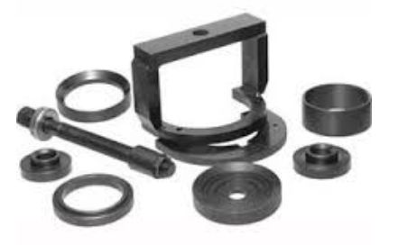

Note that you still need the other bearing tools to do the job, just normally
they say to beat on the hub and it will come out, before doing the bearing.
I have one of these old setups to do the bearing removal and install:
