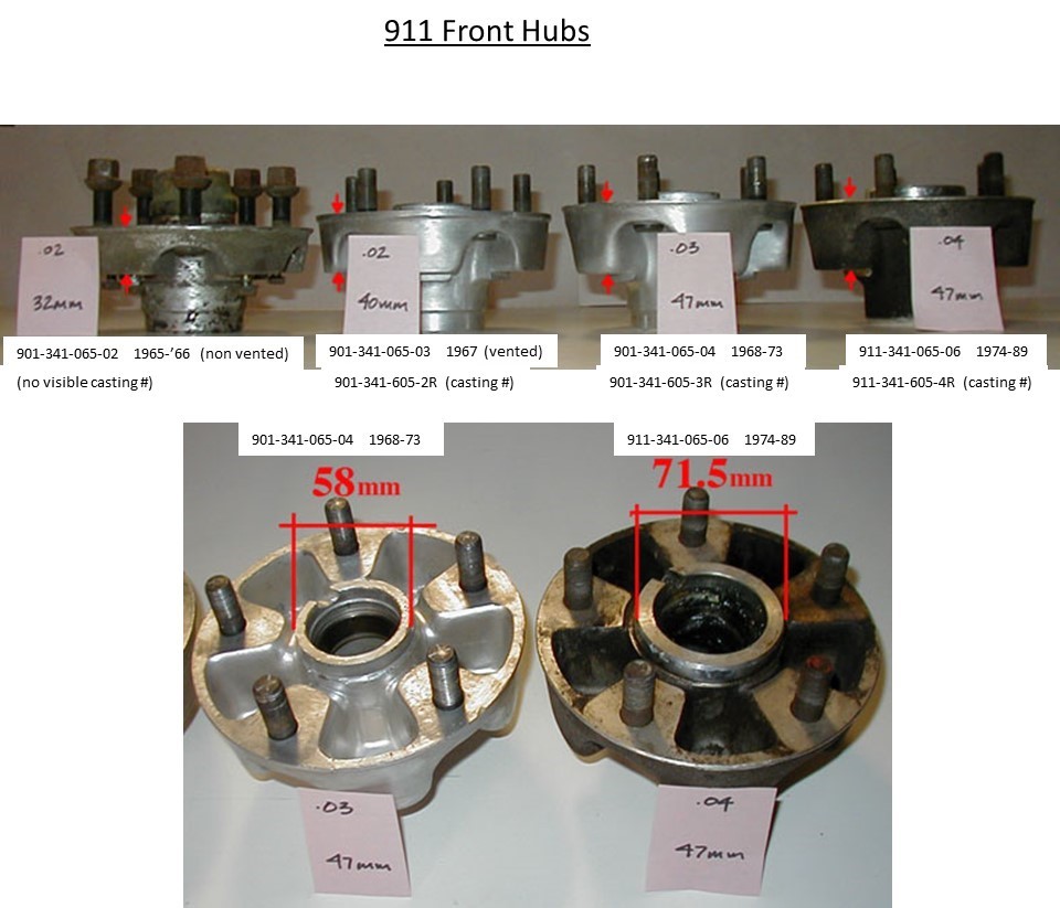

Follow-up question: since I've already got one wide Carrera caliper, I'm thinking about going the other direction and converting the left side to match, then running 24 mm Carrera rotors on both sides.
Are the 24 mm Carrera rotors a straight bolt-on for my SC hubs, or do I need Carrera hubs?
Luke M
post Oct 4 2026, 05:35 AM
Posts: 1,608
Joined: 8-February 05
From: WNY
Member No.: 3,574
QUOTE(Nana's_914 @ Oct 3 2026, 10:25 PM) *
The 74 to 89 911 hubs are the same. Swap out the rotors and caliper with the Carrera stuff and your good to go.
