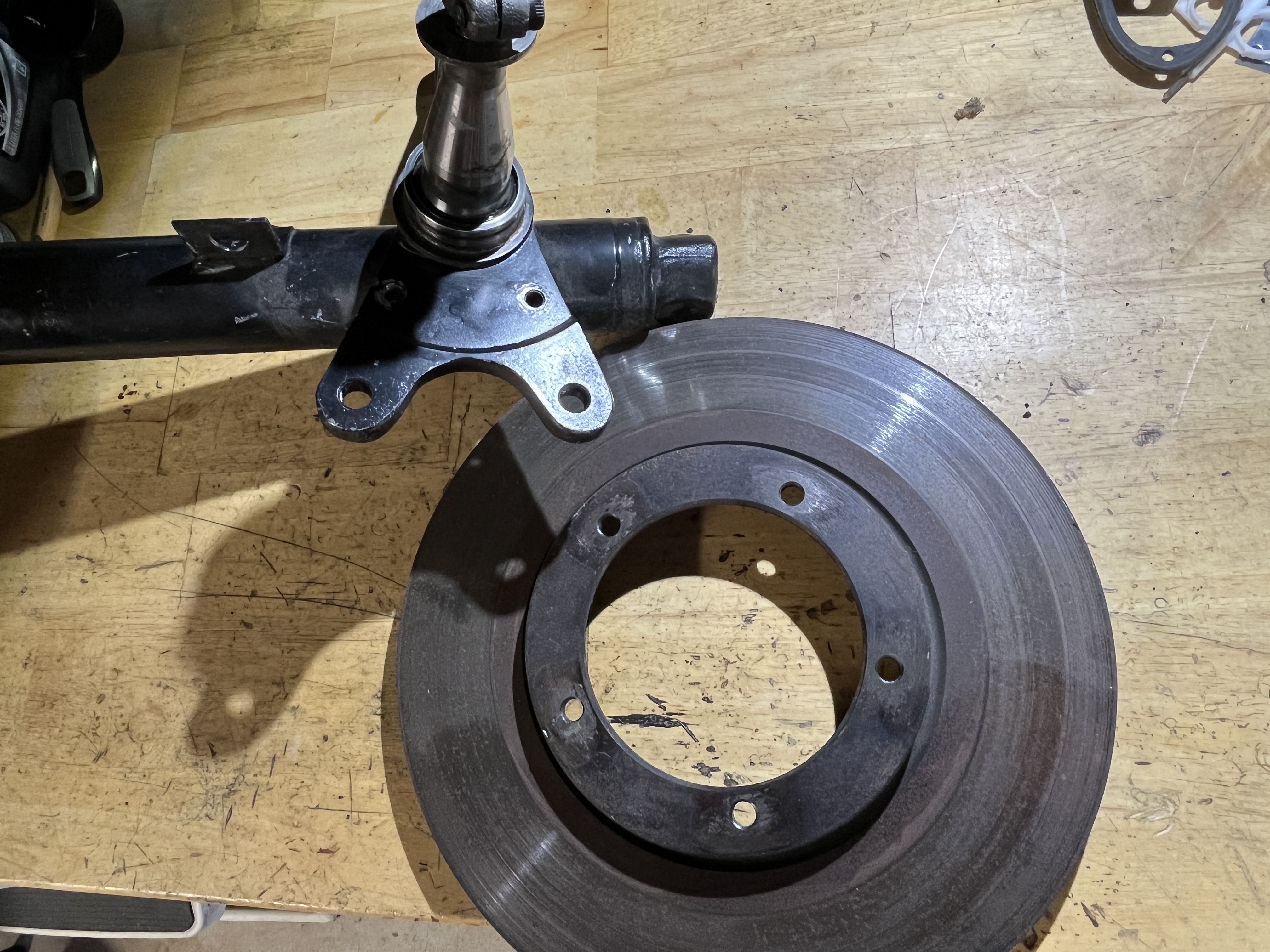

I’m installing these 911 struts. What kind of hardware is needed to attach these rotors to the hubs? Do I need to use locktite?
sixaddict
post Oct 1 2026, 09:38 PM
Posts: 1,088
Joined: 22-January 09
From: Panama City Beach, FL
Member No.: 9,961
The hub is not shown in pics……it goes on spindle and is secured with nut shown in picture.

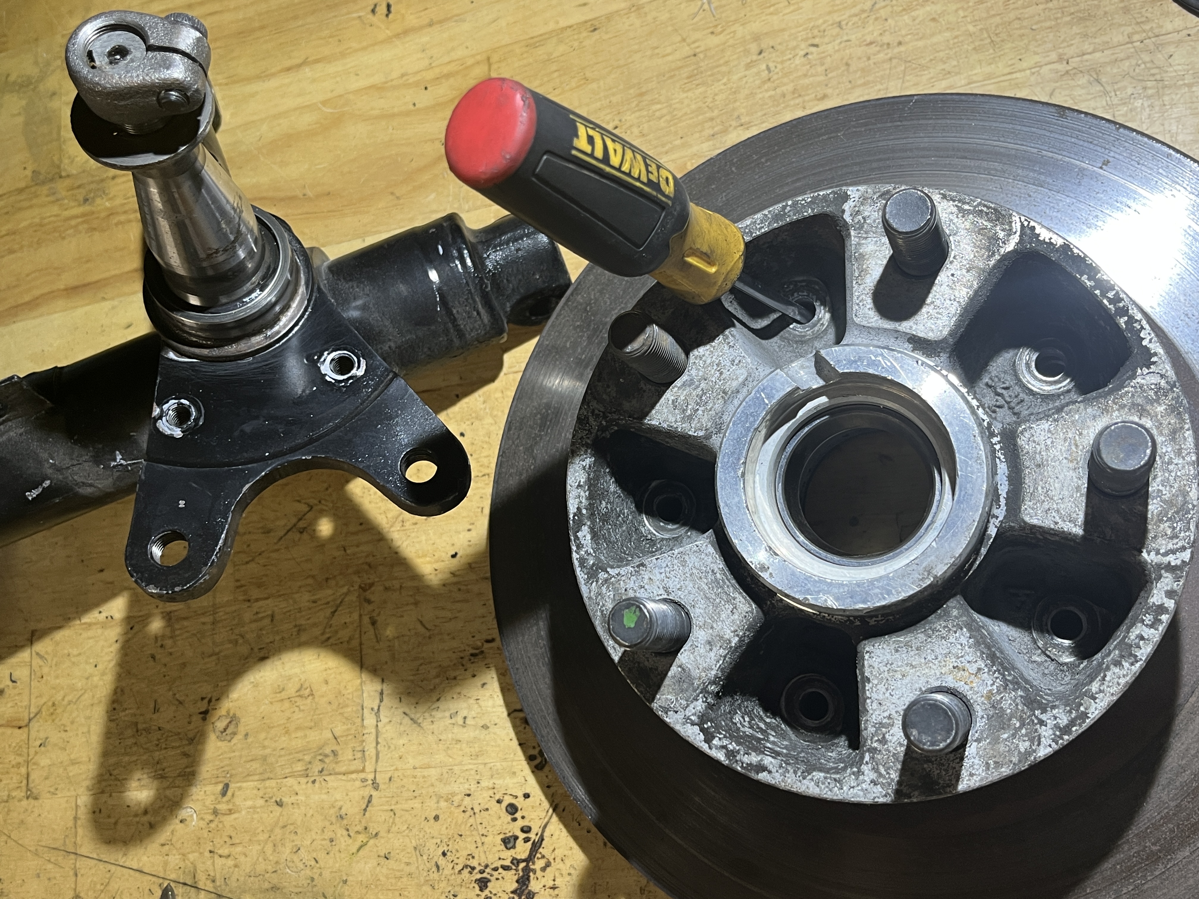

Here’s a photo with the hub. What hardware is used to attach the rotor where the screwdriver is inserted? Do I have this right?
pfreiburger
post Oct 1 2026, 10:53 PM
Posts: 152
Joined: 6-October 20
From: Fond du Lac, WI
Member No.: 24,738
Hello - I don't know what year your 911 parts are, but a 70-73 uses M8x22 bolts, M8 hex nuts and spring washers. The Porsche # is 900-075-079-02, but any of the fastener supply vendors (also AA, etc.) can supply good ones, a couple of bucks a throw or less. The originals were a grade 8.8, so get at least that - I might be tempted to go to 10.9. Cheers!
