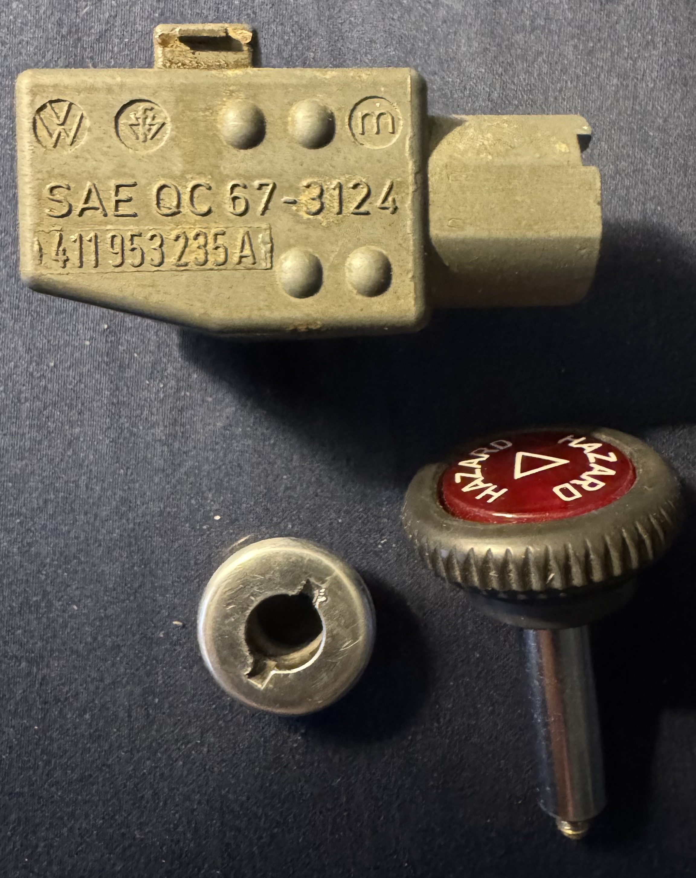

We have enough vw stuff on our cars. I used Howard's original E switch so You pay for the shipping I will send you the one out of my 72. Always worked. PM if interested
I put in a pic so you can check the part number. Do you need all three pieces or are you good with just the switch?
