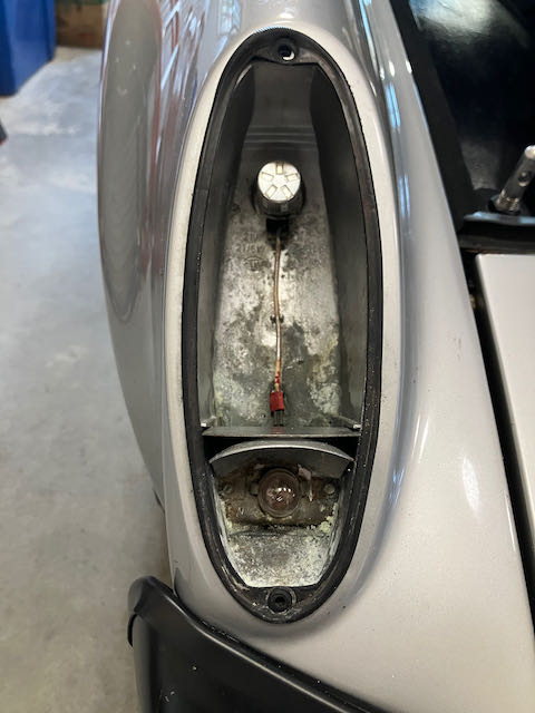

> How do I remove bottom running light bulb from Euro front turn signal
morehills
post Sep 27 2026, 07:34 AM
Posts: 151
Joined: 2-March 23
From: Great Barrington, MA
Member No.: 27,202
Not sure how the clip works and the bulb is tight and not removable from the front. Do I have to pull the assembly to get this bulb out? Thanks, John
NARP74
post Sep 27 2026, 08:42 AM
Posts: 1,572
Joined: 29-July 20
From: Colorado, USA, Earth
Member No.: 24,549
Probably just corrosion from dissimilar metals. Try some lube spray of some kind. Work it in. Use a cloth, the bulb will probably break from the base. Might need pliers to get the base out after the glass comes out.
Or remove both left and right assemblies and trade me for two "normal" ones without the extra bulb!
