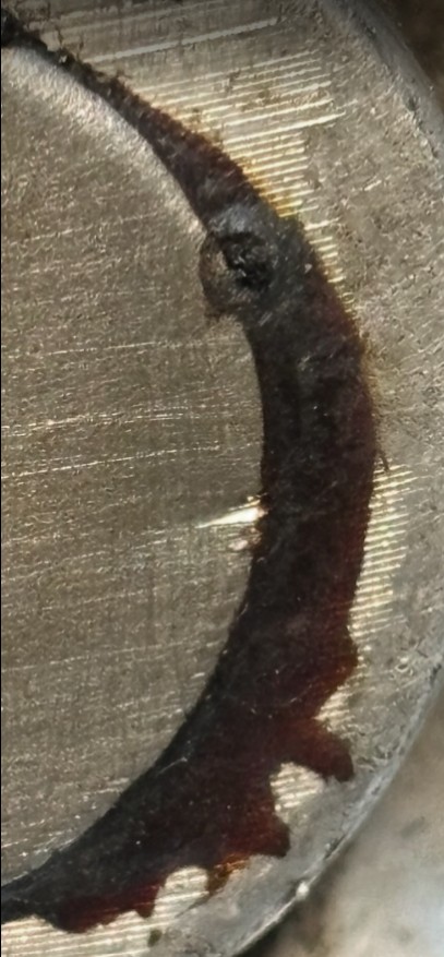

I've owned my 914 for 15 years and close to 40k miles now and never had the engine out! But I haven't used it much in the last 5 for several reasons.
The biggest is it shifts poorly, and it was dripping both motor oil and gear oil out of the bellhousing. I also had never done a deep dive for rust, but some holes that appeared where the floor and long meet under the driver's seat have convinced me now is the time (I'm 66 yo and afraid it will get "stuck" on the jack stands rather than being driven).
So far, the chassis is really very solid, but there will be more revelations and questions about that to come.
I dropped the entire drivetrain and separated the motor and trans thinking I had a rear main seal leak, but instead it turned out to be the camshaft sealing plug.
I found a lot of directions for pulling, tapping the rest of the oil gallery plugs (which I will not be doing), but no specific mentions of this larger plug.
Is it the same drill a hole, put a screw in and pull it out, followed by gluing a new one in?
Thanks in advance - more questions to follow

You need to split the case to replace that.

QUOTE(ejm @ Sep 21 2026, 06:23 AM) *
Looks like Hans didn't seat that one well, you might be able and lucky to hammer it in a bit further because its not square in the hole, but I'm no expert? (IMG:style_emoticons/default/confused24.gif)

No, no, and no (IMG:style_emoticons/default/sheeplove.gif)’in way.
Do not hammer that.
Previous post was correct - have to split the case to repair / replace properly.

I’m struggling with the ethics of offering more options.
From OP it’s clear that right now you don’t understand how this was put together. Not trying to shame you and you’re doing the right thing by asking before acting.
Better to ask than do something that may damage the case.
So here goes. If I didn’t know how to or want to split the case and rebuild an engine what would I try?
This comes with the caveat that this is some DAPO (IMG:style_emoticons/default/stromberg.gif) , that I would hate doing this, and would know that it is a 1/2 (IMG:style_emoticons/default/bootyshake.gif) repair at best. But it MAY avoid splitting the case and know it’s not guaranteed to work.
Clean it up - immaculate. Brake clean, acetone, the works. Get every speck of oil residue off of it.
Lightly roughen it with something like 400 grit sandpaper.
Cover with some JB weld. Be aware it can’t be so thick that it interferes with the flywheel.
I hate myself for even suggesting this (IMG:style_emoticons/default/happy11.gif) but in full transparency I once used JB weld to repair a damaged oil pan on my Miata (had 220k + miles and was rusting away - so on its way out anyway). That JB weld repair literally held for years. But I’m still ashamed of myself (IMG:style_emoticons/default/av-943.gif)
[edit]. Get a sharpie or paint pen. Draw arrow to JB weld and write “not my fault”. That would be the cherry on top (IMG:style_emoticons/default/av-943.gif)

Yes, split the case wnich means tearing the motor apart is the way to fix that. They have rubber coated cam plugs now that are supposed to work better, which we have for upcoming motor projects.
However, unlike the oil galley plugs, there is no real pressure on that camshaft plug (unless you have excessive blowby creating unusual pressure inside the case). Depending on our mood at the time, we might be willing to clean that plug and old sealer up very well (get it super clean, maybe even use fine sandpaper) as it sits and use Hondabond or an appropriate sealer and see how things go. Your call.

So, it seems Superhawk996 beat me to the punch.
And yes, it's definitely some DAPO shit. Which we too are guilty of in some cases (of course this was many years ago, before we saw the light) (IMG:style_emoticons/default/biggrin.gif)
Edit: get a sharpie, draw an arrow to the "fix" and write "per Superhawk996 9/21/2026" (IMG:style_emoticons/default/biggrin.gif) (IMG:style_emoticons/default/mad.gif)

I've seen how it was put together, and while I have not split a type IV, I have a fair amount of mechanical knowledge and have rebuilt a wide variety of motors including Type 1s (in the very distant past).
It should be obvious that I know you can fix it by splitting the case, but the engine runs great and I believe the problem was Hans in Pennsylvania, not Hans in Germany that made the mistake. I can't tell for sure, but there are many hints that this engine may have been rebuilt in 1992 or maybe it was just resealed, new clutch, and put back in. I'm still digging into that and the rest of the stories the car is trying to tell me. I believe whatever engine work was done while the entire car was being repaired and painted from Phoenix Red to a black metallic.
Another reason I don't want to split the case is I believe that this is a numbers matching 2.0 that I want to take out, store, and either build or buy used if a good opportunity comes along, a more powerful motor.
I was hoping for a way beside epoxy to seal it without splitting the case, it honestly only leaks about a drip or two per day, but it looks like I will do that for now. Thanks
also, I am resealing it myself while it is out. It was a pretty dry engine when I bought it but has turned into an oily mess. tins coming off today

If that's the only thing leaking the Hawk is CORRECT!
I once JB welded a Toyota cylinder head with a thumb sized groove between two chambers. Bead blasted the head, carefully built up the missing aluminum chunk. Used a flat file to dress it.
Bottom of the barrel repair on a negative actual value vehicle...
NO WARRANTY AT ALL!!!!!
Car ran better than it ever had for this customer and they got another 15K and 18 months out of it. It finally gave up the ghost in a nuclear meltdown but by that time the family had enough money for a newer car.
If JB Weld can hold in this application the little weepy cam plug will be a permanent repair.

Thanks, I probably should have called it weeping in the first place
Hopefully the rest of the leaks are gasketed and accessible

Thanks, the hard part was convincing myself to get on my back under the car, the rest was easy after that!
in case it changes the method slightly. I believe it all came from what looks like a pinhole
maybe a hypodermic needle with cyanoacrylate?

I can’t speak to superglue method as I’ve never tried that.
My 1st though is what is it actually bonding to? I’m not sure bonding to that old dried Permatex is going to have much integrity as things go though thermal cycling between the dissimilar metals (steel plug, aluminum case).
A bond between metal and JB Weld is probably stronger but even then it’s not guaranteed. There is some residual pressure in that cam bore after the oil bleeds off the bearings and makes its way to the sump. Not as much as an oil galley but there will be some pressure there both residual oil pressure and crankcase pressure. But as you’ve noticed, there is enough pressure to drive oil though that pinhole.
I think it sort of depends on how willing you are to pull engine again in the future if any method fails. This is also true of a potential RMS replacement. The good news is once you’ve pulled the engine once, it just gets easier to do it in the future. It really isn’t a big deal once you’ve done it a few times.

Thanks,
The clutch and pressure plate are also in excellent shape - trying to decide to use or replace those as well...
the weep is one of the things to fix while the motor was out but was not the reason.
So I will JB weld and as long as it isn't worse, it can stay that way until I have another motor.
I have another transmission to put in and am going to do CFRs linkage modification too.
If the transmission is good (I have reason to believe it is) then it can stay and I will shelf the original. If it isn't good, I will look at my rebuild options for the original.
The actual goal is to have a safe car that our adult children can drive too. Right now, it is safe (more at that later), and drives, turns, stops very well, but nobody but me can shift it without grinding.
