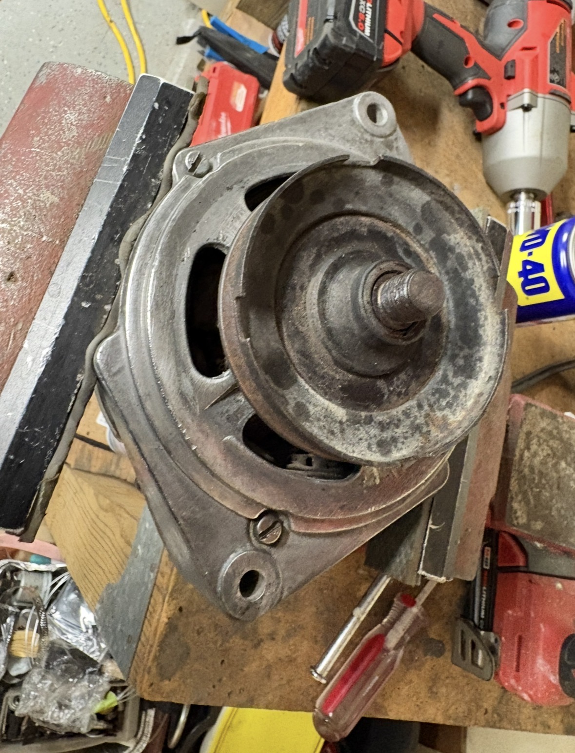

Anyone know a trick on how to remove the pulley from an alternator? Doing the Juice-heat-juice… but it ain’t working for me yet. Got the nut and washer off with a high speed impact but nothing is moving the pulley. TIA.

You’re probably going to have to get the pulley hotter. I’d use a gear puller and heat the center of the pulley with a torch. I’d start by soaking it for a couple days with Deep Creep.
