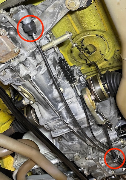

1. Is the transaxle side of the speedometer cable meant to have a boot? I have seen one on a couple of cars that seem very original (photo from BaT, not my car). I don't see it listed in parts catalog. I bought a new speedo cable. It came with a boot for the firewall side. Nothing for the transaxle side.

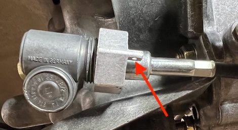

2. The nut on the speedo cable has a couple tabs and small holes. Almost like safety wire holes. Do they have a purpose?

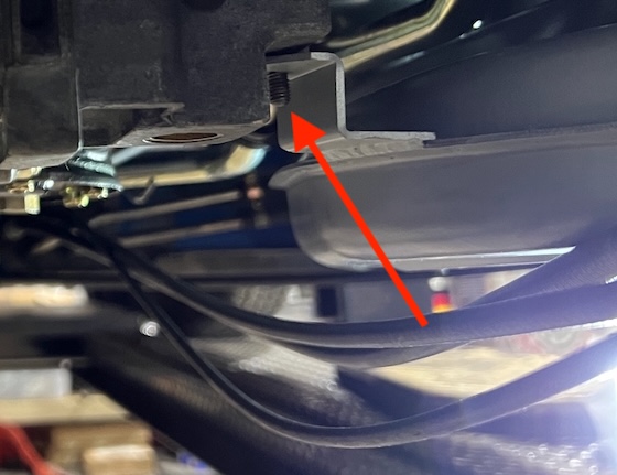

3. Is the clamp that holds the speedo, clutch, and accelerator cables something special? I could not find a way to orient a common Norma clamp to attach to the bracket in a way that is oriented for the cable direction. The clamp opening would be running perpendicular, instead of parallel to the cable run.

I personally have never seen a rubber boot on the angle drive nut. However, the
diagrams seem to show it as part of the cable (single part #) so maybe it only came
on stock cables produced back then.
Also the nuts I have used never had tabs.
For the clamping of all the 3 cables, this picture is how I have used the clamp with
a small aluminum extender. The stud was removed in favor of short bolt. You may
need to alter this because I am obviously using headers here. I also put some slit old
fuel lines around cables for more protection.

Correct OEM speedo cables have not been available for years .
The originals had a different alloy nut with a rim to hold a proper boot.
Same for 914 6 clutch cables which were larger dameter cable than those for
four cyl cars.

Rory is correct, Original cable ends had wingnut type and a rubber boot
Does anyone have a close up photo of the clamp as originally found on a 914-6? The part number (999-511-076-02) appears to be a standard Norma 18 clamp, but there's no way that's fitting in there.
I've looked through several mostly original cars on BaT, but can't find a close up view of this area to determine what that clamp looks like or how it's attached. Maybe the shape of the tab on new Dansk heat exchanger isn't correct?
