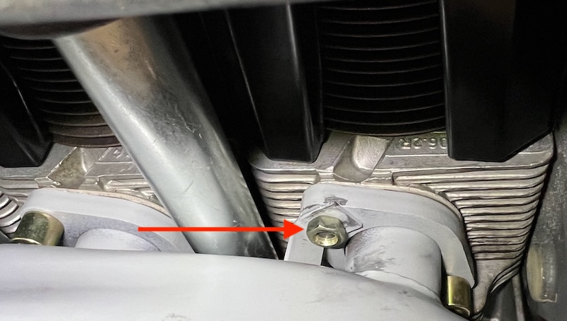

What have you found or fabricated to tighten the 13 ATF hex nut on 914-6 heat exchanger passenger side? I think that's cylinder number 1.
I'm sure this is probably mechanics 101, but I'm having a hard time with it. I've tried every combination of 1/4 socket, u-joint, wobble extender, flex driver I can find. No room for a box or open end wrench as 2 sides are blocked by bracket and pipe. Nothing I've tried provides enough engagement to properly tighten it.

Hi Dennis, Yeah there is a special wrench that is bent kind of like a Z that allows you to get in there and tighten that nut with ease. Good luck, Michael (IMG:style_emoticons/default/beerchug.gif)

SSI included either a 12mm or 13mm z shaped wrench with their replacement exchangers. Maybe ask around. I have used 12mm across the flats nuts and seems to make it easier.

The support strap needs the hole slotted so it can move away , If you insist on a 13mm hex.. and your studs short..
(IMG:style_emoticons/default/agree.gif) Thats going to fail.

Sadly yes (IMG:style_emoticons/default/agree.gif) ,not enough thread to support the hex nuts or the barrel nuts if all studs are the same ,well prior to fitting my exhaust I removed one bad one and ordered 12 new studs from Pelican , length was spot on .
The only fix I can see is to restud the heads ..don't think there is any other solution .

Yea, unless that’s some sort of optical illusion, you’re going to have to fix that.

(IMG:style_emoticons/default/ohmy.gif) That is an interesting idea. Wasn't aware of these. Only the copper exhaust nuts which I think are 12 mm ATF and I was planning to transition to.
QUOTE(sixnotfour @ Aug 20 2026, 11:14 AM) *
Thanks for pointing that out. I believe that's an optical illusion because I haven't tightened the nuts before taking that photo. At least I hope that's the case.
I've learned a painful lesson during this project. Never trust the stud height on anything. I would have liked to think that a highly rated machine shop would have caught / corrected these things, since they would have had to remove and reinstall in many cases, but clearly not. It has bitten me a couple time now. Too short on the intake side and I had to replace them all. One of the barrel nuts on the exhaust side was too long and I could only torque it to 10 ft. lbs. before the wrench hit the stud.

Are all the studs the same lenght? The one puctured is too short.
Why is the piece of metal under the nut?
