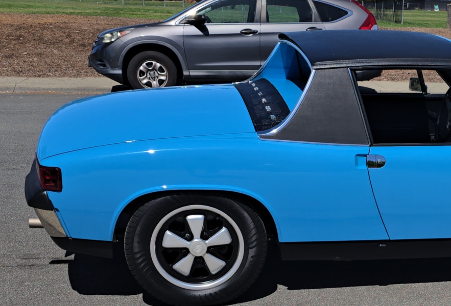

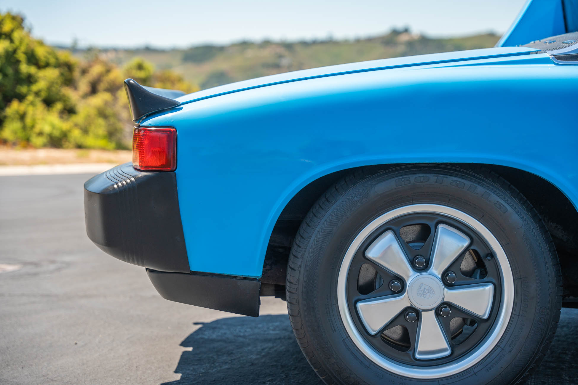

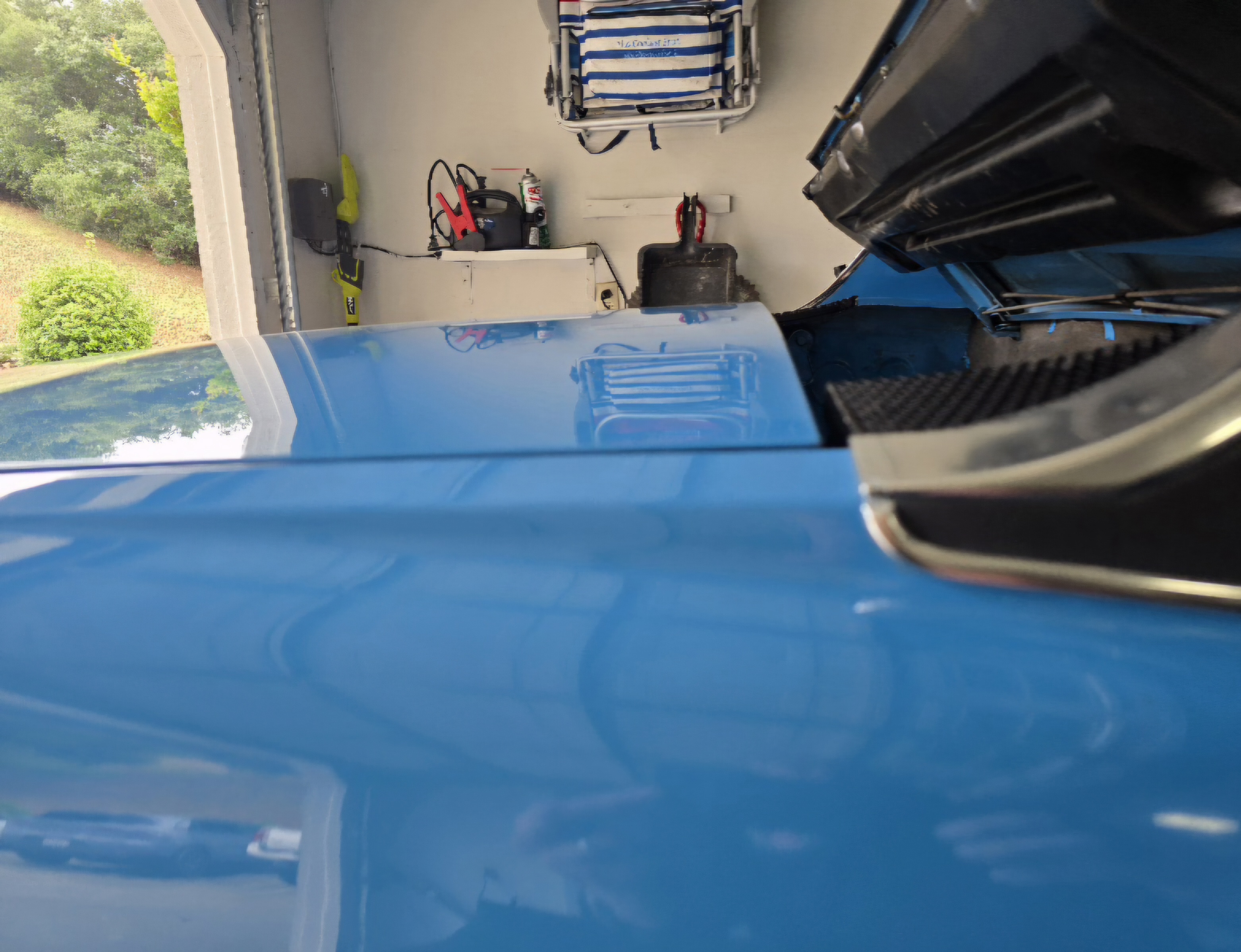

I had to do my passenger side about a year ago when I bought my car. I created a spring tool from a 10" crescent wrench. Not the 8"... use the 10".
The first time I did it the motor was in the car. My hinge was in the same shape as the one above so I went jwest on it. I managed to get it almost perfect, but it needed to go down and back about 1/4 of an inch. I perfected the install when my motor was out. Holy Cow was that 100xs easier with the motor out. I almost did the driver's side at the same time, but I figured if it ain't broke...
YMMV
When I bought it:
Almost perfect:
Today (after being able to adjust it from 'in' the engine bay:
Hard to tell the difference but it matches the drivers side. One is OEM the other is Jwest.
