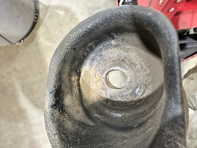

> Is this trailing arm bracket toast?

Hole is elongated. I could weld it up and re-drill if needed.
HFC3
post Jul 18 2026, 06:54 PM
Posts: 101
Joined: 14-December 25
From: Virginia
Member No.: 29,151
There’s certainly people on here that could have that welded it up and then re-drill it.
That hole obviously needs to be dead nuts. I believe that is the one set point on the trailing arm that has no adjustment.

QUOTE(HFC3 @ Jul 18 2026, 06:54 PM) *
Unless you want some "adjustment". I might have known people who might have gotten more camber in near-stock race 914s by "moving" the hole.

@burlybryan
date='Jul 18 2026, 02:49 PM' post='3265550']
[/quote]
Replace it.
Which side is it?
Can you show a whole picture of it?
I have a few..
