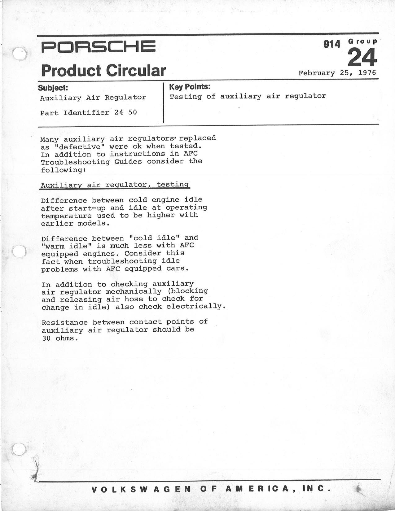

here is porsche's (or is that VW?) own tech document re the AAV on L jets.
issued in 76 when the cars were only 1-2 years old.
(document from the marvel of the marvelous Jeff Bowlsby website).
its not issued in relation to D jet cars, at that time L jet was termed AFC injection.
not a strong start from cold when new and it just gets worse with age.
where are we now, thats right, half a fricken century down the track. (IMG:style_emoticons/default/biggrin.gif) (IMG:style_emoticons/default/beerchug.gif) (IMG:style_emoticons/default/beer.gif)
L-Jet914
post Jul 18 2026, 01:45 PM
Posts: 417
Joined: 24-October 12
From: Davis, CA
Member No.: 15,080
QUOTE(wonkipop @ Jul 17 2026, 11:55 PM) *
I actually wish we had a high idle circuit for warm up like the D-jets and modern cars have today. The vehicle would warm up faster in my opinion. But I guess Bosch knew better with the early AFC haha.
