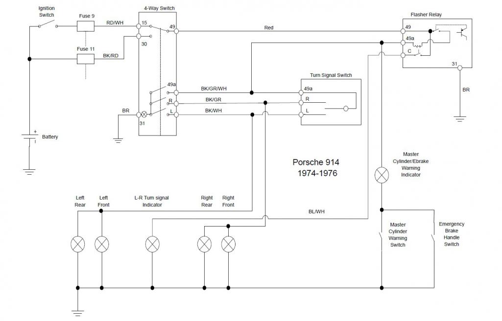

Spoke
post Jul 17 2026, 10:59 AM
Jerry
Posts: 7,418
Joined: 29-October 04
From: Allentown, PA
Member No.: 3,031
This is a simplified schematic of the turnsignal system in the later 914's.
The hazard switch is very simple. Power comes in at 15 or 30 and out 49 to the flasher relay.
To flash all 4 corners when pulled the switch connects 49a from the relay to both L and R sides. This also lights up the bulb in the switch.
