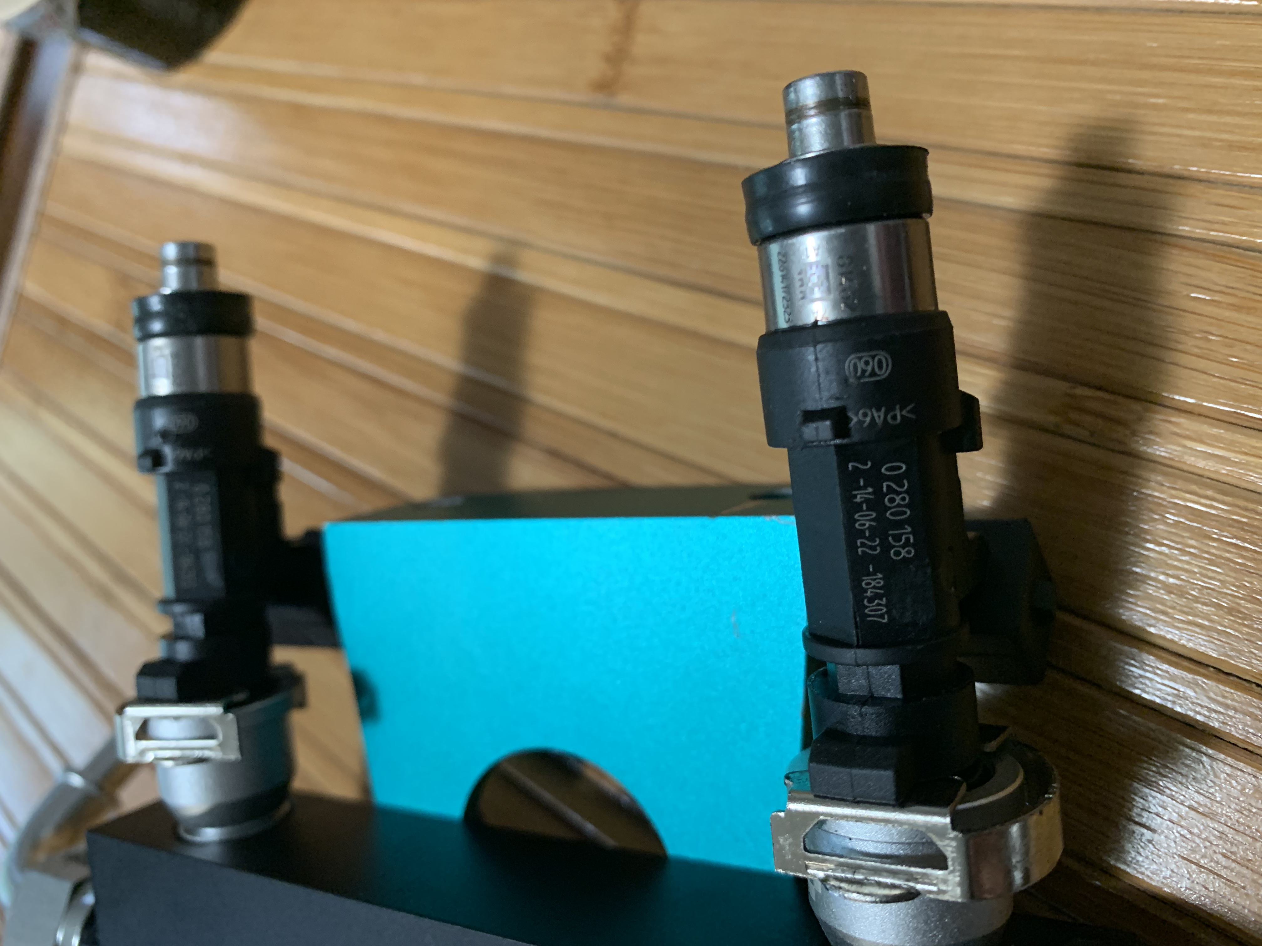

Has anyone had experience/ success with the billet rails and the”ev14” plug and play system for 74 2.0 from Injector Rehab ? Does this stuff require some other modification as mine clearly doesn’t work. (IMG:style_emoticons/default/headbang.gif)

What part of the setup isn't working specifically? I notice one difference in the injector installation of yours vs Injector Rehab is that they have the part that receives the electrical connector orientated at about 80? degrees or so with reference to the runner, whereas yours is pretty much in parallel. I know @914Sixer was working on this setup a few years back. Maybe he has some input?

It’s not the fitment they fit perfect and the injectors can be rotated easily… the car will not start with these installed

Are those high impedance or low impedance injectors? What is your engine management system?

Stock 74 2.0

You will have to change the injector plug ends to match the new injector is what I was told. You can have these, need your shipping info.

The stock ones plug in fine (IMG:style_emoticons/default/confused24.gif)

Does anyone know what all the numbers represent I know the 0280-158 but don’t know the pressure or flow rate … I believe they are too much flow??
