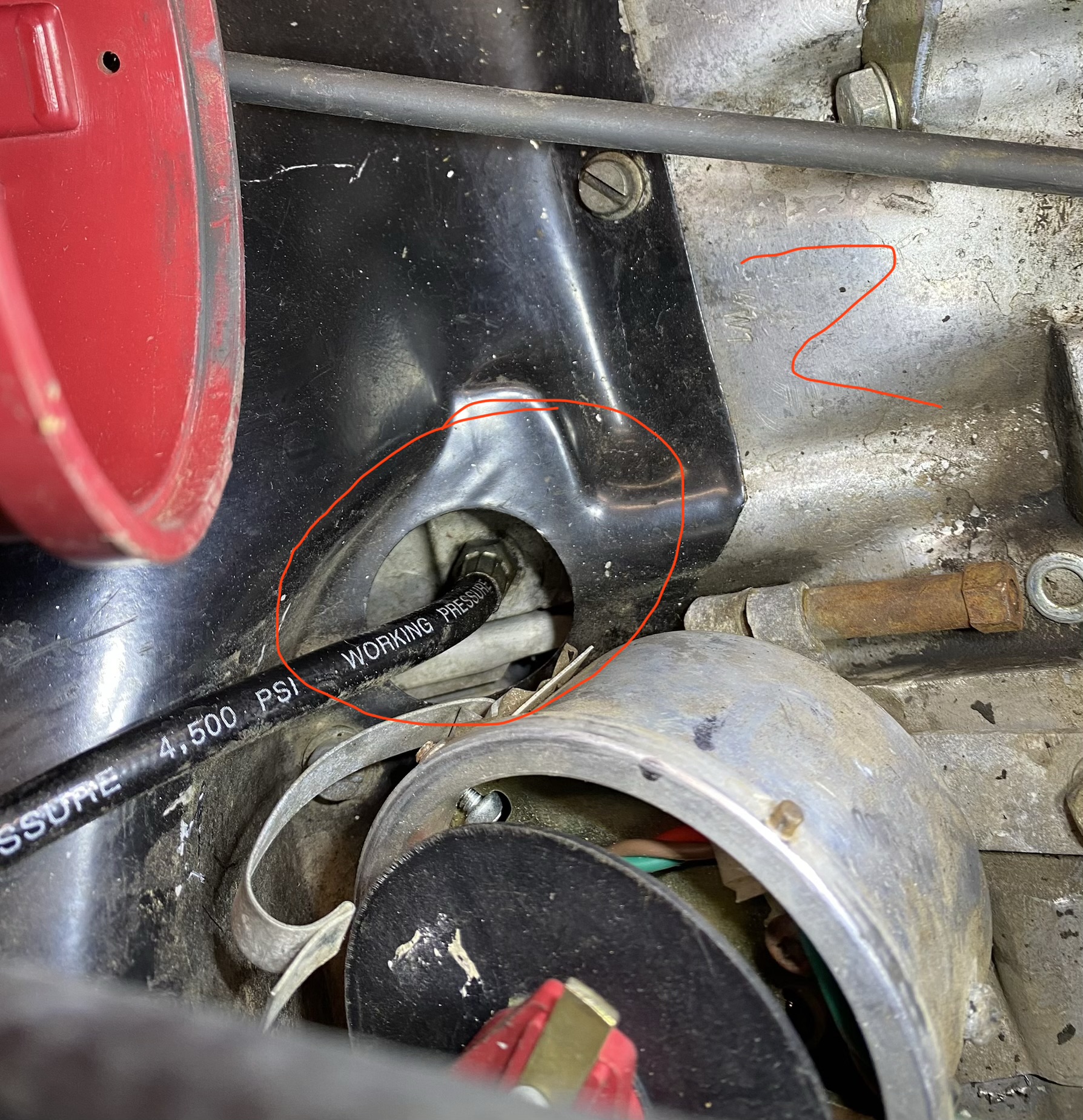

Pic 1. Replacement engine with sensor.

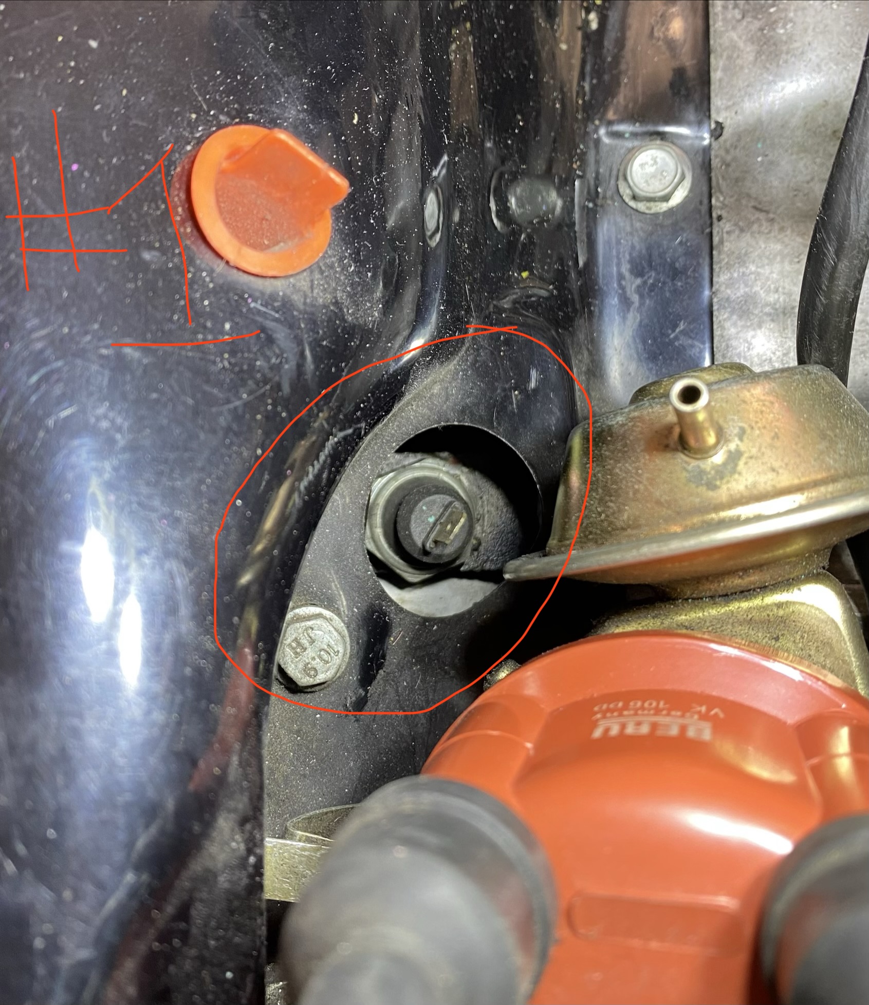

Pic 2. Original engine with oil pressure

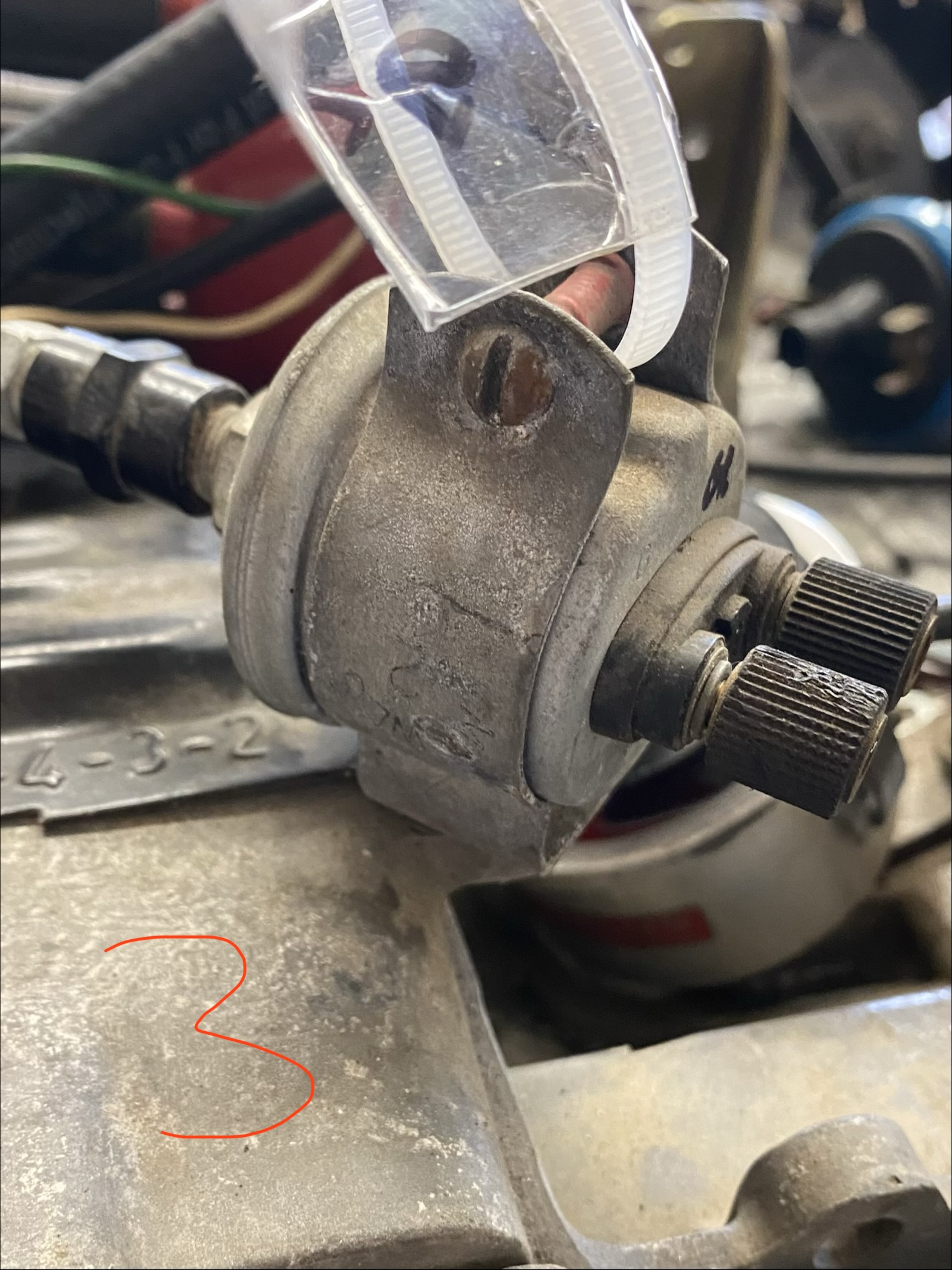

Pic 3. Original engine sending unit (?)
Original engine in picture number one and number two. Oil pressure sensor next to the distributor.
The replacement engine I have only has an engine temperature sensor? in the same spot.

Pic 3

I simply insert a T fitting on a short hose (as shown), one side to the case, one to the factory idiot light and the other to a copper line into the cockpit for an actual gauge
