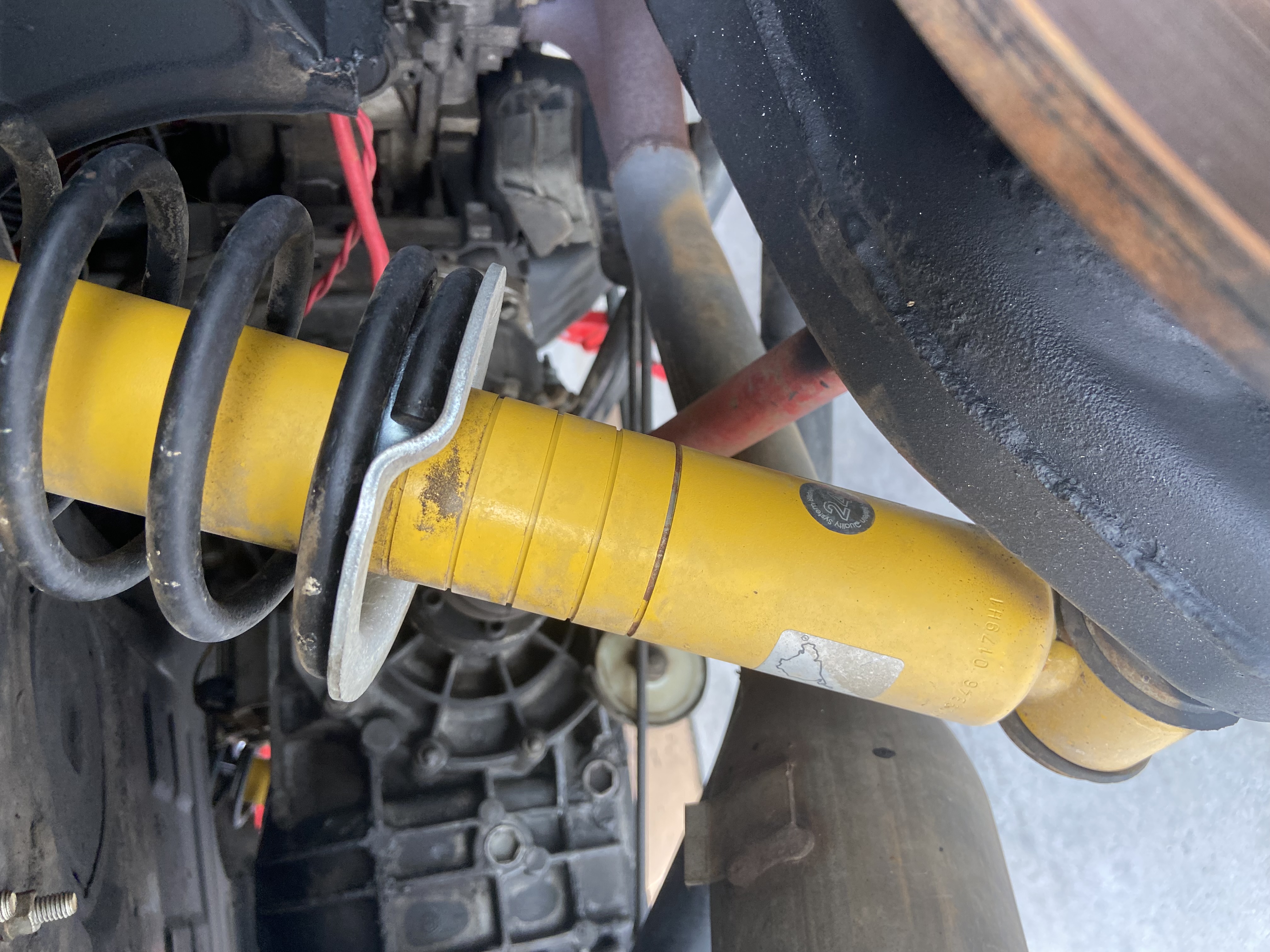

I have these coilovers on the rear of the car.
https://cart.bilsteinus.com/shock-24-001793.html
The drives side is almost 2" lower than the passenger side.
Both are on the 6th or top adjustment with the circlip installed.
Could this be a coil issue or a shock issue?
Any Ideas as to how to adjust these???

Coils can lose their spring over time. Sometimes unequally. Might be time for a new set.

Do you feel it's the coils or the shocks?
Or both??
