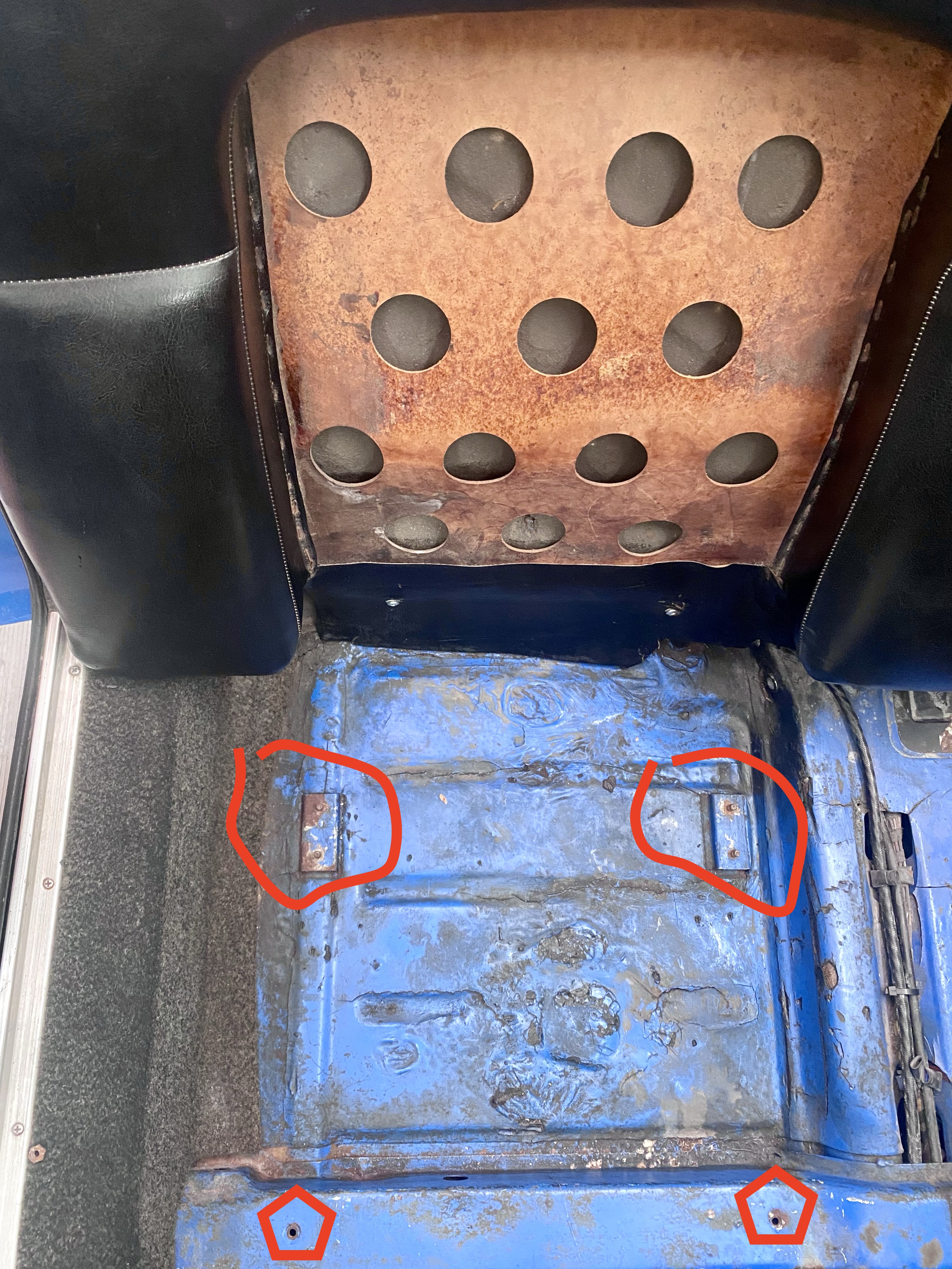

I'm in the process of recovering my seats. The fiberglass passenger bucket has three holes on both sides of the base. Does it bolt directly to the floor? No brackets? I can't remember how it came out of the car. Seems weird to bolt it directly to the floor?

The fiberglass base is held to the floor by (4) small studs on the floor pan and 2 small bolts on the cross member. Here is a 6 with the attachment points circled.
I believe both are M6 fasteners as I recall.

Yep. Directly to the floor. I just put mine back last weekend.
@aturboman memory is correct. M6 nuts qty 4. M6 x15 bolts qty 2 (900 075 193 08). Plus washers.
I think you will want to place your vinyl floor covering for the tunnel, door sills, and front seat rail before you install the backpad or seat bottom.
