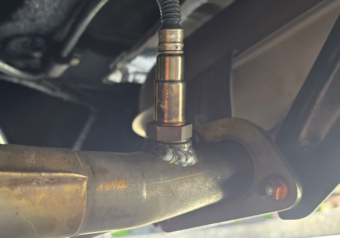

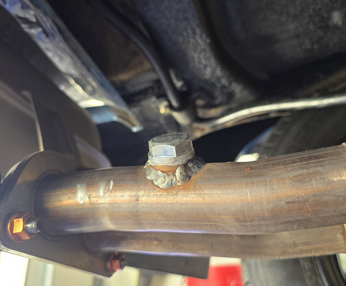

I have rhe PE Wideband Bluetooth O2 setup. I installed a bung in the #1 and #3 exhaust header / heat exchanger tubes, about 4" back from the muffler flange. I put the bung at 10 or 2 o'clock so that condensation wouldn't foul the sensor.
I dunno, looks about right to me. Works well. (IMG:style_emoticons/default/smile.gif)
