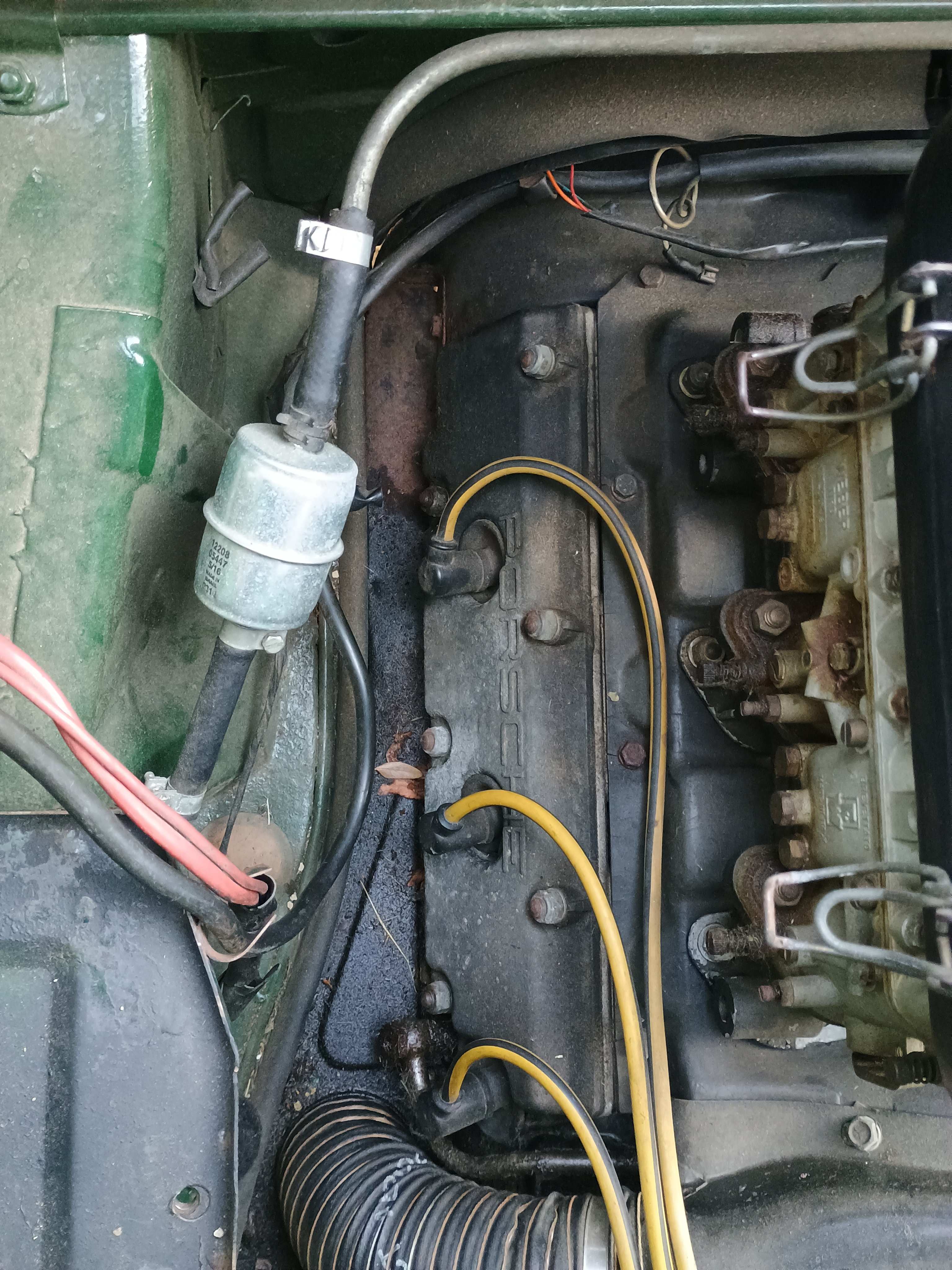

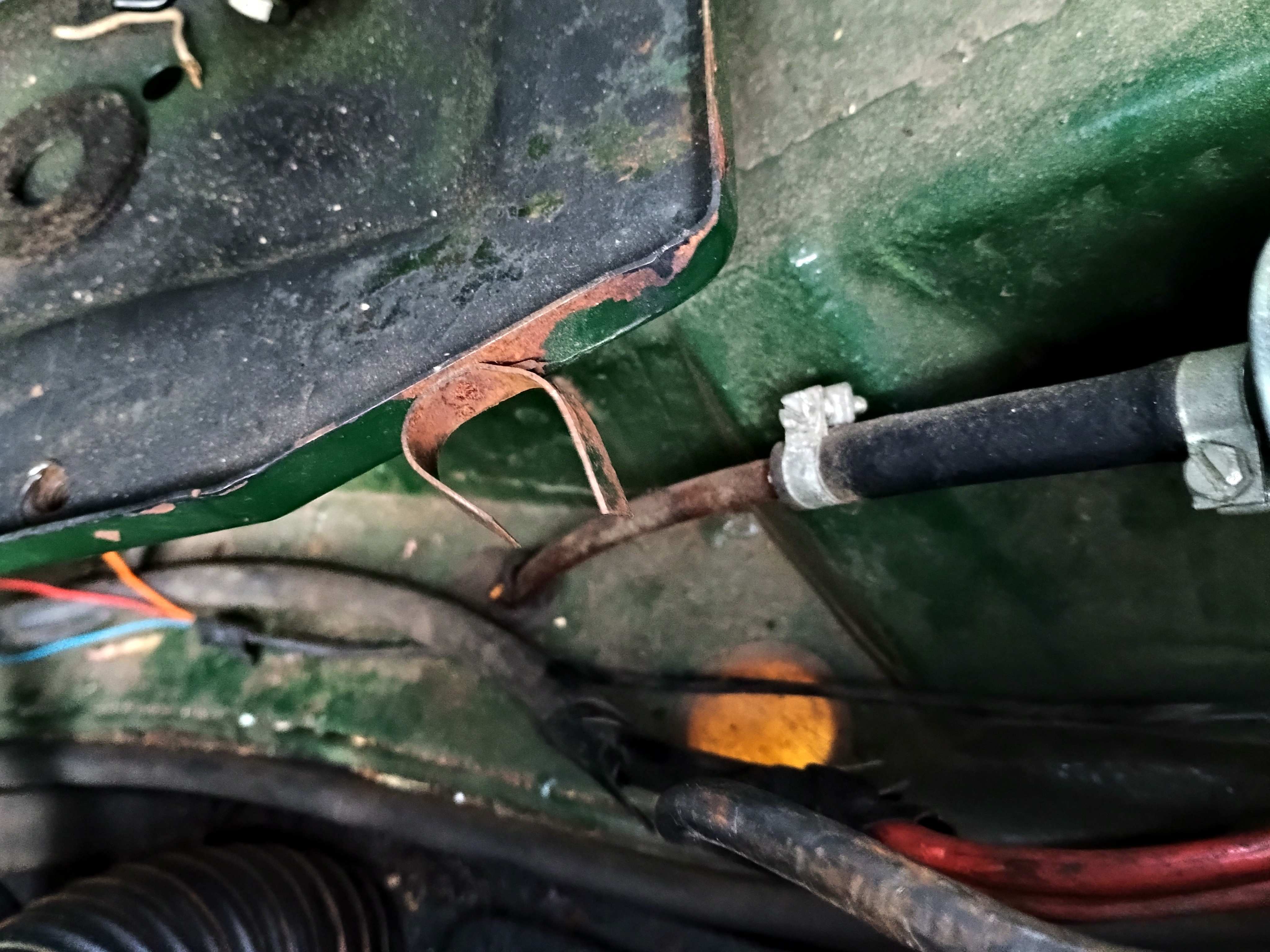

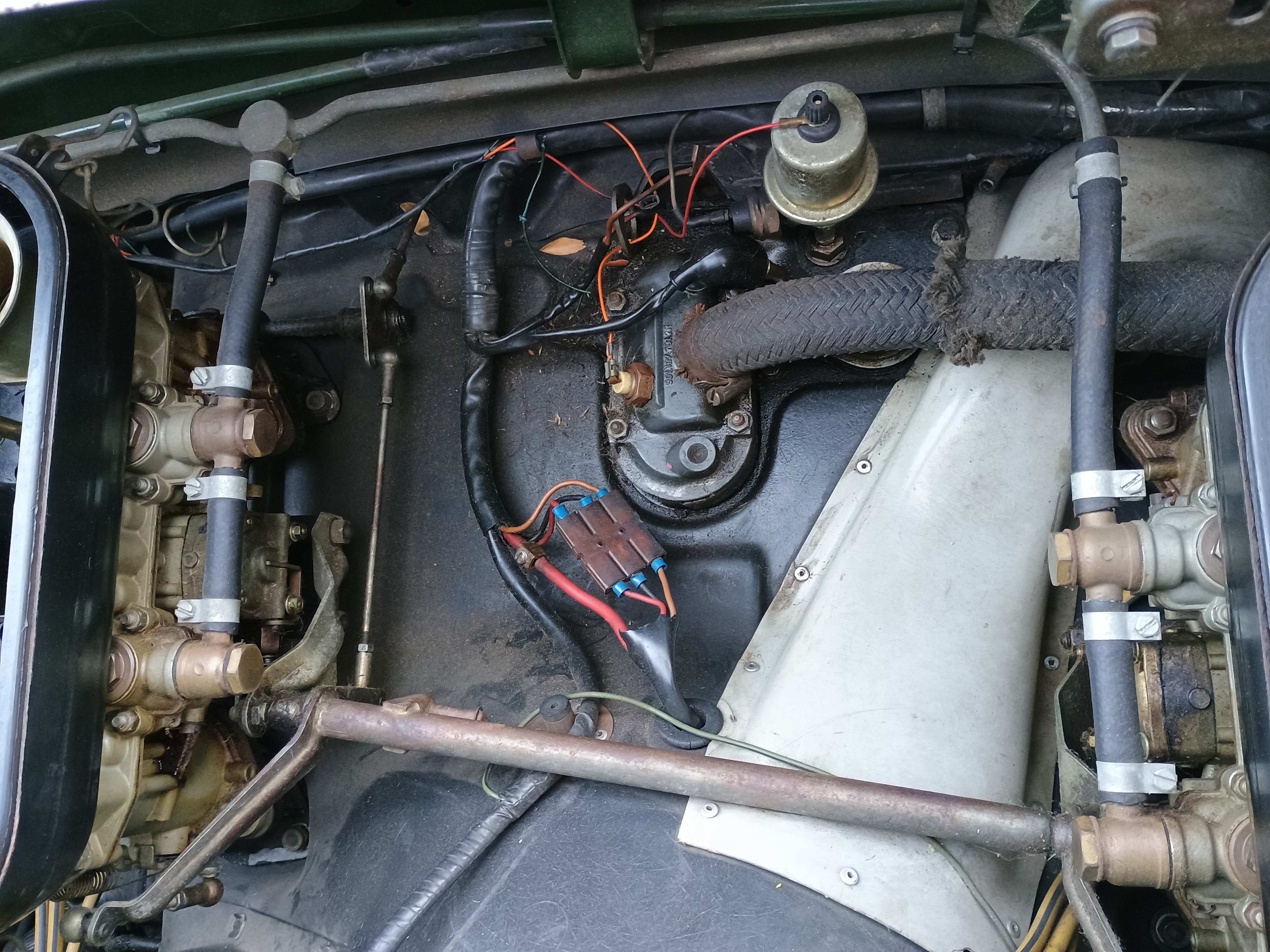

Like this? Cold start valve connection removed a long time ago.

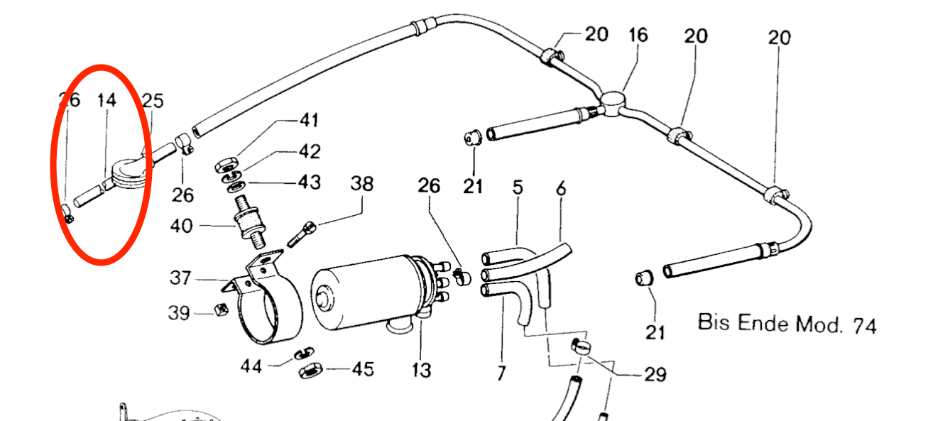

QUOTE(fixer34 @ May 23 2026, 12:54 PM) *
That is helpful. Thank you.
Your first photo I assume is #14 from the parts catalog. Is that the only hard line other than the fuel rail and what comes through the tunnel?

QUOTE(DennisV @ May 23 2026, 03:10 PM) *
I hope I oriented these through the tunnel correctly, as they are different diameter. Were a bit of a hassle to install through the grommets.
That line #14 is original on mine; actually I'm not even sure if it is metal or nylon. I can check tomorrow.
Interesting the diagram doesn't show the 'T' for the cold start. Maybe the engineers wanted to erase that idea...
