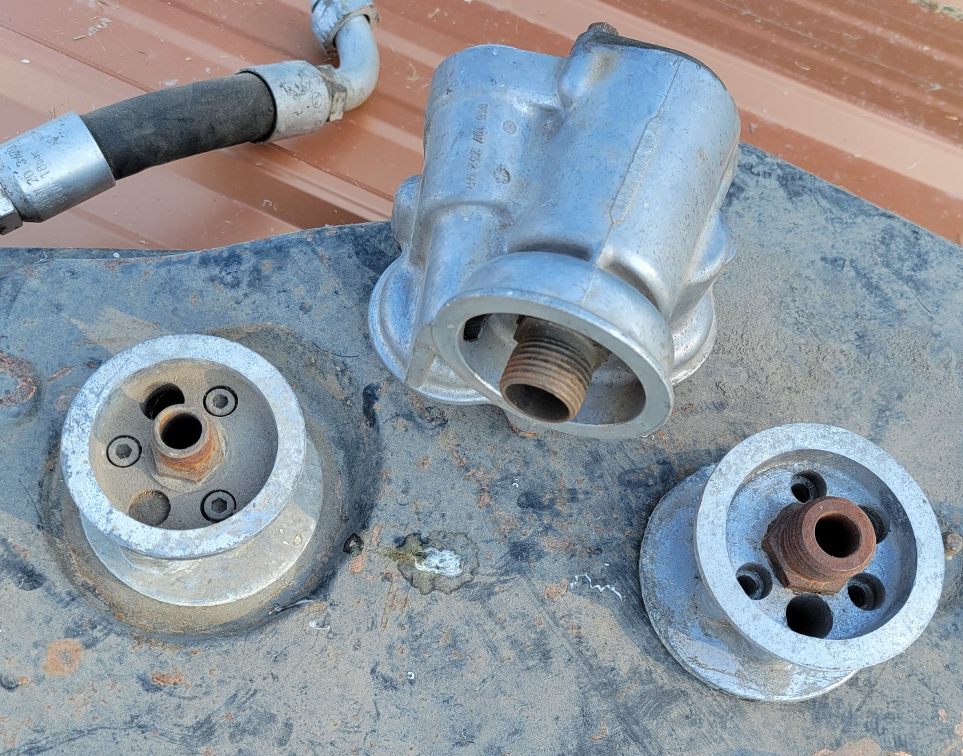

The factory did use the larger console but only for 1 or 2 years. They then went to the oil tanks that had the filter mount made into the tanks. I don't recall if you could just swap out the fittings to take the larger filter. The console maybe wider for the filter ?
I have both consoles so I'll take a look to confirm.
