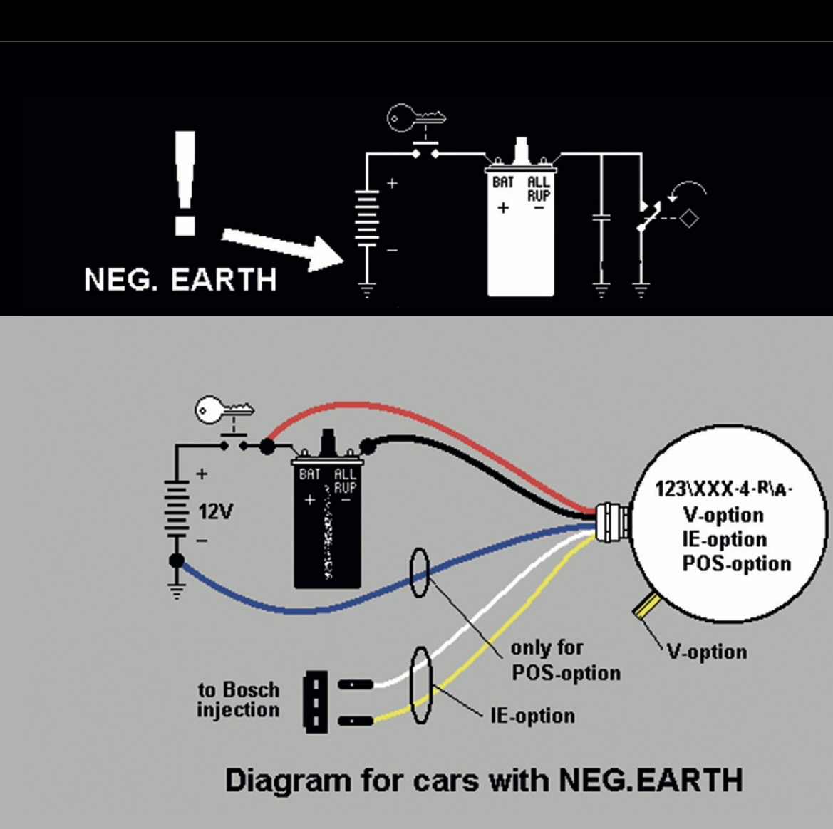

Let’s just put the 123 dizzy schematic here for clarity.
For clarity I’m going to assume the 123 dizzy you have isn’t the POS option and doesn’t even have the blue wire. Similarly assuming that since your carbed, there are no wires for fuel injection trigger points.
