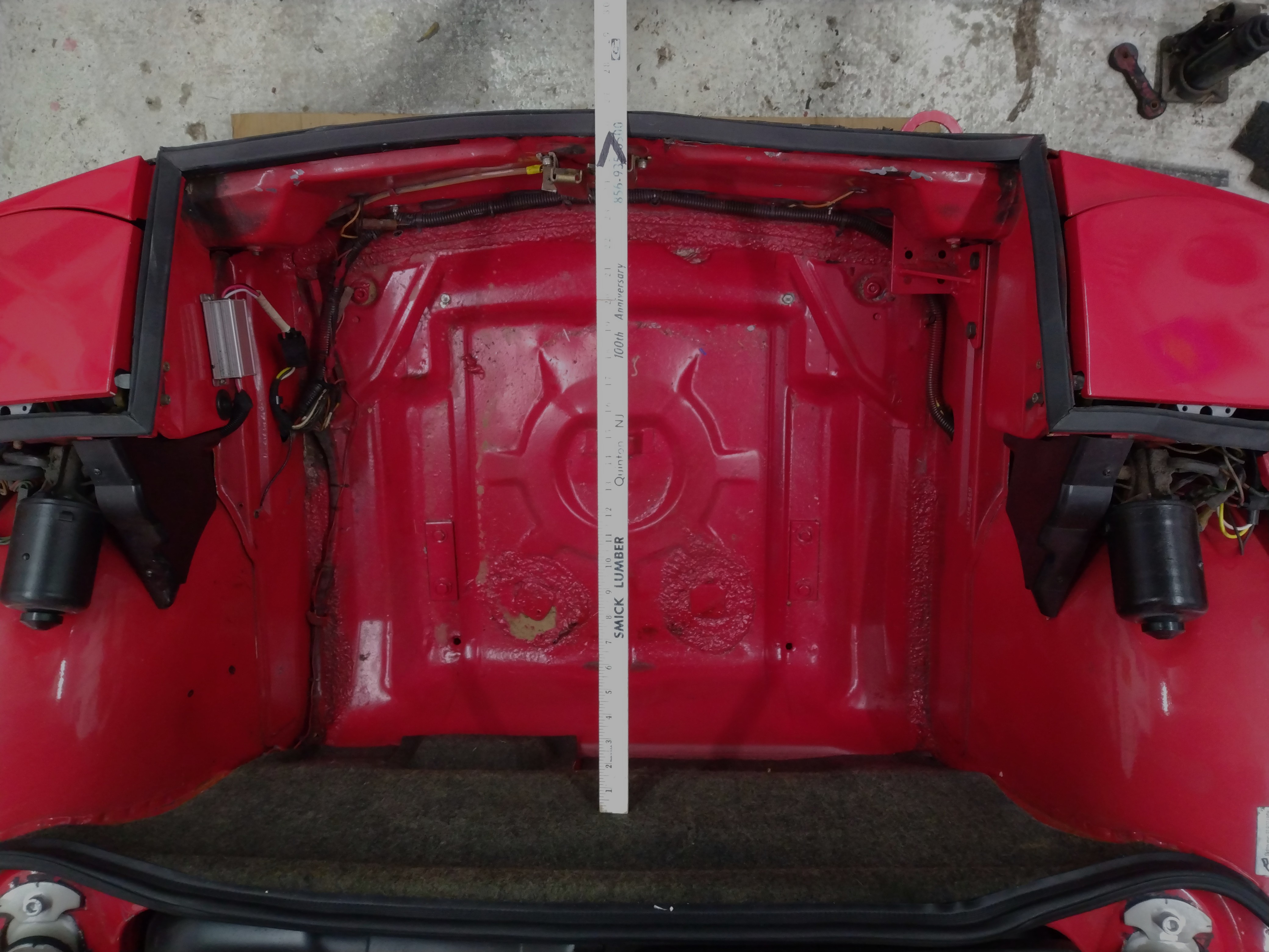

Can someone give me the correct measurement from the gas tank wall to the inside of the weather strip channel? Thanks
.Attached Image

http://www.914world.com/specs/bodydims.php

These are the ones I’ve found. There is also a YouTube video someone did. https://youtu.be/RYXILAHer2Y

QUOTE(Ishley @ Apr 26 2026, 09:40 AM) *
Your looking for D but measure from the trunk side of the cowl weather strip forward.
