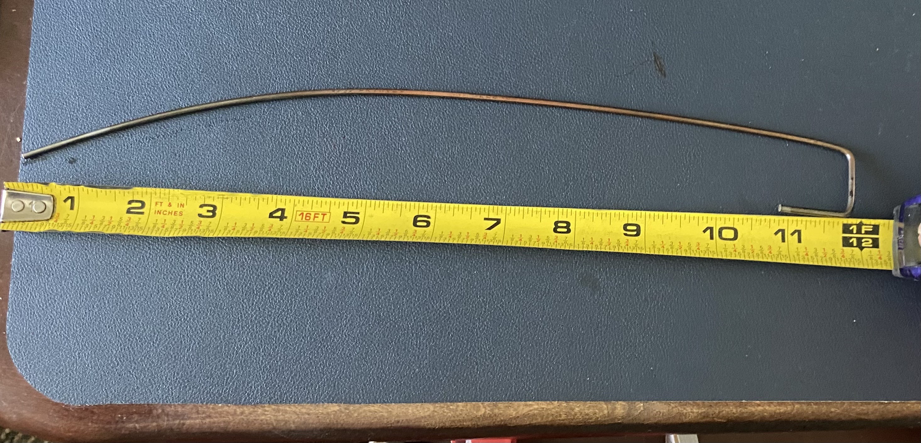

Can you get a measurement of the dipstick not including the loop? I am away from my shop, but recalling around 16 1/2" is the length of what I have

QUOTE(930cabman @ Apr 23 2026, 08:03 PM) *
Great question
I am running the aluminum oil tank from PMS (assume it's very similar) and are still looking for the answer. When I get enough oil in the tank to have anything show up on the dipstick, she smokes bad. I'm thinking the correct amount will be somewhere in the 9+/- range. Seems as though 10 is too much
Ben's dipstick. Here you go.

QUOTE(Tom1394racing @ Apr 24 2026, 11:11 AM) *
Great question
Thank you Tom, I am out of town until next week, will report back then.
