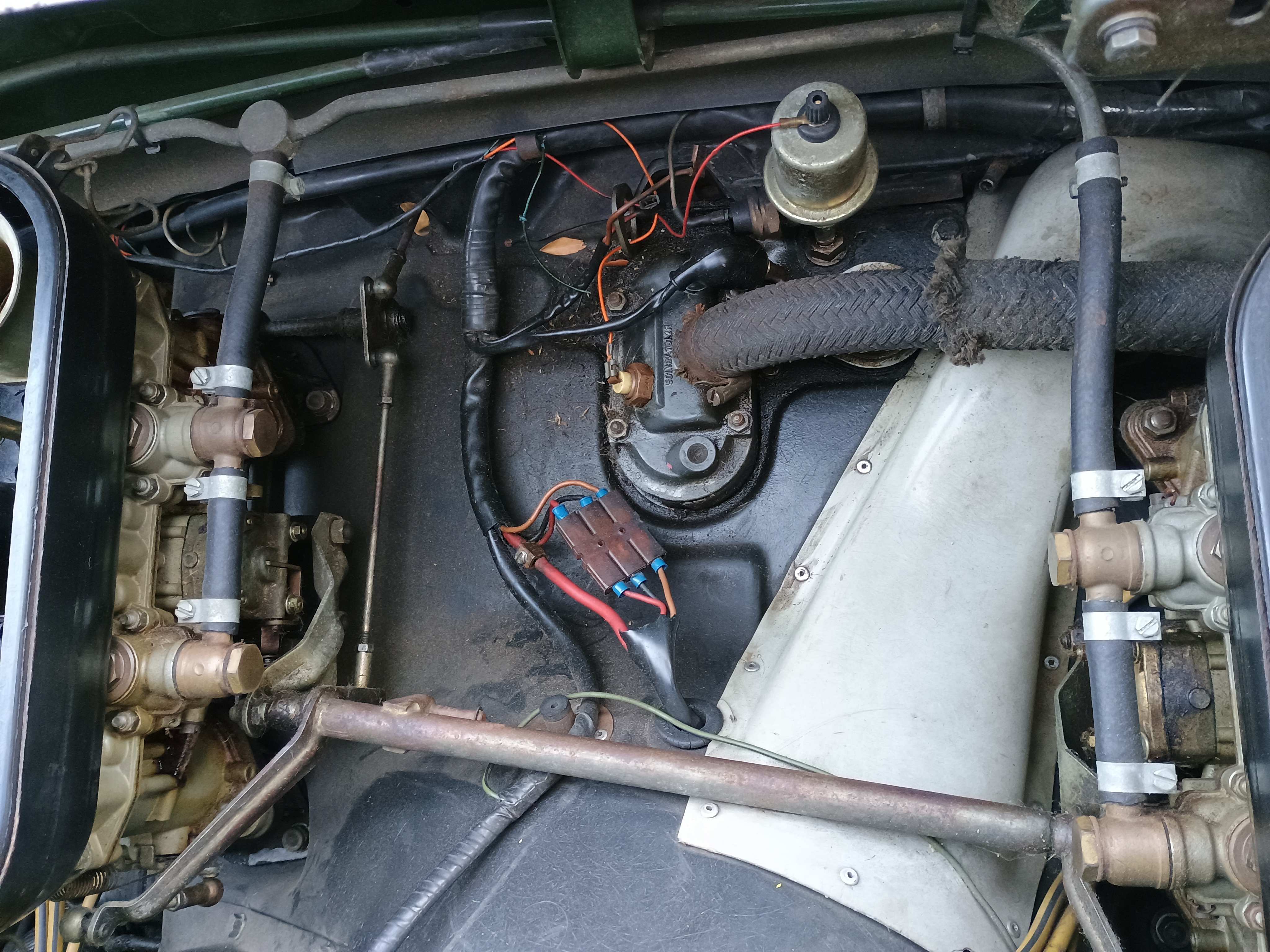

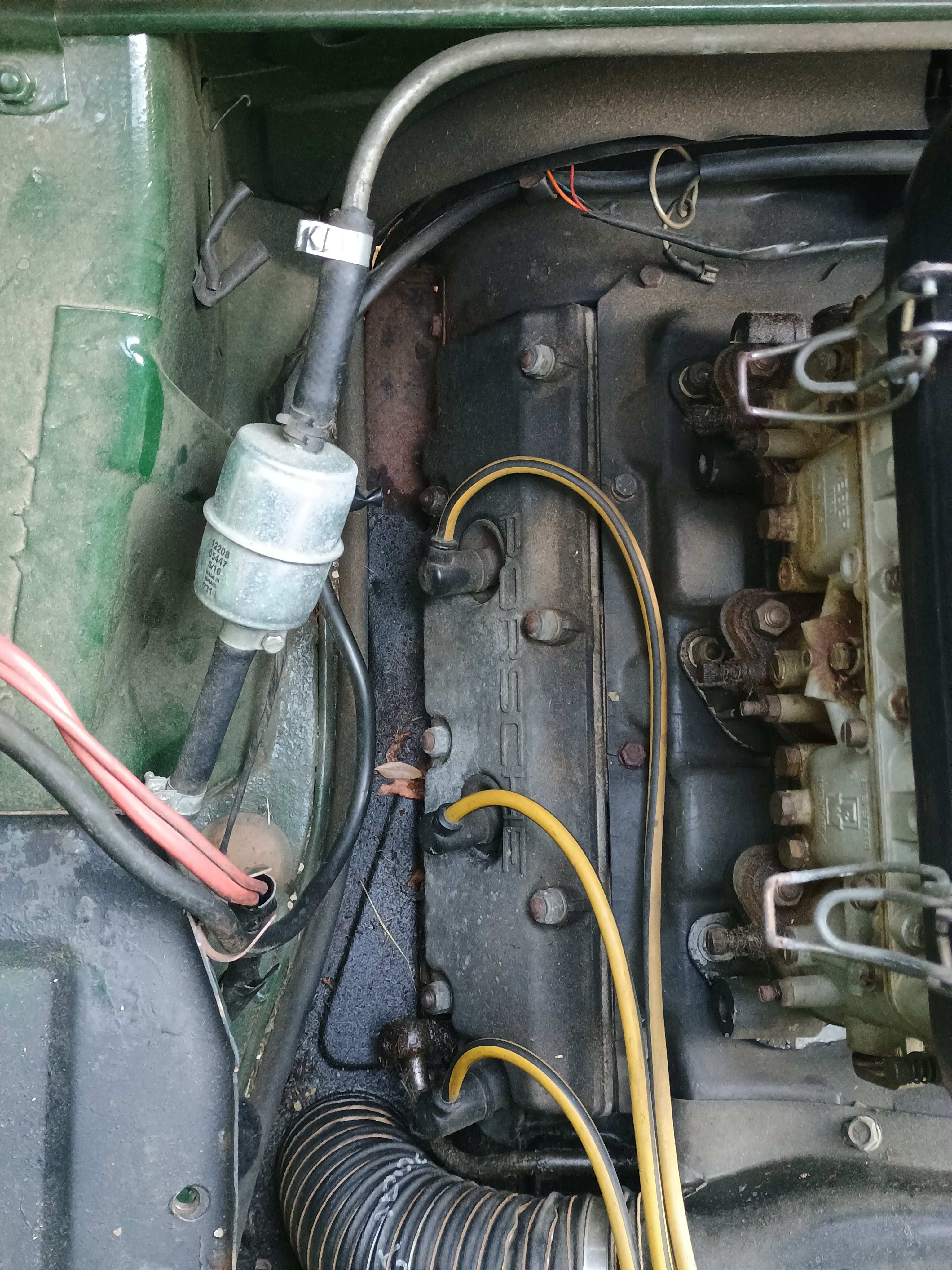

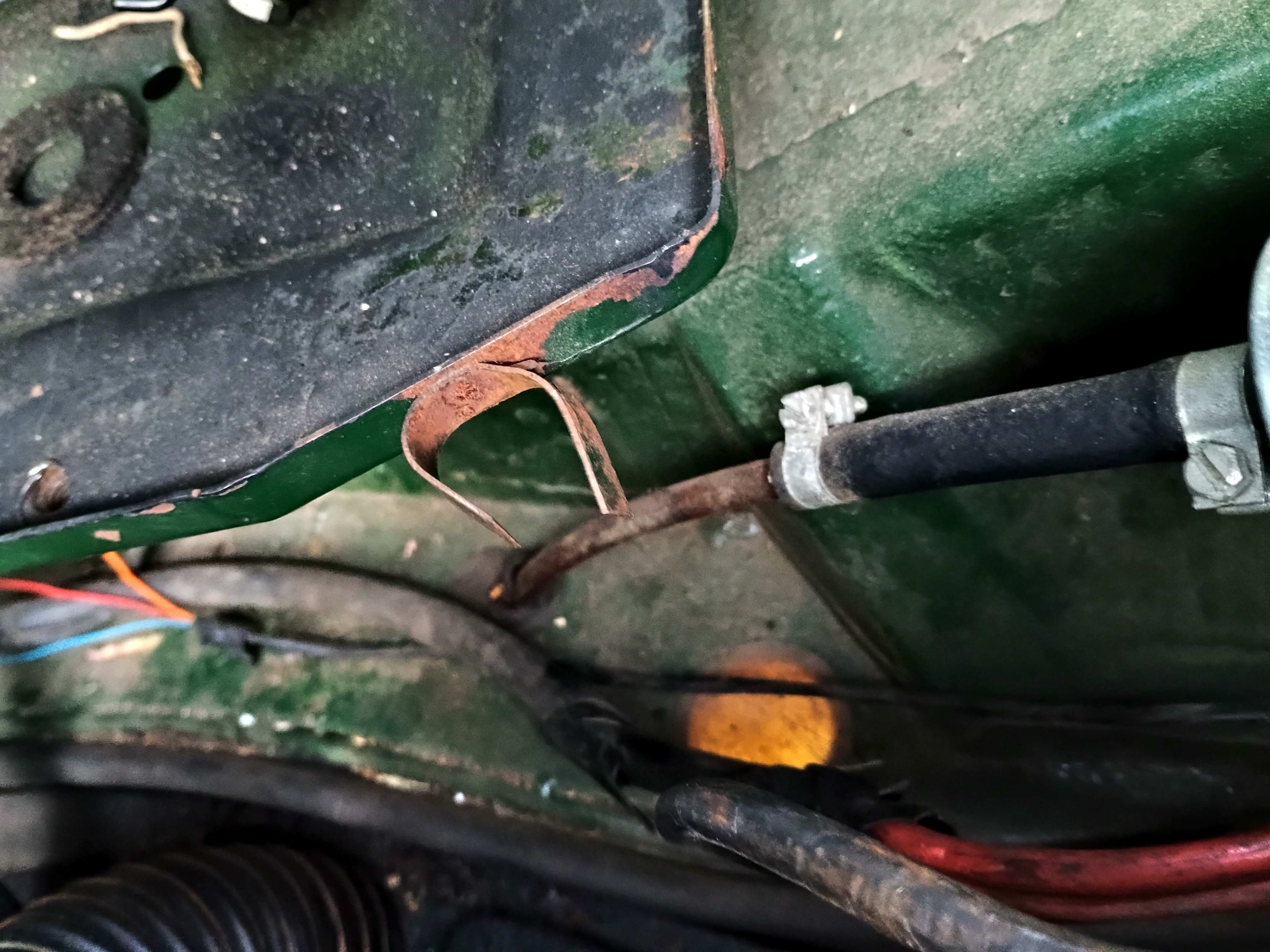

Here you go. Fuel pump underneath, to the fuel filter and fuel rail to carbs.Attached Image Attached ImageAttached Image

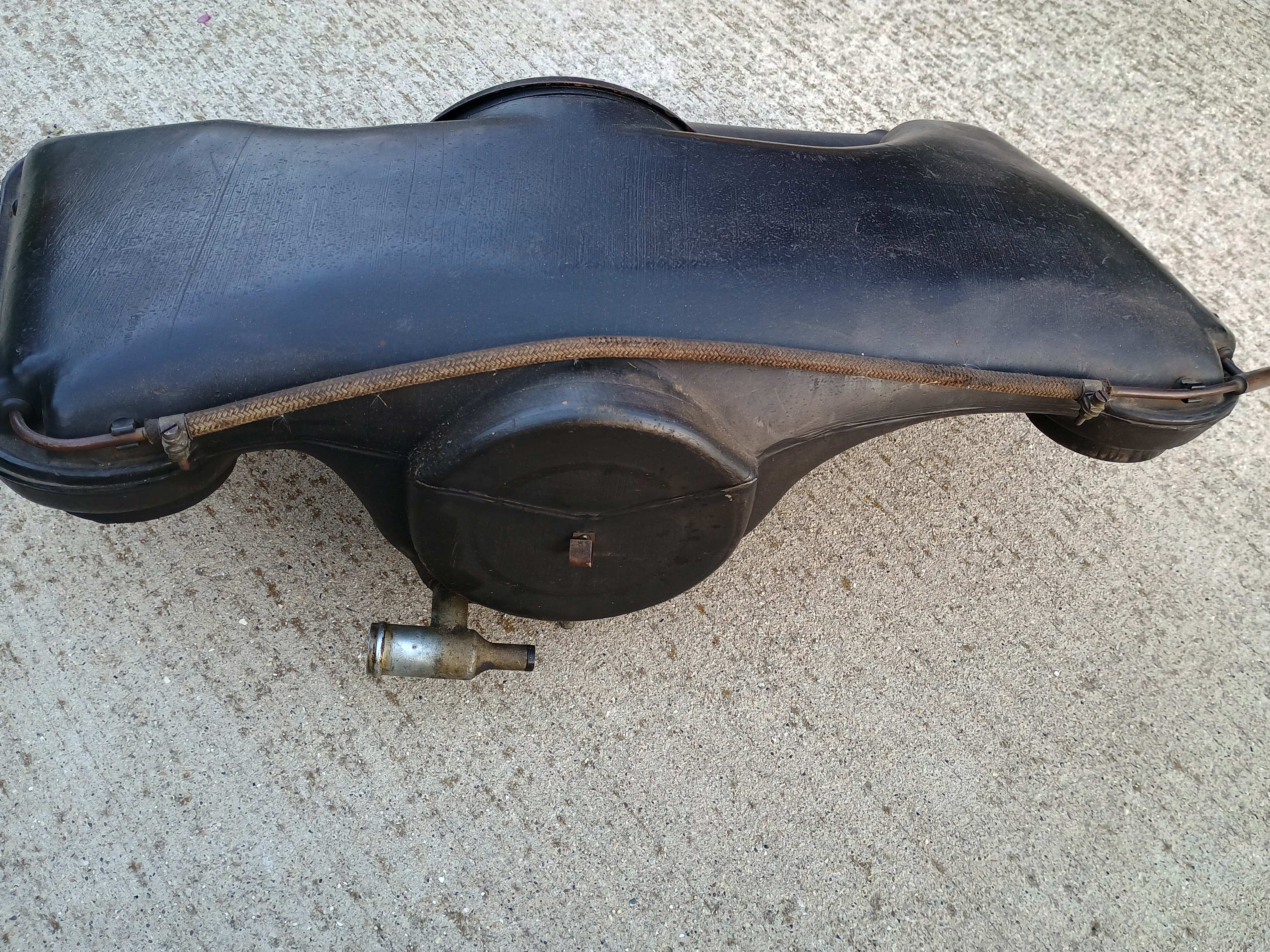

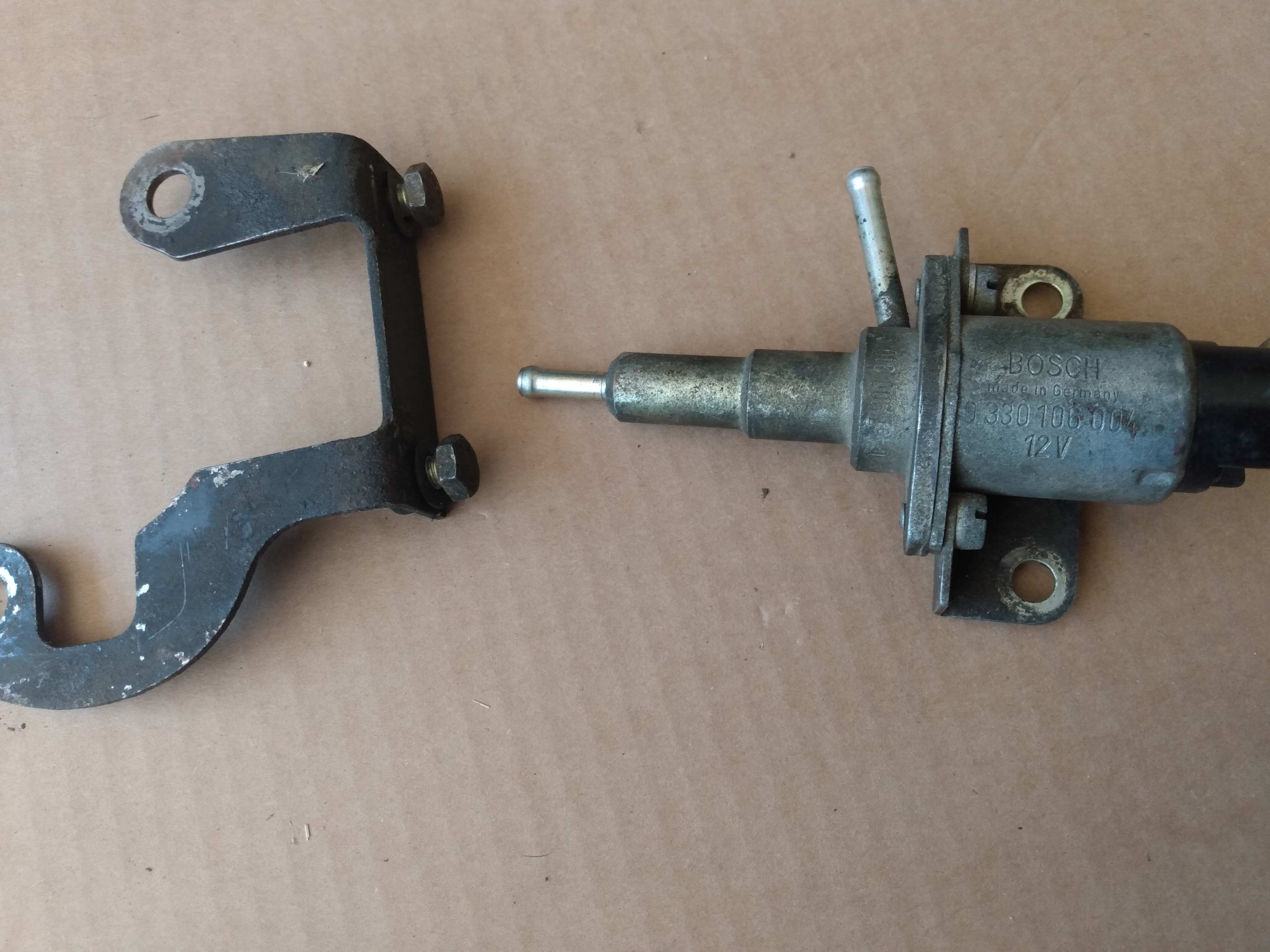

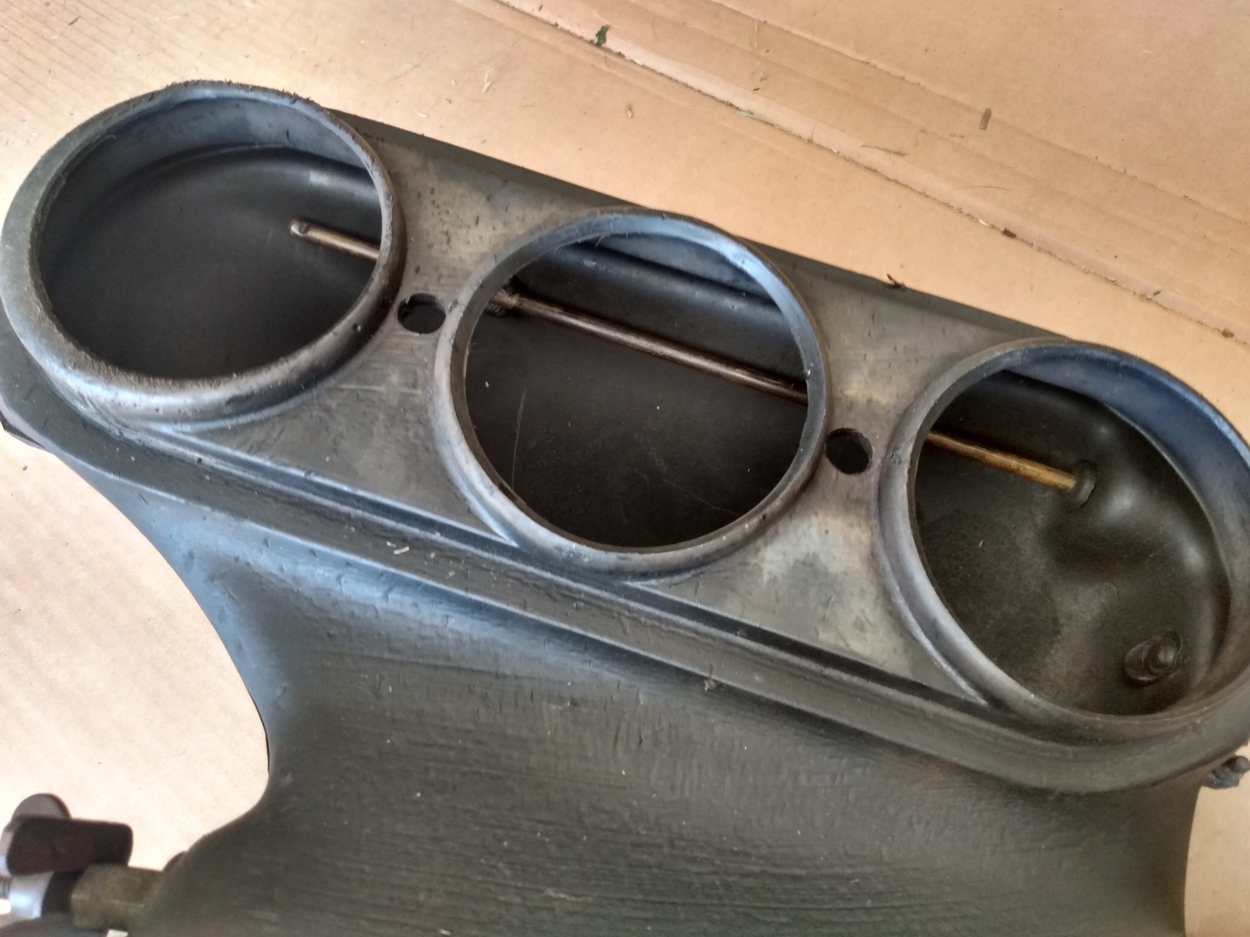

Yep, at least the very early models. 'T' into the fuel line after the filter, went to a valve that was temperature sensitive I believe and connected to the starter solenoid. That provided raw fuel to rails in the air cleaner housing that sprayed right down the carb stacks. What could possibly go wrong??

Mr Fixer came through, great shots and
(IMG:style_emoticons/default/lol-2.gif) (IMG:style_emoticons/default/piratenanner.gif)
"what could go wrong" LMAO
Recalling, I have seen this before
