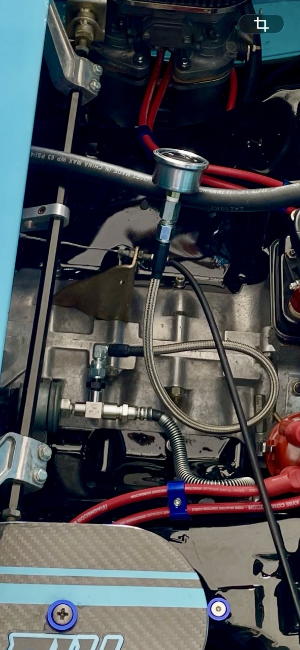

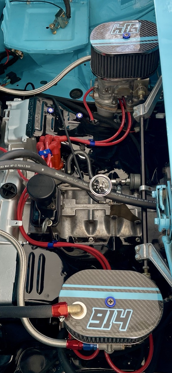

Just got my engine back in. I have a permanent gauge in the engine compartment that is ran off of a tee from the electrical gauge sender. It’s nice having the mechanical reference because my electrical gauge showed about 12 pounds of hot idle pressure, but the mechanical gauge read 18lbs.

QUOTE(Chad911sc @ Apr 7 2026, 11:07 AM) *
nice clean engine compartment. Interesting arrangement. LOVE that tuorqise!!!!
