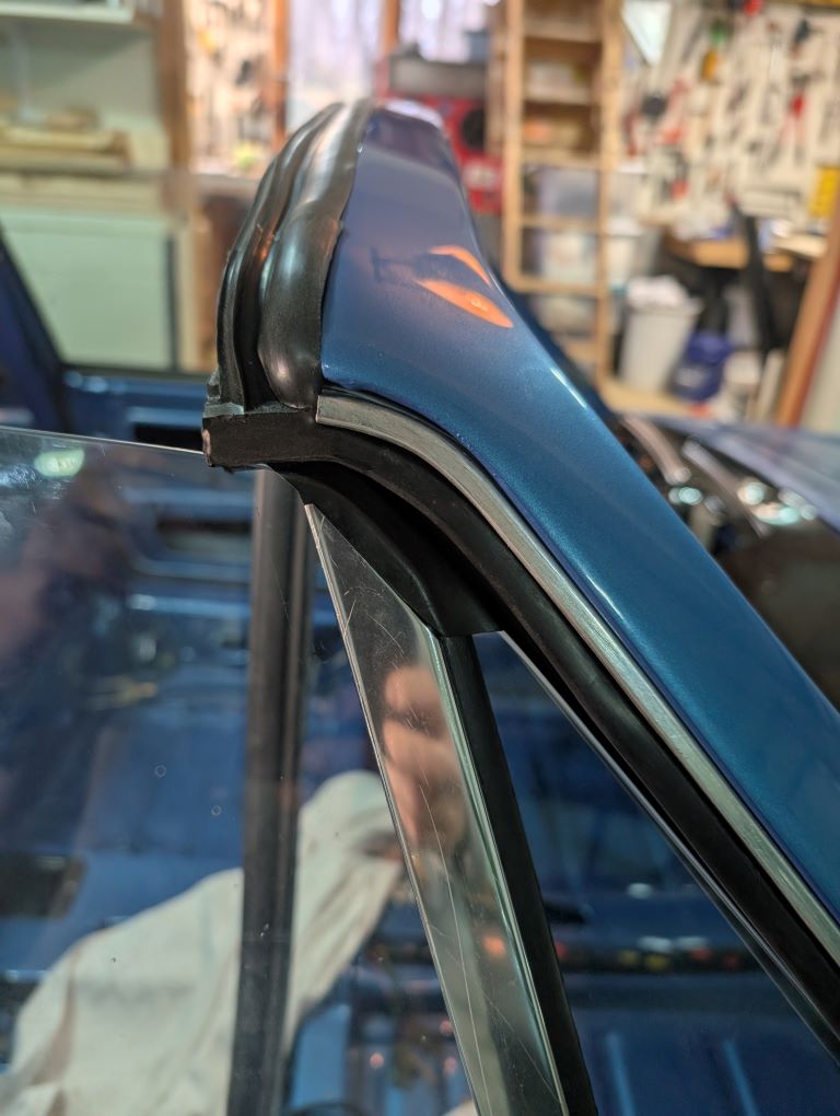

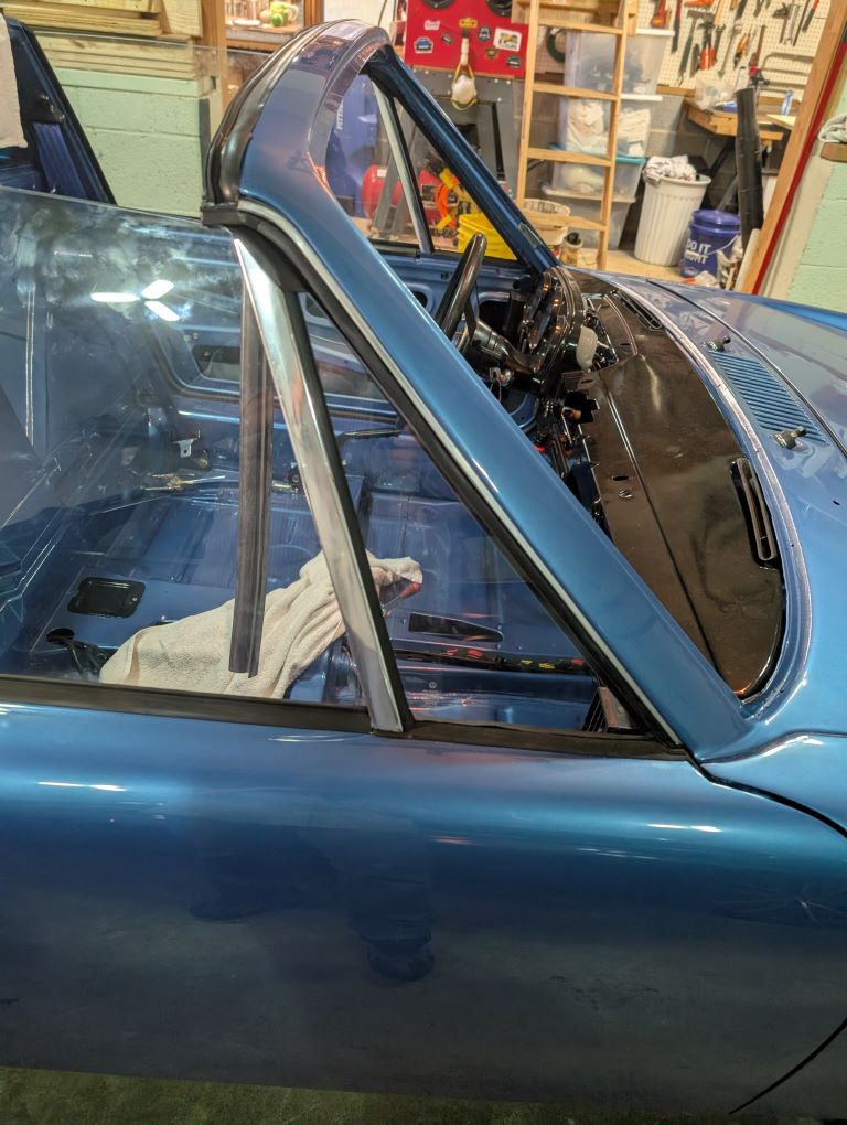

You are exactly right. I took the triangle windows out and reinstalled them several times. Finally, I realized that the triangle bracket that bolts onto the rail can adjust up or down about 1/4 inch. Mine were at the bottom forcing the rail to be 1/4 inch too high which caused the rail to lean back so that the front/bottom was too tight, and the back/top was too far away. Here is the final result!
