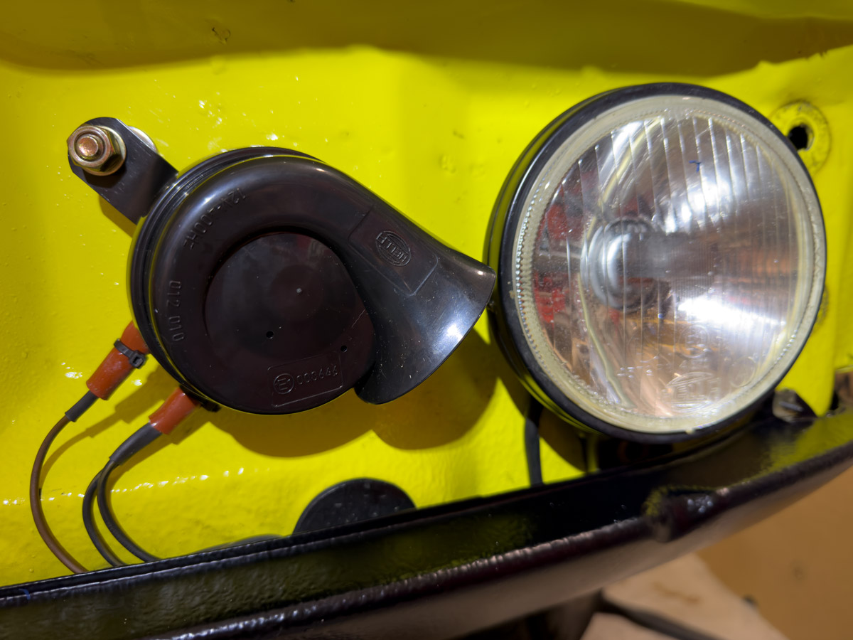

After two people made left turns in front of me I asked for a set of loud Hella horns.
This was what I got, 400hz - 500hz. Easy install. Did I mention they are loud:

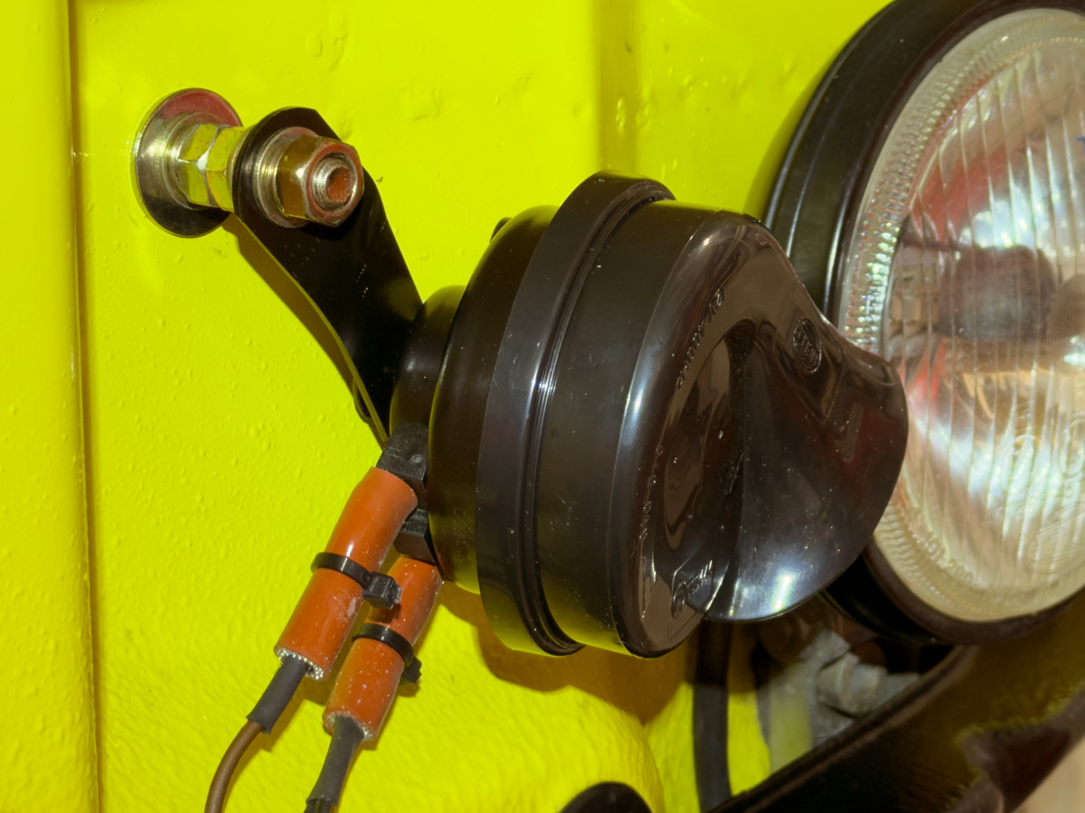

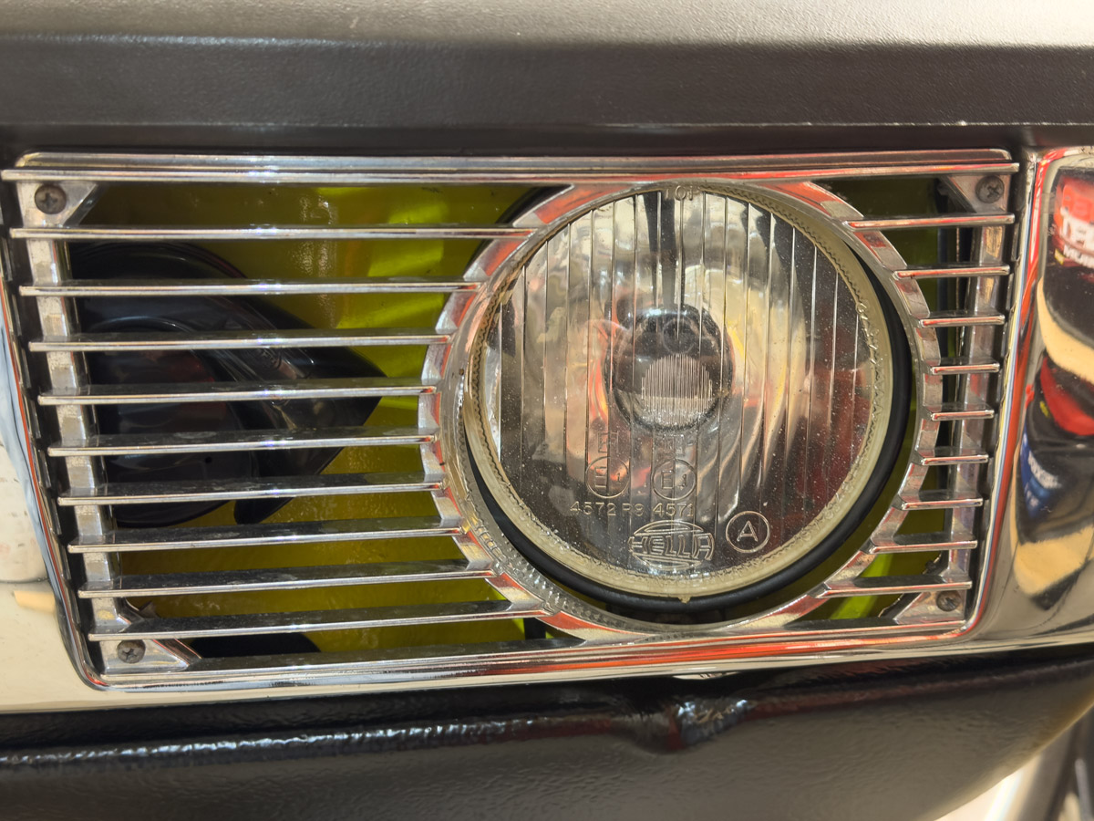

I may have posted this elsewhere, but here's how I mounted mine:
Basically a longer bolt and some nuts as a standoff and plus some bending on the bracket. They fit fine behind the grille that way. No waterproof plug available so I improvised. I didn't find them all that loud however.
The ones pictured above Hella 002-924 don't seem to be available anymore - to buy new in any case... Maybe they are louder than the ones I got, which were pretty cheap. Still looking for alternatives.
