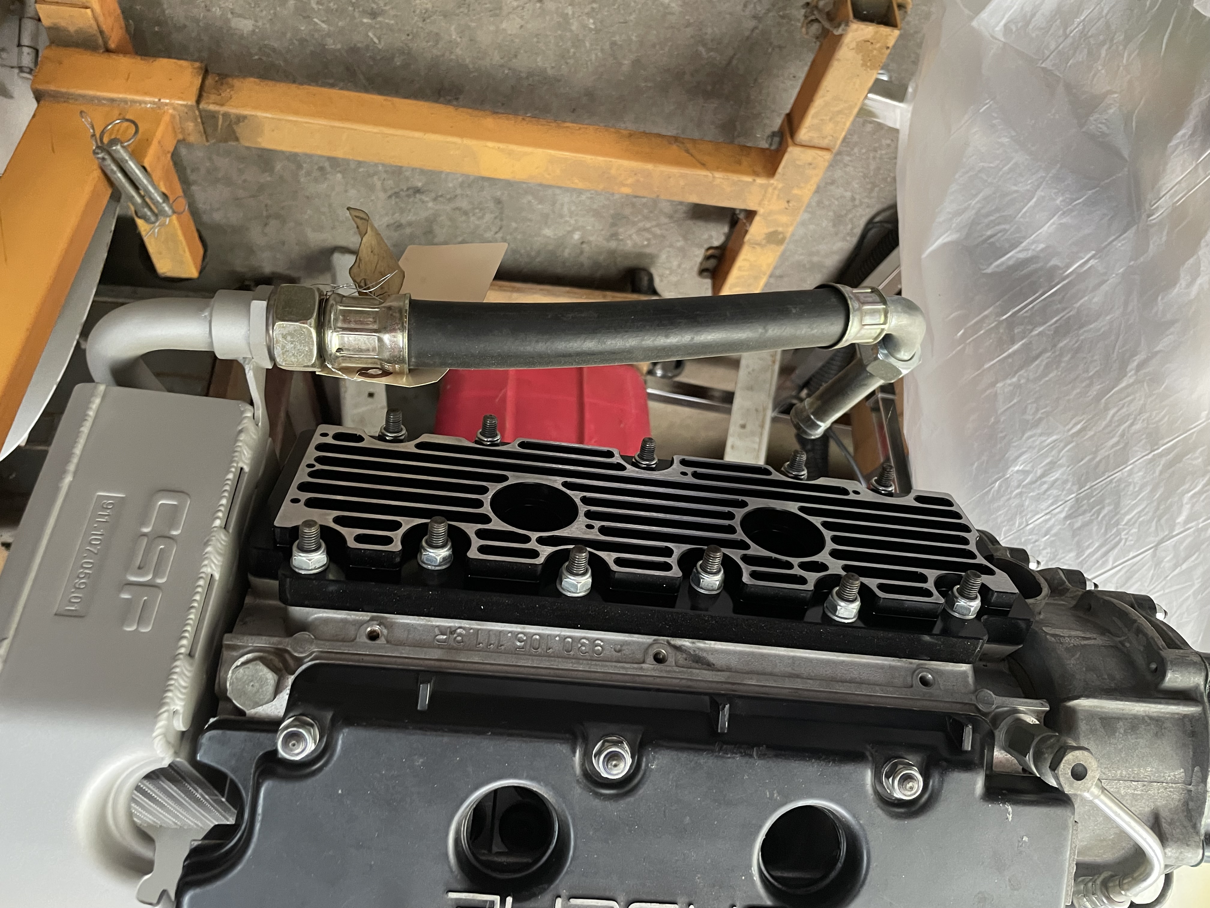

Good question, I have them installed on my 3.3, looks to me you may be able to remove 10mm from the studs and it should work. My engine is not installed so no proof of concept. I was looking for pictures of the valve cover to ear to determine if I could go coil on plug. Here’s a shot of mine if that helps. Todd

Damn, it’s upside down!..

Thanks. It's really hard to know from pics, maybe someone will need to be the
guinea pig and try it.
Which brand are those? I think there are several types that are similar.
Are those the regular studs? They look pretty long.

With those long studs, I don't think you could get the original covers off, let alone with these. If you want to go this route, bite the bullet and plan to drop the engine/trans when doing an oil change/valve adjustment.
