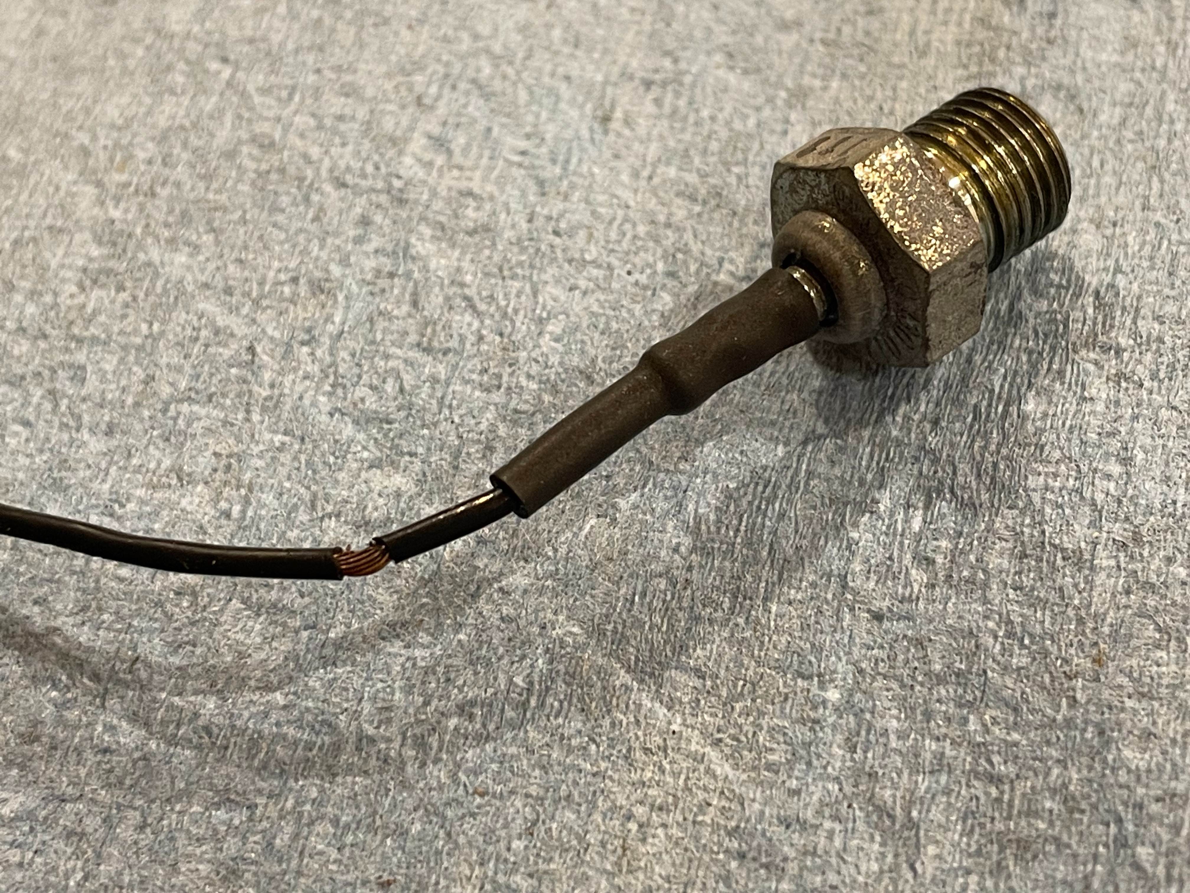

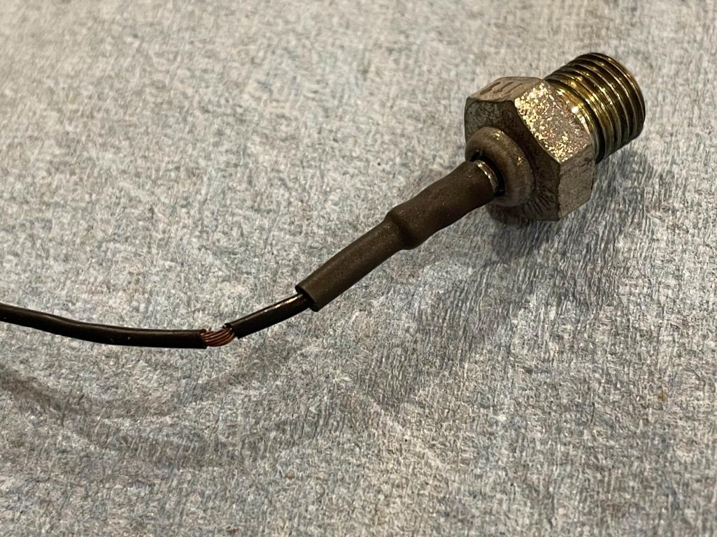

My vote is for CHT sensor. I had a similar running issue on my 75. Replaced the CHT sensor and found the old one like this. New one fixed the problem. I carry several with me now.
