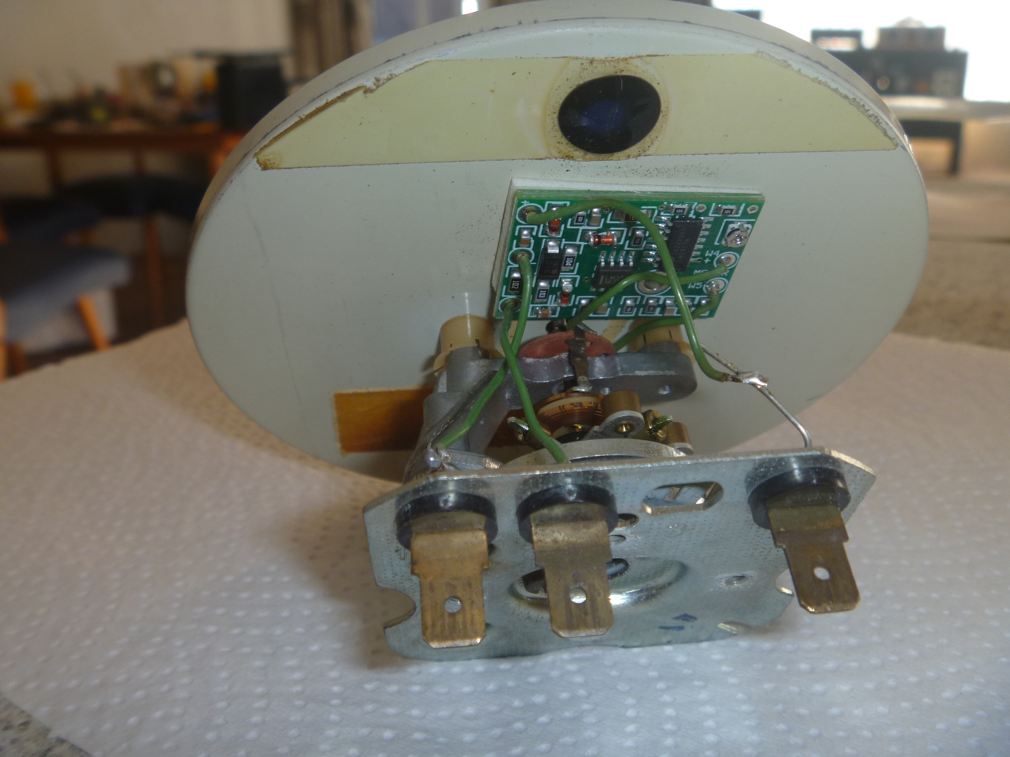

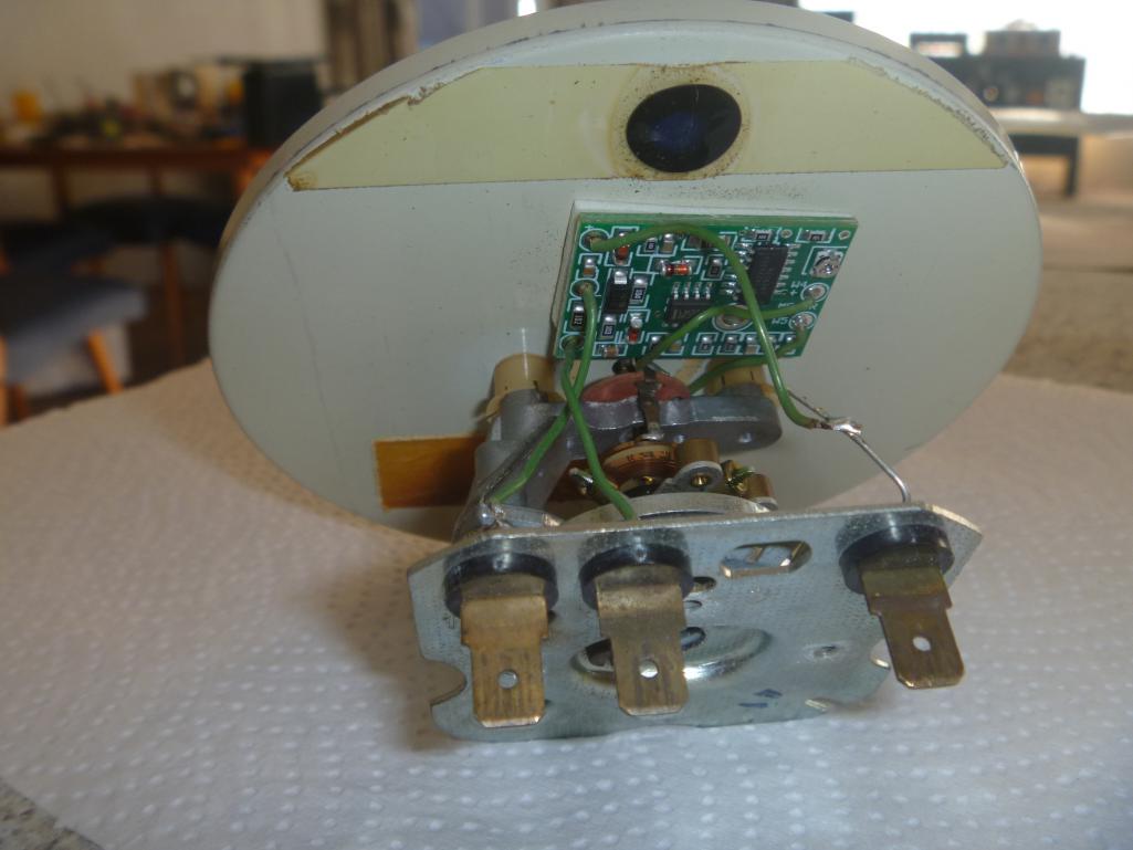

yes that would be a good start ,issue is they are very old with components that are the same ,the 73 911 one in my car went a bit haywire and sent it to guy and he got it stabilized , he said it tests fine ,my replay was "for how long ' his reply was no promises there so I got him to fit the new Ashlock tech driverboard I had sent him ,got back a tach that was absolutely spot on ...end of the day will never have to mess with it anymore, cost me $125NZD for the work and around $35USD plus shipping to import the driverboard .

found a pic of installed board ,any instrument shop can provide this conversion if they can test a tach ,cheers.
