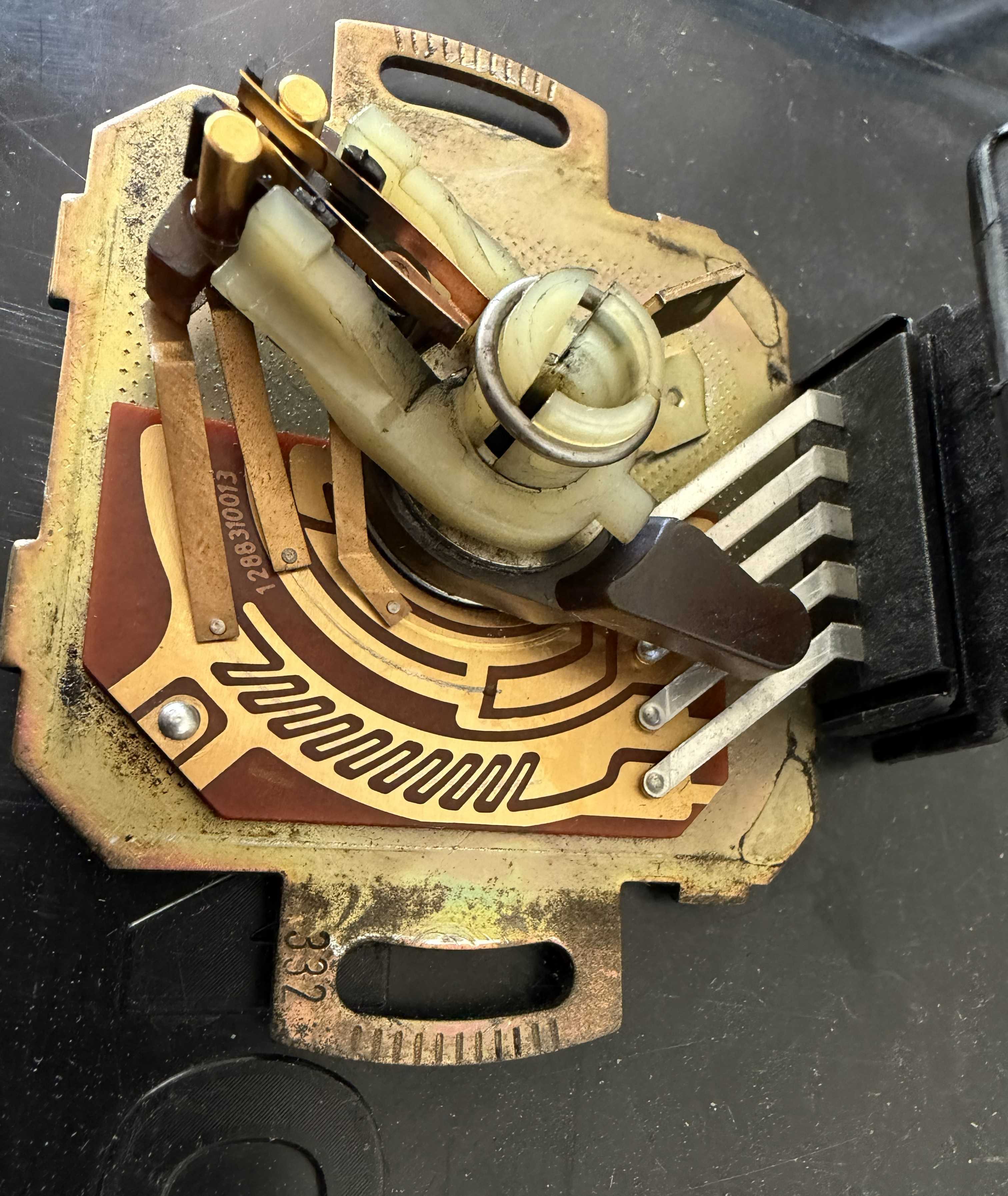

Removed the TPS from the car today, other than a little dirty the traces all look relatively good, a little wear, but no breaks. I cleaned and re-installed it into the car.
Here's what the TPS looks like.
emerygt350
post Mar 20 2026, 05:32 AM
Posts: 3,487
Joined: 20-July 21
From: Upstate, NY
Member No.: 25,740
That looks fine. If the weights move freely and return to position.
My TPS looked just fine but it still did the full miss thing, not saying this is your problem though, just a possibility. If it is the dizzy it will be staggering difficulty if it is the TPS it will be a complete engine wide drop.
