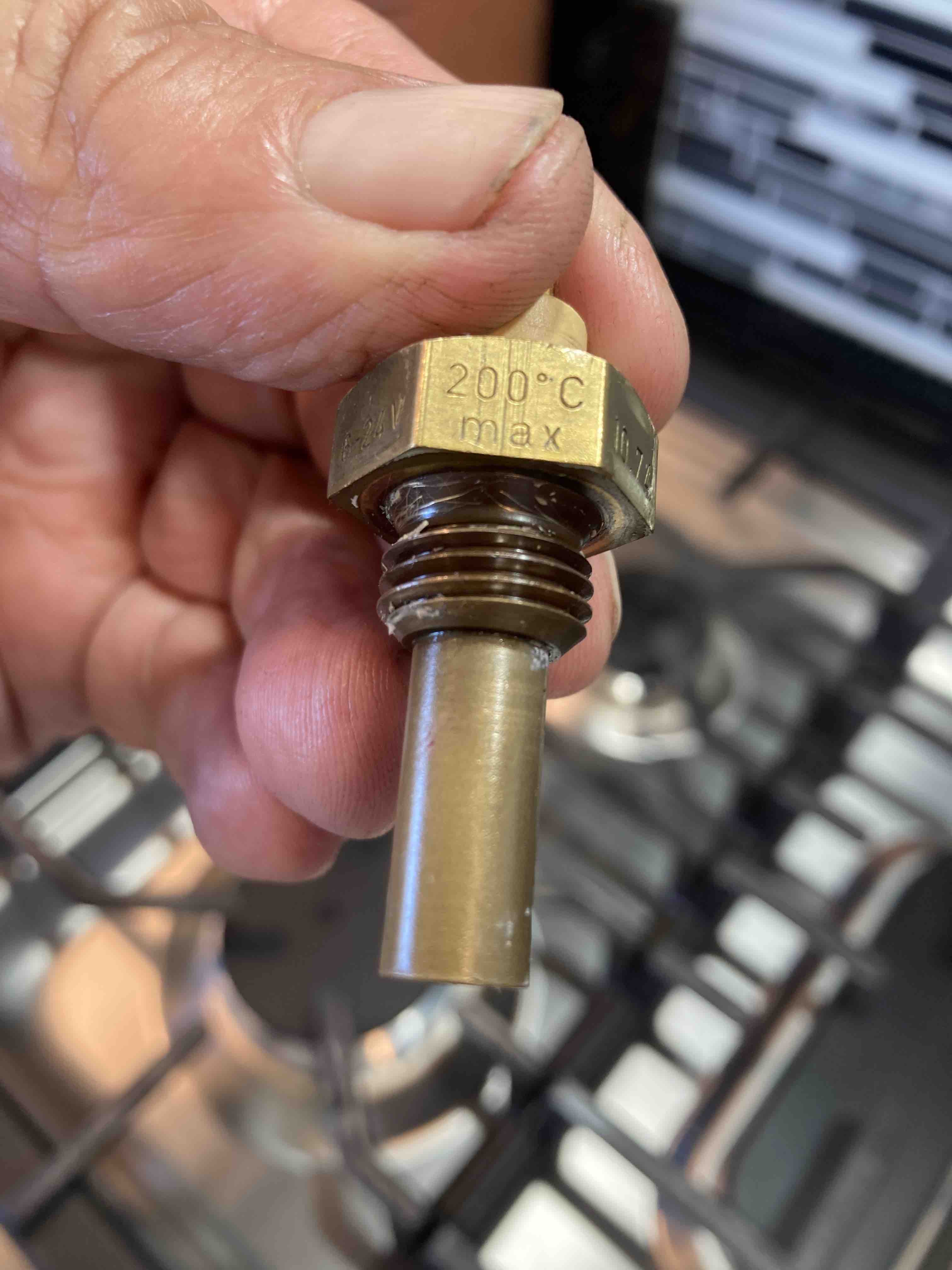

First I checked my oil Temperature sensor to verify type and operation.
It is a VDO 200 C sensor .

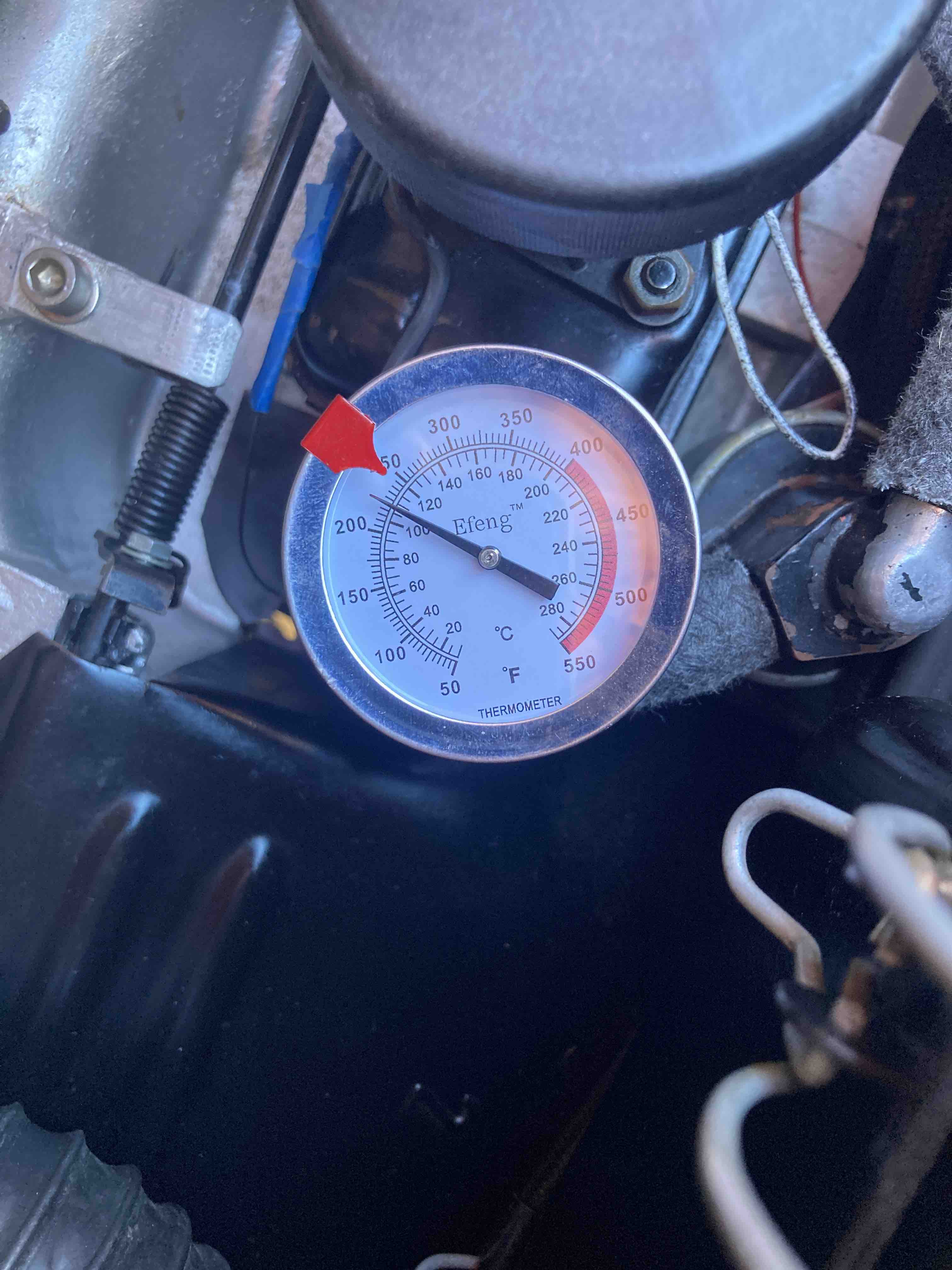

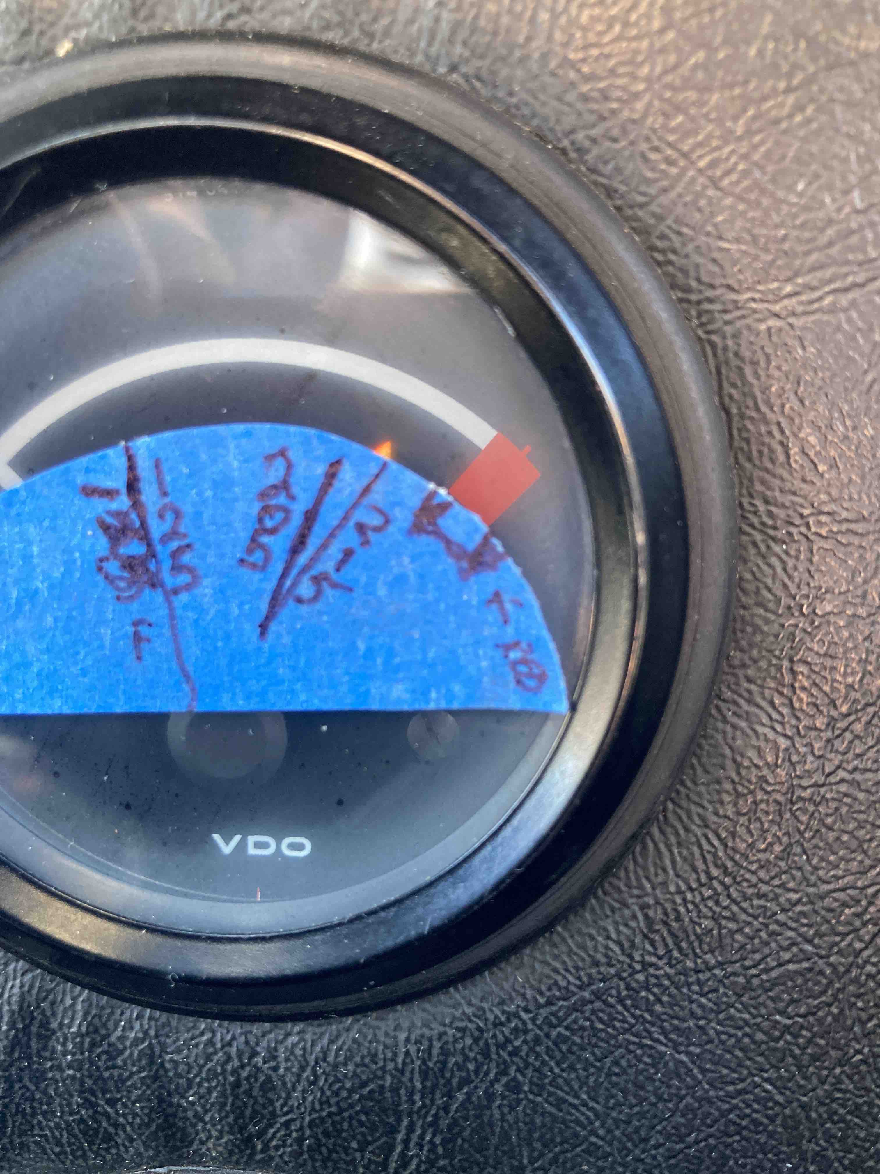

I have the later oil gauge . I removed the sensor and placed it in 212F boiling water and it seems within the correct range on the console gauge .
I am using a Efeng turkey fryer thermometer to check against the gauge in console . The thermometer is accurate . The gauge ( apex seems close to the same reading

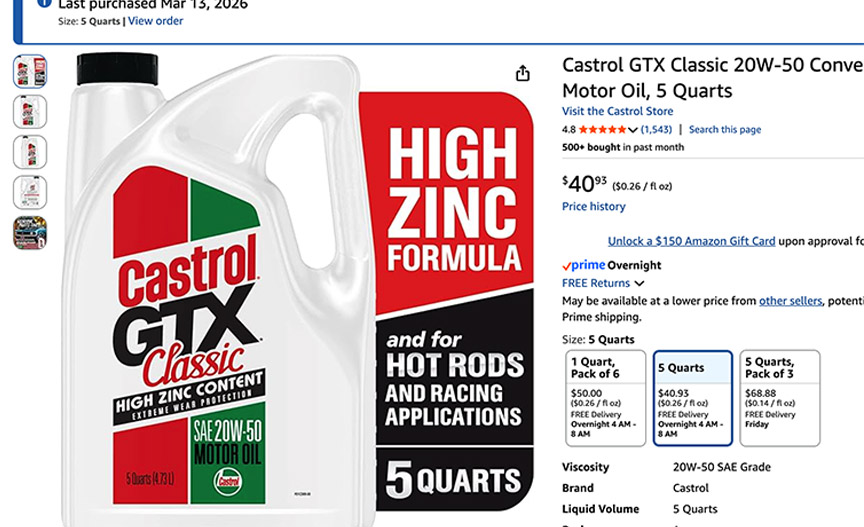

Ron, Happy that you completed your smog. I just got this oil for my 6 and by Bud, Alan Sobin got the same for his 6. We are changing our cars this week
HIGH ZINK FORMULA conventional oil not synthetic. I have been told that this is the stuff. If you have a different word on Synthetic versus conventional, please tell. I have heard of people getting leaks from synthetic oil.
Best Bob B

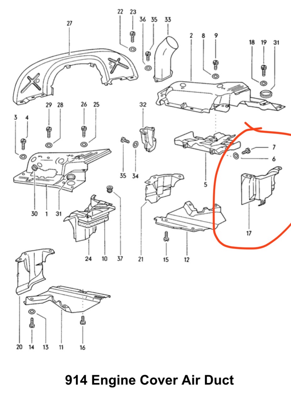

I intend to reinstall that missing piece of tin once I figure out why the shift rod is hitting it .

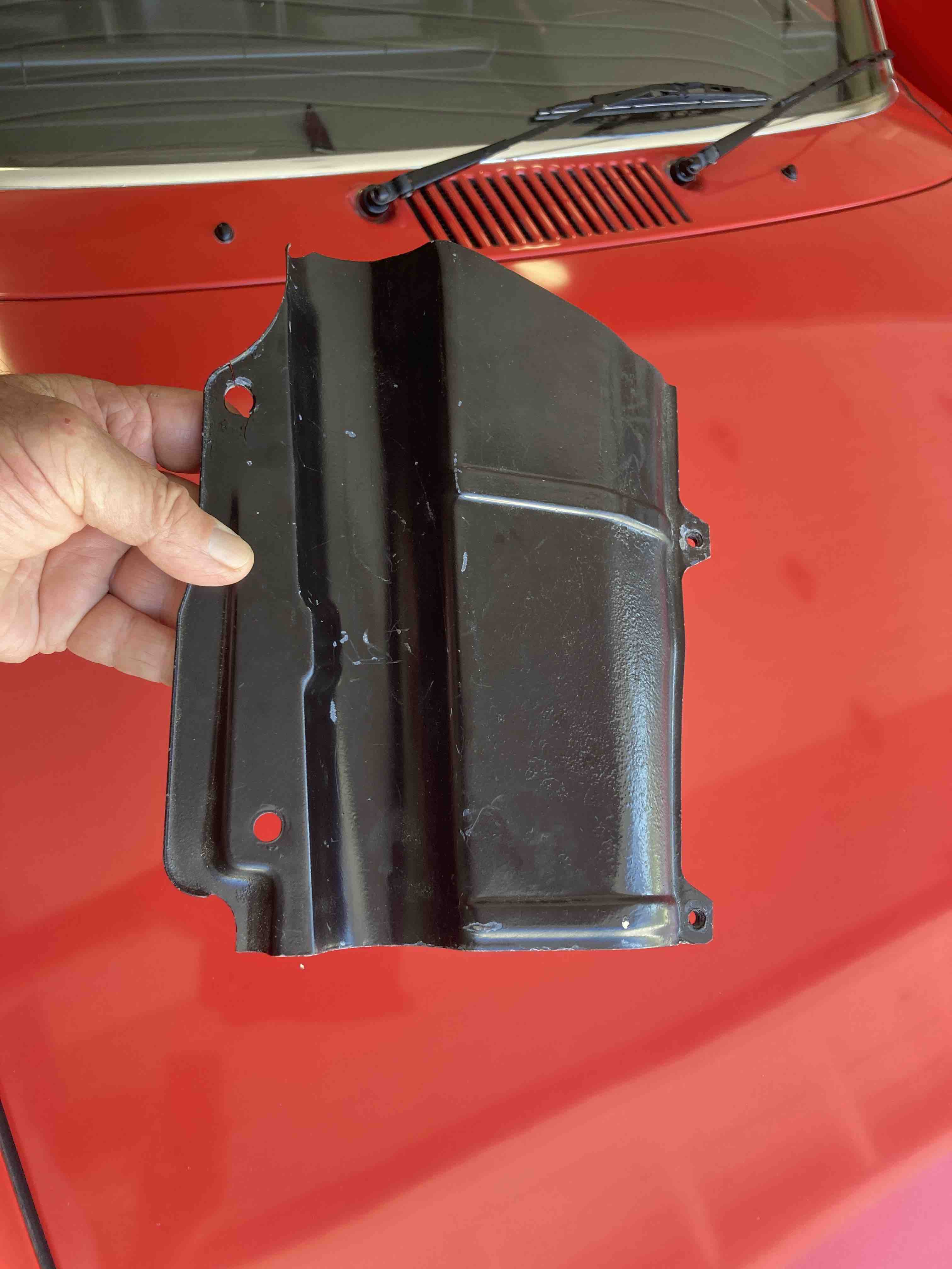

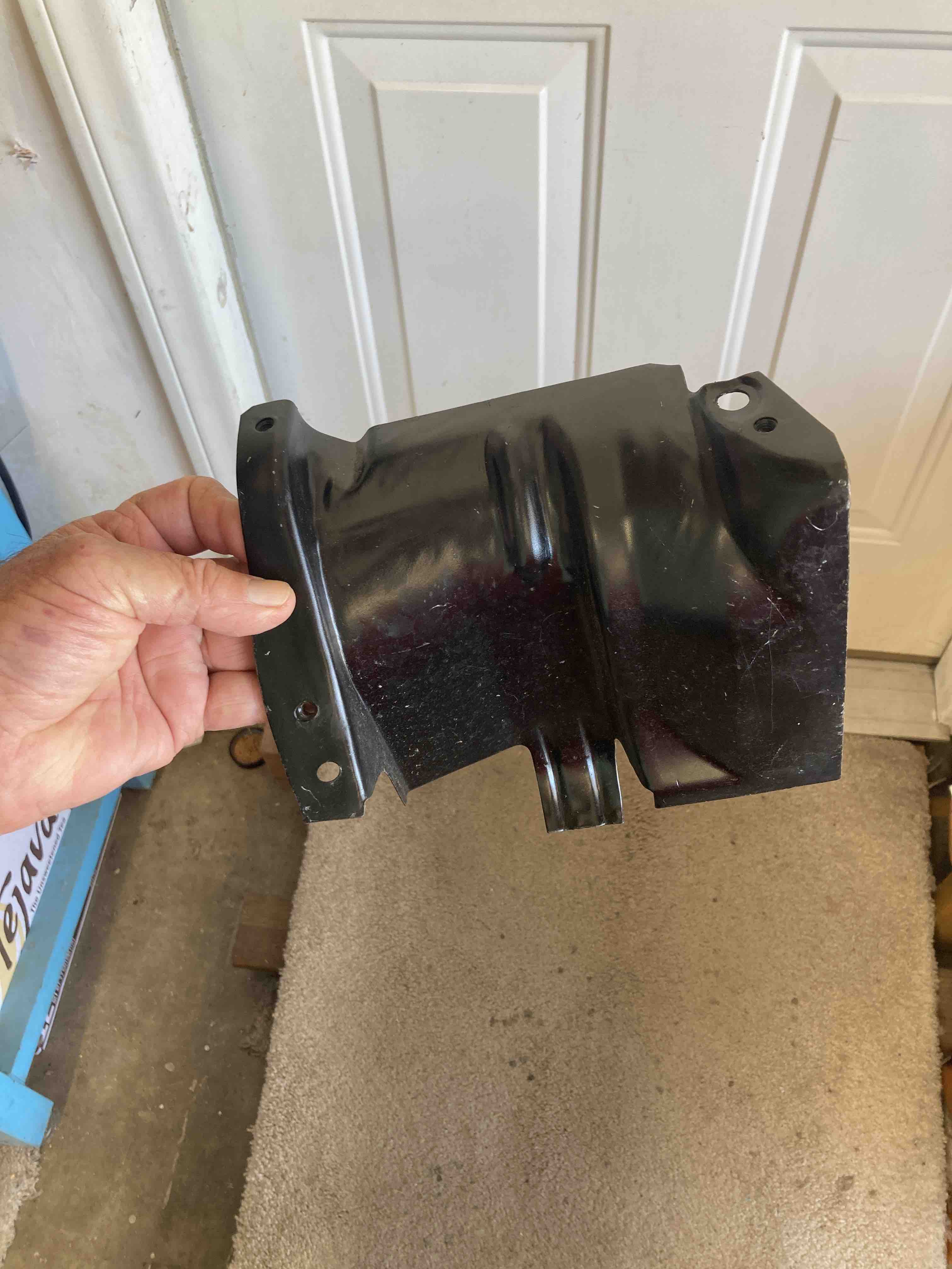

Here is a mystery piece of tin that came in a box of parts that came with my car . Not even sure if it belongs on a 76 914 2.0L.

When I first filled the new motor with oil I used Castol , used to get it at Wallmart for a good price then it became unavailable and they started stocking this oil . Im currently using Vavoline .
My comment on using synthetic oil was prompted by a comment that it handles high oil temps better than Dino oil . I've done 3 oil changes in less than 700 miles since the rebuild .

QUOTE(Ron914 @ Mar 17 2026, 04:56 PM) *
That piece of tin in concerning. Not easy to install with motor in the car.
Wondering is it “extra” or was it left out by an incompetent rebuilder? Tin isn’t optional. Hmm. Can you get photo under car? This is drivers side front of cylinder tin. Attached Image

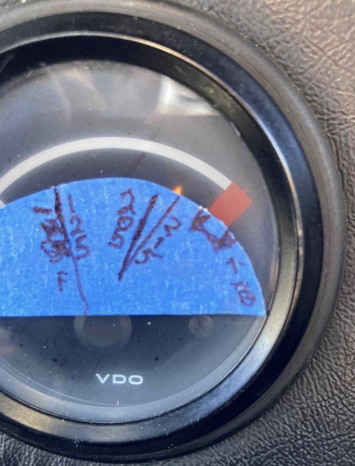

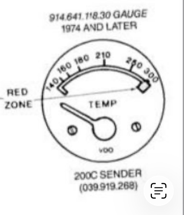

Regarding the calibration of your gage. That doesn’t look right.
212F should be more or less straight up around 12 o’ clock position and not so close to the red zone.
When you calibrated . . . Does that blue tape represent your measured temperature points? Did you calibrate it in car with all wiring included or was it all done in the house? Just curious because those marks on the blue tape would put you into the red not much higher than 215F. Basically your blue tape 215F mark is looking more like what should be 250F or maybe a smidge higher.
Seems like you have the right sender and they don’t usually drift calibration but ??
Is all your engine seals to the tin in place.
When you run for the 45 minutes are you getting to that 250F mark using the dipstick thermometer?

The blue tape is marked wrong the mark should say 225 which corresponds with the position of the gauge . I purchased all new rubber for the engine and some grommets but I see some light coming through the seal around the side of the engine , the seal appears to be pulling away from the DS of engine compartment opening not sure why .
I calibrated the sender in boiling water at the car with ignition turned on and it was close to the blue tape mark around 210 .
When the car gauge hit the bottom of red zone I used the analog thermometer to check 250F .
Based on your post yesterday it sounds like I do not want to exceed 250F or run continuously at that temp.

Complete cooling system (that potential missing duct)
Doubt that shift rod guide will do a difference

Based on you saying your gauge is at 225 position as shown in that photo of the gauge and you saying that you’re at 250F (dipstick) and touching the red zone it does seem like your oil temp gauge is indicating about 25-50F too hot. Weird. Those temp sensors are pretty bullet proof and I’m a little surprised by a 50F offset.
Next time I get a chance I’ll dig a couple of mine out of storage rate and we can compare resistance of them at 212F.
