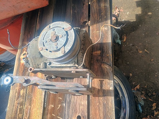

I could use some help with a DPD aftermarket A/C system I bought years ago, but never got around to installing because of my wife's health problems. I live in Texas, so A/C is a necessity during the 8 months of summer here.
I'm looking for pictures of the compressor mounted to the engine and pictures of the mounting bracket. I think I might be missing part of the bracket itself.

Posting a pic of the brackets that you do have, would probably be helpful.

This is the compressor and what's left of the bracket. The rest of it must have gone with whatever car it was on.

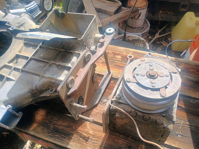

couple shots of what I have,

What would you want for the bracketry and bolts? I live in Rowlett, Texas
