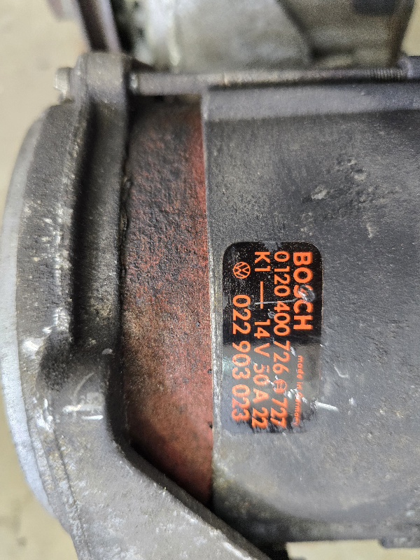

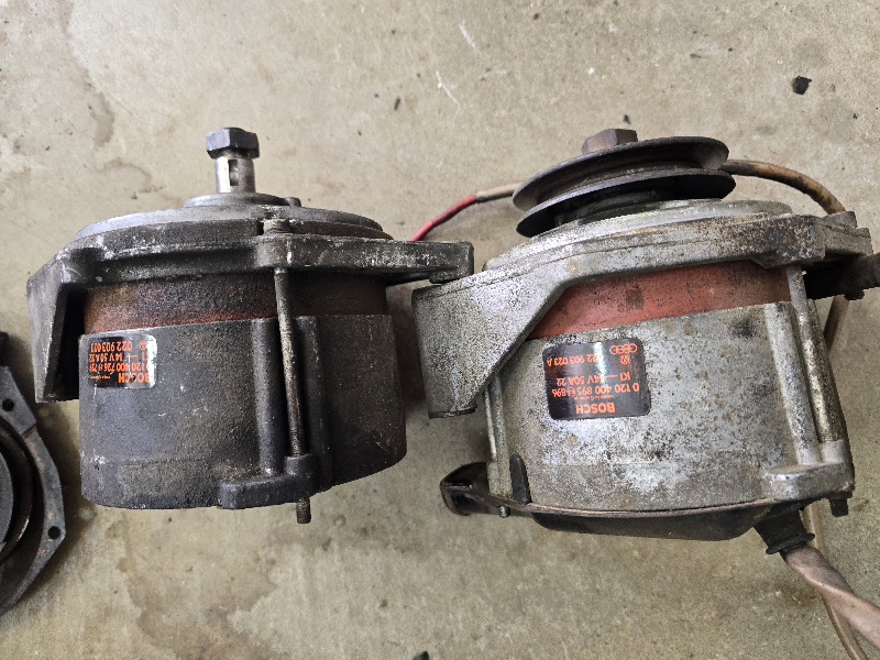

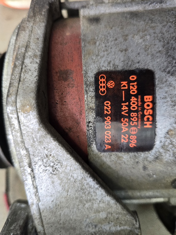

@porschetub - my apologies, I should have been more specific, the two cores I have are no marked *AI75x. They are only marked with what appears to be the original stickers, please see below. Are these rebuilt or original units?
The one with the Audi/VW logo came out of my 80k original miles 1975 1.8. The one with only the VW logo came out of another 1.8 core.
Thanks for all the info!
Ted

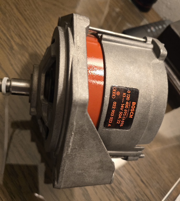

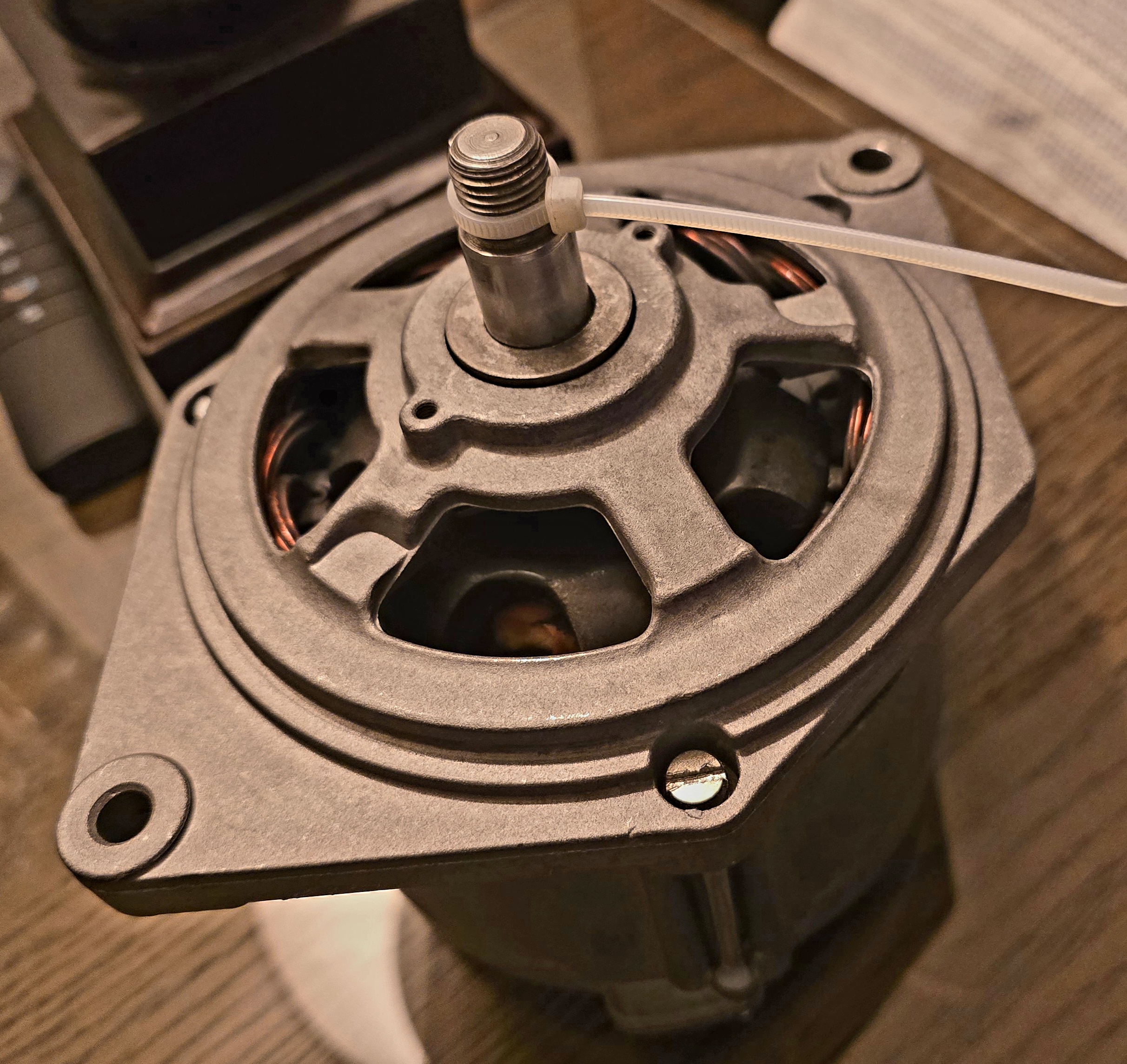

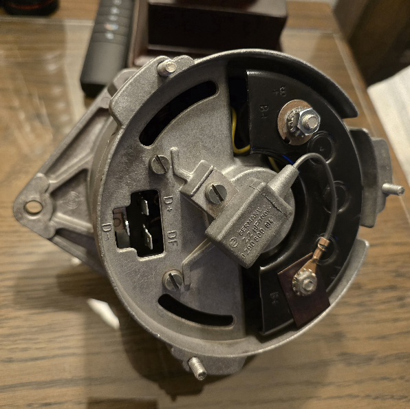

I was able to get one of the original Bosch alternators rebuilt by the shop out in Gilroy, CA. The owner, Steve was great. I dropped one of the cores off a little over a week ago. Steve called me on Monday and said the Alternator was in good working order. I had him go ahead and replace the brushes, bearings, and clean it up anyway. I mean... it was already out! When the motor goes back in it will have a new motor, new trans, new starter, all fresh powder coated tins, new grommets, refreshed FI harness, refreshed injectors, new ignition harness, new alternator harness... may as well get the alternator in good nick while I am at it!
I dont know much about rebuilt alternators, but it looks great and is super smooth/quiet.
The zip tie is keeping the bushing from sliding off and getting lost. Cost for the rebuild was less than 200.00. If this works as expected, I will bring the other core to Steve for the same service.
