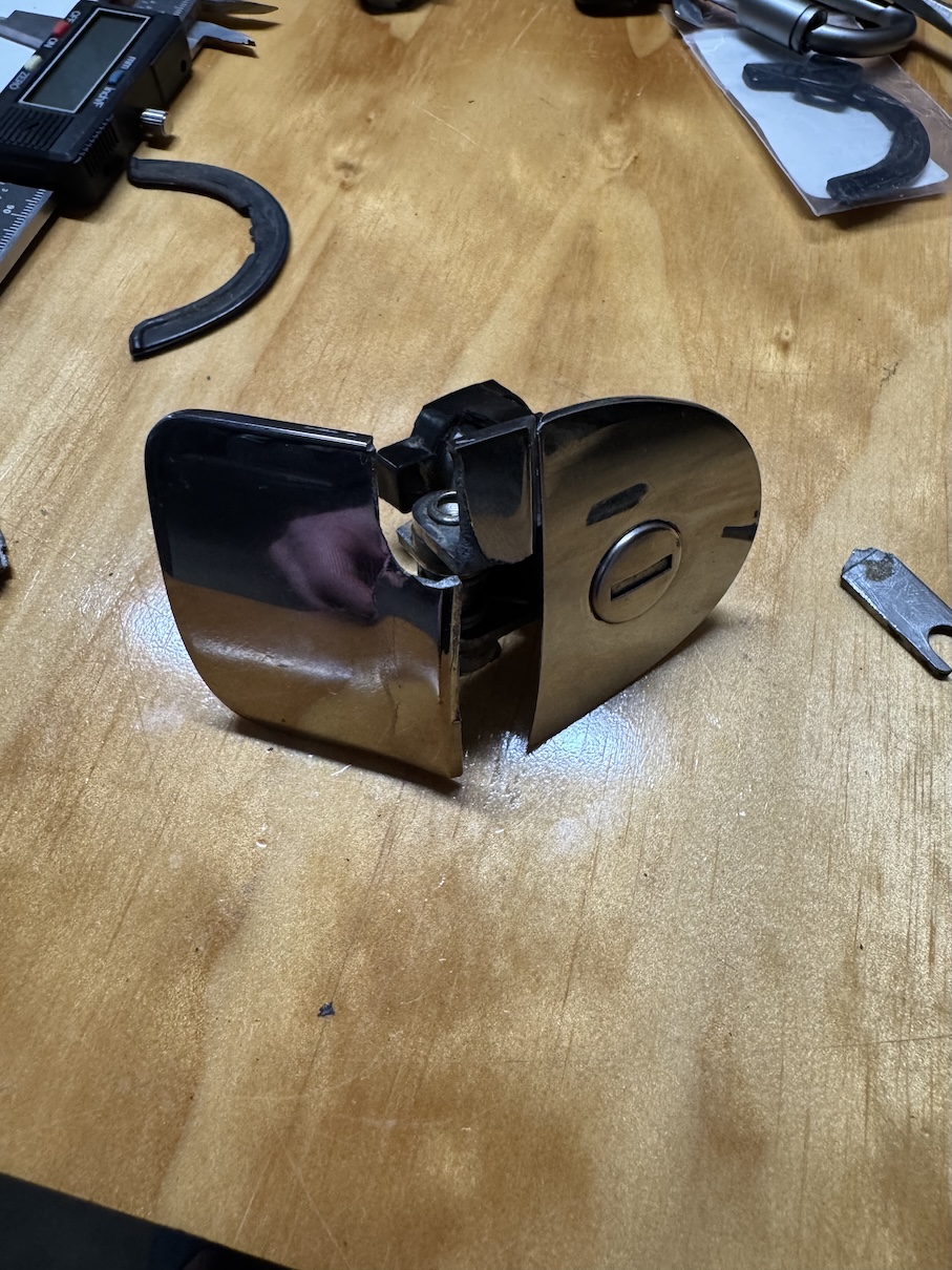

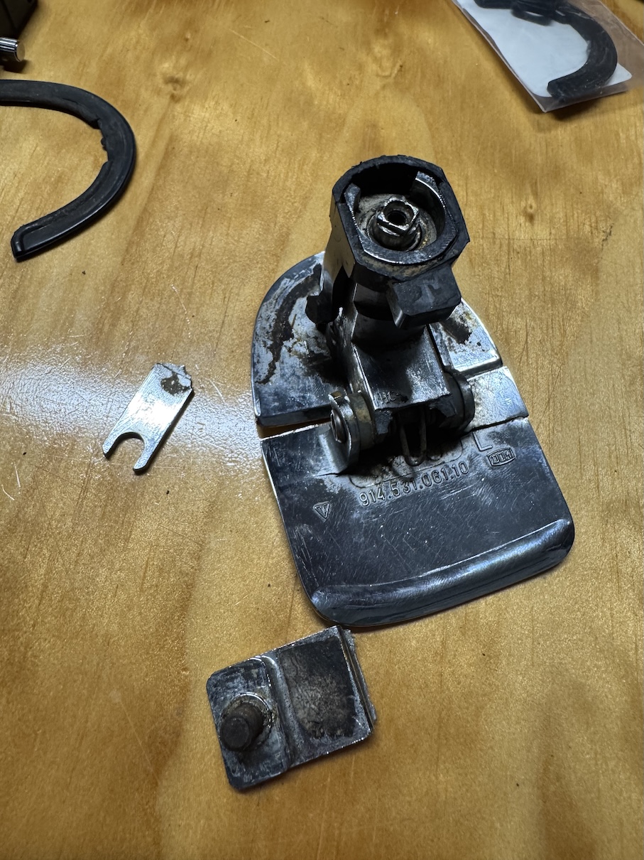

75ninefourteen
post Mar 5 2026, 10:53 PM
Posts: 21
Joined: 3-October 25
From: Austin, TX
Member No.: 29,016
QUOTE(URY914 @ Mar 5 2026, 06:27 PM) *
What do you mean by "shot"? What is wrong with it?
The actual handle is snapped into 2 pieces. And on the back side the mounting bracket and part of the back side have broken off. It was broken when I bought the car and figured it would be an easy part to replace. I will post some pics tomorrow when I get a chance.
Thanks for all the responses and I will reaching out @thecabinetmaker .

75ninefourteen
post Mar 6 2026, 11:37 AM
Posts: 21
From: Austin, TX
Member No.: 29,016
This is why I need a new handle.
