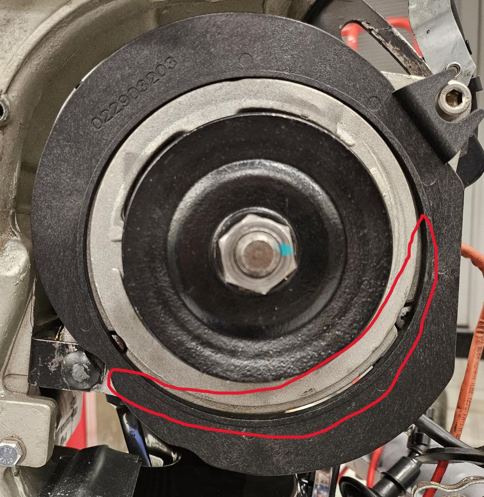

Just a quick follow-up here to provide feedback on the aftermarket later-style seal I purchased from Cip1. The new seal arrived today, and the test fit did not go so well.
As you can see in the photo, the diameter of the opening that fits around the ring-step in the alternator is too large, and leaves a large gap. The photo I posted earlier of the OEM seal has a much closer fit.
At this point, I may simply use the earlier tin I purchased (also arrived today) as it seems to provide a better fit for the 50 Amp alternator anyway, and return the aftermarket seal.
914werke
post Feb 19 2026, 08:14 AM
Posts: 11,576
Joined: 22-March 03
From: USofA
Member No.: 453
That's disappointing.
