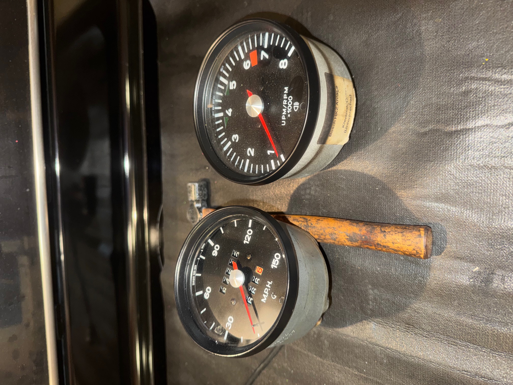

post Feb 11 2026, 10:00 AM
Posts: 3,255
I can share something that did work out, the needle ended up darker but the bezel pieces came out great with this paint. Here is a pic of the speedo I did and the tach that came restored.
