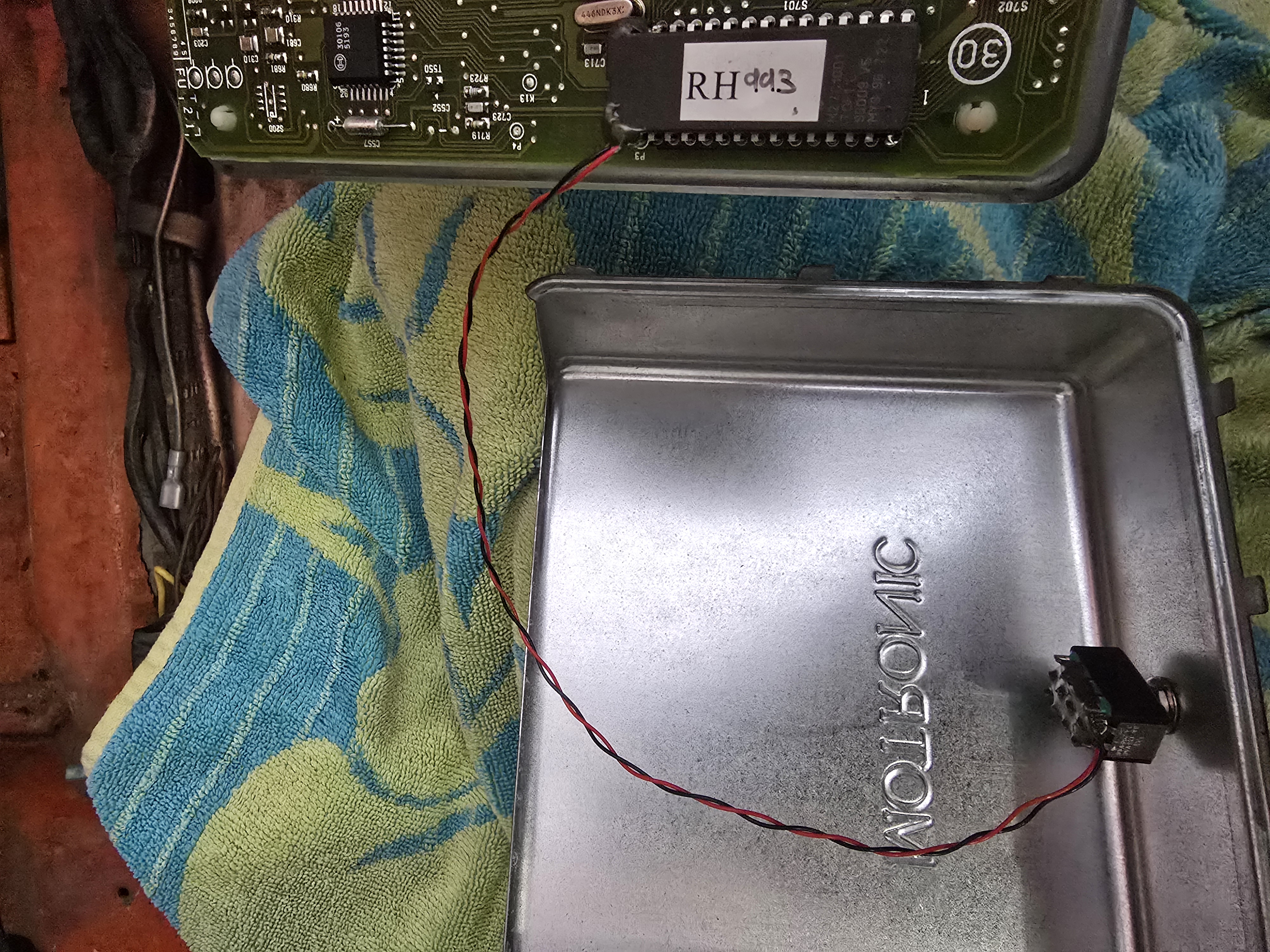

Thunderchief
post Jan 25 2026, 11:11 AM
Posts: 195
Joined: 12-August 19
From: Pasadena, CA.
Member No.: 23,365
Here is is from the inside. Again its a 3 position switch so I'm wondering what the positions are for. Thanks everyone!Attached Image
post Jan 25 2026, 11:42 AM
Posts: 7,652
Flick it - what happens?
3 position irrelevant - only two wires so it’s acting as on/off.
post Jan 25 2026, 11:57 AM
Posts: 20,362
Send a pic to pcarsba@gmail.com
Ingo Schmidt repairs motronic ecu’s and knows them inside out. Super nice guy. I’ve had about 10 ecu repaired by him. Some that steve Wong told me were toast.
Thunderchief
post Jan 25 2026, 11:59 AM
Posts: 195
From: Pasadena, CA.
Member No.: 23,365
Thanks. It does have an aftermarket chip if that makes a difference
post Jan 26 2026, 10:11 AM
Michael
Posts: 10,562
From: Auburn, CA
Member No.: 9,712
I agree with Tomeric914; likely a kill switch. (IMG:style_emoticons/default/beerchug.gif)
