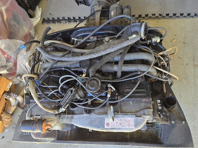

This escalated quickly! 1.8 is out, getting ready ready for the 2056 to go in.
I will start to clean up the engine bay and the underside of the car to prep for the new motor.]

I hope I can get the new one back in! It's still being built, but the new 2.0 AMC heads arrived on Wednesday, they are beautiful. I picked up my tins from the powder coat shop on Friday.
It's official happening.

I'm pretty sure we have a thread somewhere about engine tin markings. Would be nice to get yours documented.
(IMG:style_emoticons/default/idea.gif)

Haa! Yeah, it was hard to see through all the tears in my eyes. (IMG:style_emoticons/default/biggrin.gif)
I hope I can get it back in properly! Im used to basic VW aircooled and gen 1 small block Chevrolet motors. There are more wires and hoses here... I don't know what the heck Im looking at?!
My plan is to use the existing motor as my blueprint for reassemble. (IMG:style_emoticons/default/biggrin.gif)
I was looking at the wiring harness and it looks like someone modified it for something different than stock. There is a dual relay attached to it which has also been modified. I may send the harness out and have it fixed properly. What's the name of the FI harness guru?

we got all the engine label and markings info from @TRP when he first got hold of the car.
@TRP - your dual relay (black plastic) is just the replacement type that superceded the original metal ones. standard mod would have been done to allow for wiring it in.
my car is the same - i had it done back in 1989 when i first got the car. even then the metal can dual relay had been superceded. (IMG:style_emoticons/default/beerchug.gif)
