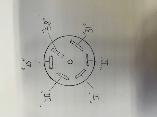

> 911 Fog Light Switch for Front & Rear lights, Need help wiring…See my labeled diagram
post Jan 13 2026, 12:57 PM
Posts: 9,990
I have the dual fog light switch for front and rear fog lights.
Part # 911.613.147.00
How does it get wired ?

I searched for that p/n for a schematic of it or a layout or pinout. Didn't find much. Maybe the schematic from the vehicle this was used in?
JeffBowlsby
post Jan 13 2026, 11:31 PM
Posts: 9,163
From: San Ramon CA
Member No.: 104
Easiest to simply check true continuity of each of the connecting poles (circuits) relative to each position of the switch. Ohmmeter with a buzzer is the tool of choice.
post Jan 16 2026, 02:19 PM
Posts: 9,990
So far I have:
31 = ground
15 = keyed battery power
58 = light (s)
Still search to learn about I, I, III

QUOTE(jim_hoyland @ Jan 16 2026, 03:19 PM) *
So far I have:
31 = ground
58 = light (s)
Do you have a multimeter? Set to ohms and put one lead on the 15 post. Then pull out the switch and see what opens at each setting.
58 and 31 should just for the switch's backlight.
Every fog light switches I've seen will turn on the front fogs on the first click, then the front and rear on the second, but you'll have to verify this one yourself. I can't guess what position 3 would be for.
post Jan 16 2026, 05:20 PM
Posts: 9,990
So far: Switch on: I connected 31 and I with a 9v battery; that turned on the orange switch light when switch is pulled out.

post Jan 17 2026, 01:48 PM
Posts: 9,990
The Fog light switch has two positions; one for turning on the front fog lamps and a second position for a rear fog lamp. Unlike the 914 fog lamp switch, this 911 switch has two on positions: pulled out and pulled out and twisted to the left
Today I tested connectivity between 15 and I, II, III
Results: switch pulled- continuity between 15 and I and III
Switch pulled- continuity between I, and II
