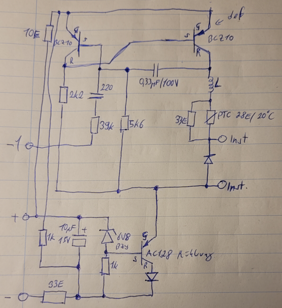

My tachometer of my 914-6 wasn't working. I decided to repair it by my own.
I don't like to explain how to open ore how to remove the needle, this can already be found in other threads. I just like to share the circuit diagram and how I found the defect device (transistor).

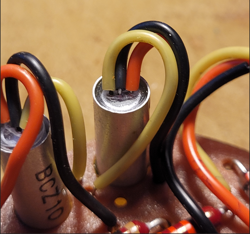

3 Transistors are used in the device, 2 of them(BCZ10) are used for a monostable multivibrator. The very smal input puls from termial "-1" is used to trigger the monostable multvibrator. The smal puls time is extended and goes to terminal "Inst" (instrument). Transistor 3 (AC128) is used for voltage regulation.
I added the circuit diagram I made. The wires for the Transistors are colored (R=red, G=green, S=black). Without any test bench and oscilloscope the simpliest way is to check the transistors via multimeter. I disconnected the base of the tranistor and measured the break voltages beteween base-emitter and base-collector. for BCZ10 the break voltage is arround 0,6V and for AC128 arround 0,2V (germanium).
In my case on Transistor (BCZ10) was broken. I replaced both BCZ10 with BC177B which is still available.
This solved the issue, tachometer is working again!
