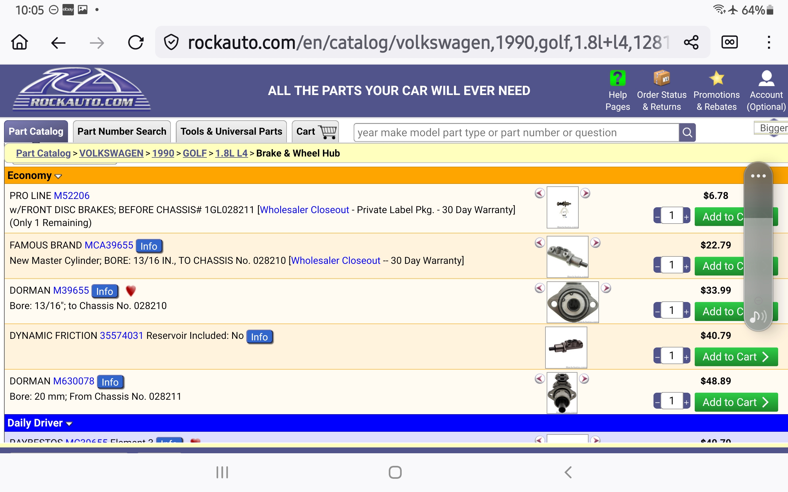

If you want a new 20mm master cylinder (currently as low as $6.78), maybe one of these in the photo? Not 100% sure this works, but have just ordered one to see.
It will require rebending a couple brake lines, as documented here:
http://www.914world.com/bbs2/index.php?sho...p;#entry2500996

Thanks for the heads up guys!
A modern solution at the size I wanted.
Even real ATE stuff is still available!
SKU ATE-010532
