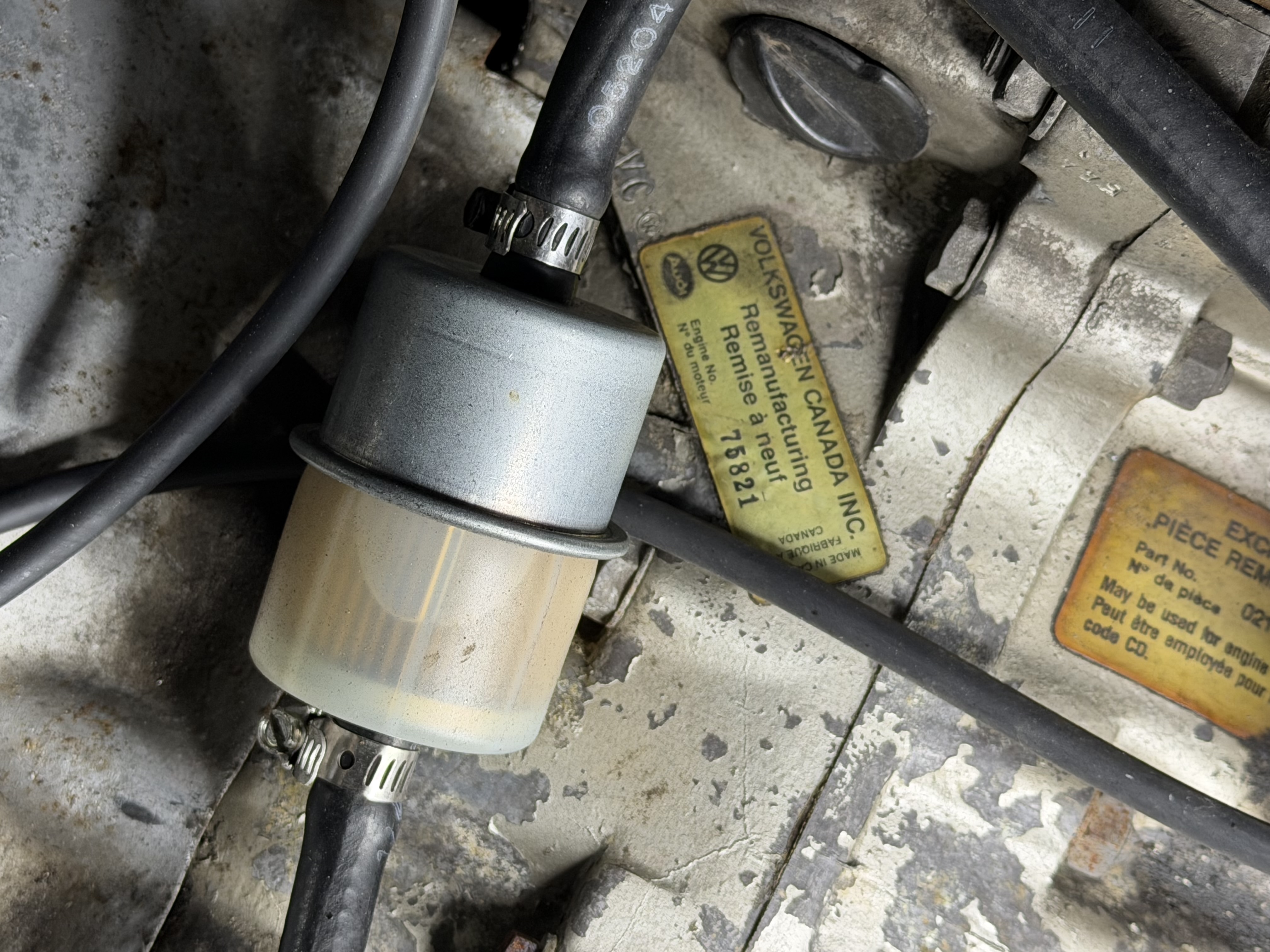

QUOTE(PapaNorse @ Dec 29 2025, 03:08 AM) *
VC75821 Thank you for your thoughts on this.. Super appreciated
Can't find that number. Post a photo of it please.

@PapaNorse
Still curious.
What number did you find on the case that led you to conclude this is a 1.8?
Did you find a dipstick tube between the engine fan and the alternator?

I found the Engine ID! AT006873 Looks like a 1.7.
Jack Standz
post Dec 29 2025, 01:55 PM
Posts: 648
Joined: 15-November 19
Member No.: 23,644
https://www.thesamba.com/vw/archives/info/engine_letters.php
Looks like: 1974 1.8 liter European only dual carb
And that sticker says it was a remanufactured motor from Canada, so an oddball for a US 914
